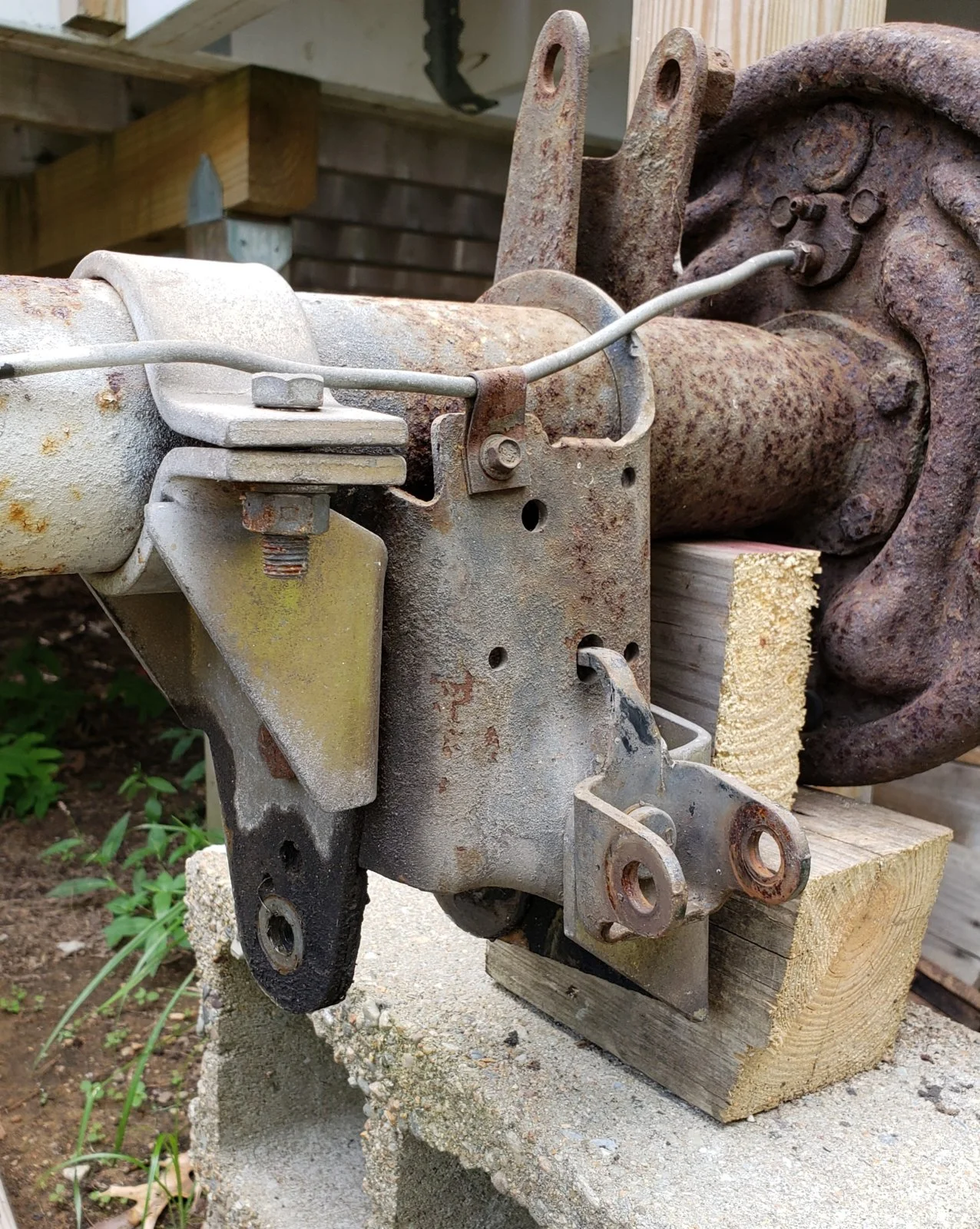

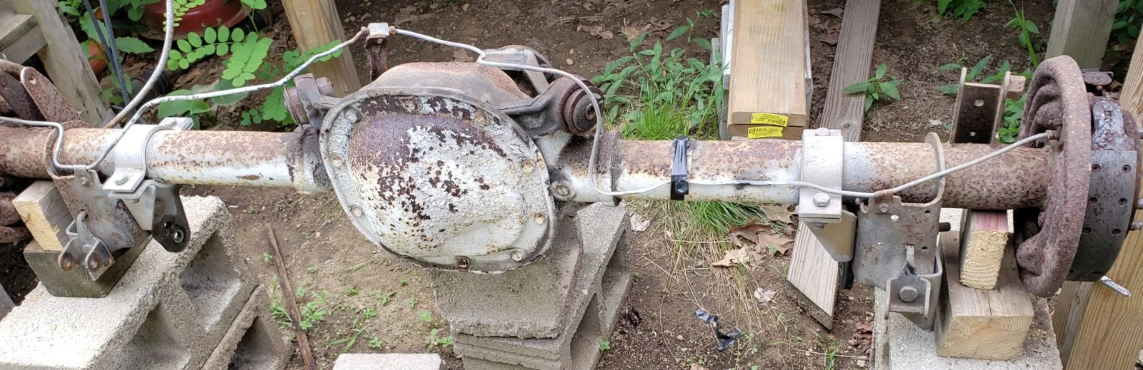

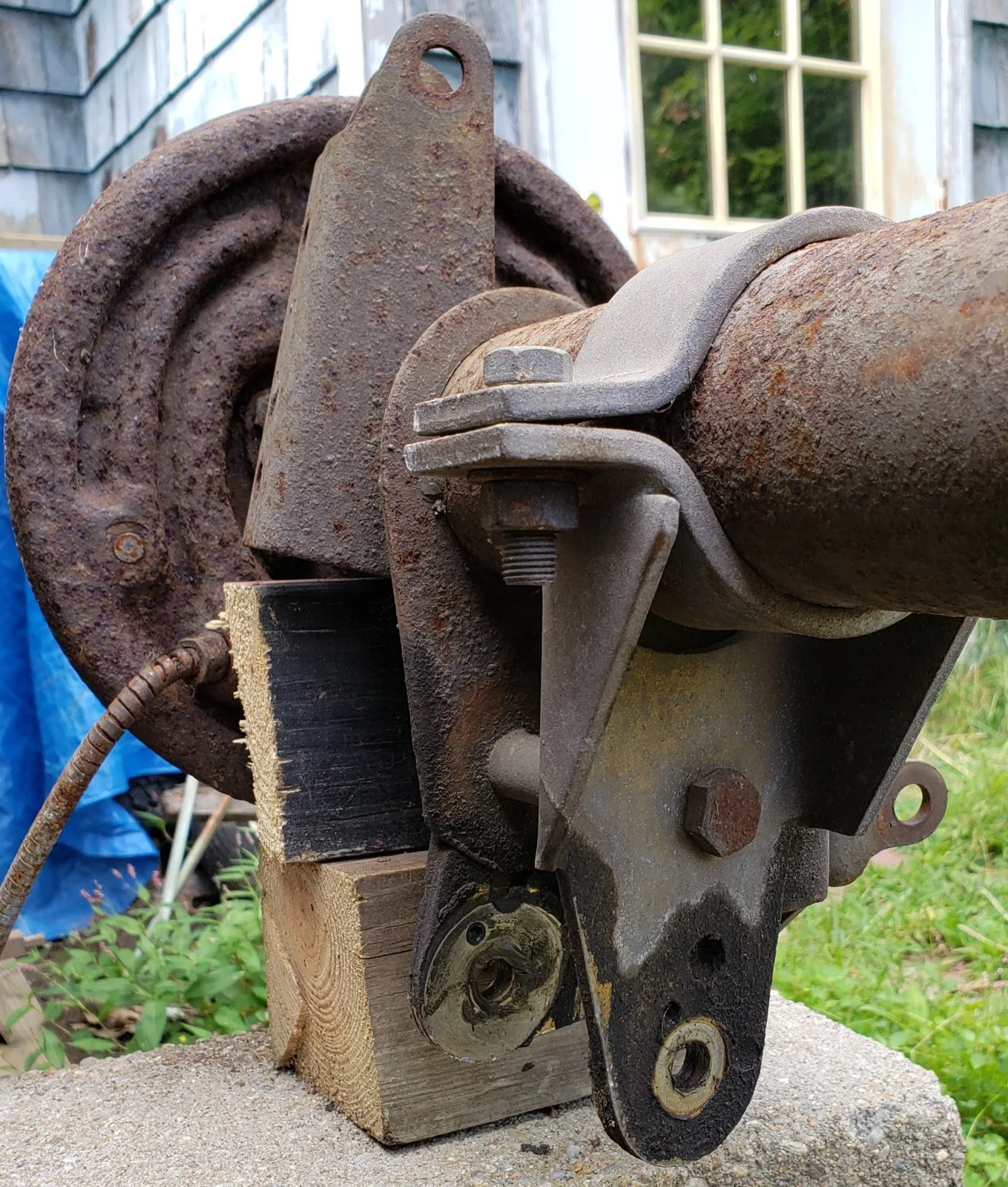

Good Afternoon folks. 5L5, thank you for the information, sorry that my response is so delayed. That being said I've had a few minutes to take a look at the Axle and noticed some "extra" brackets, which I'm including pictures of. Since I'm not planning on upgrading the rear suspension, other than when I swap the rear out putting in new bushings and hardware. But rather than rip and toss I'm wondering if anyone knows what these might be for and whether I should keep, donate or toss. Let me know what folks think. If I need more pics I can do that.

I dunno, but looks to me like some kind of aftermarket lower control arm relocation kit or something. Factory would never have a control arm bracket bolted on, looks to me like the cross bolt goes thru the factory control arm mounting holes. Since this is an extra rear, compare it with what is in the car now, and if it's some kind of add on, just take it off and chuck it.
