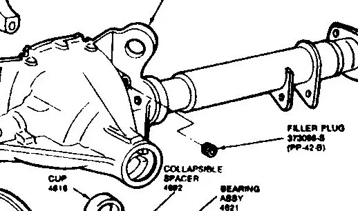

looking at the front of the axle housing where the driveshaft bolts look to the right side of the housing above axle there is a filler plug there that you can remove with a 3/8 inch ratchet and extension the extension square end will fit into the end of the plug attach ratchet and remove
heres a picture
