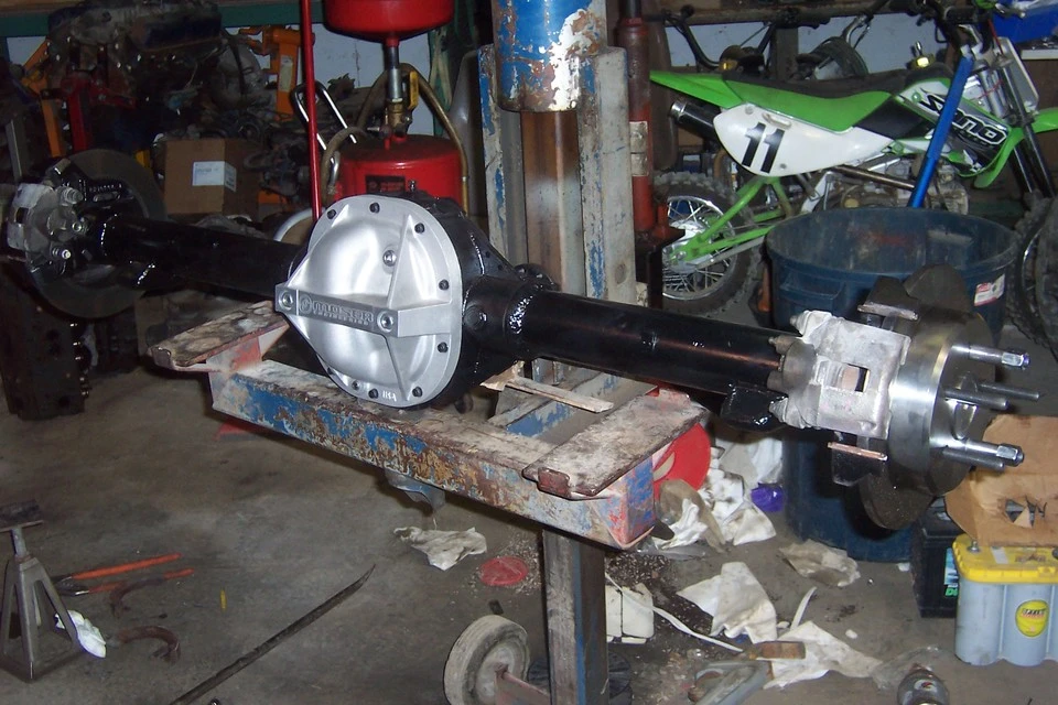

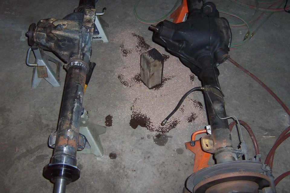

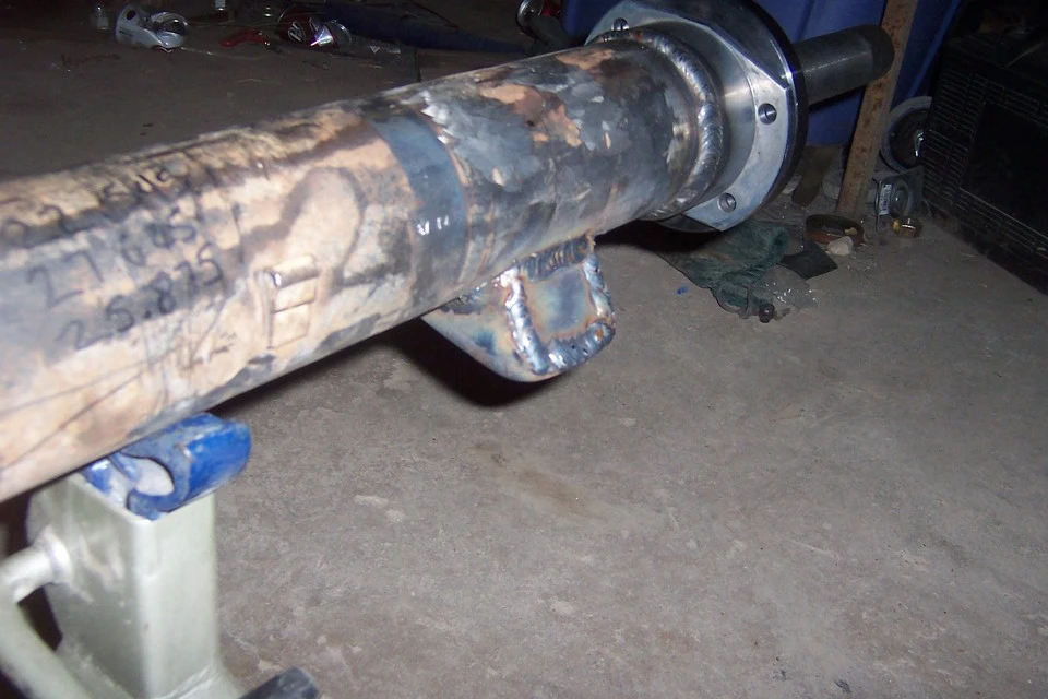

I had a fox in my car and before I got it running I was given an sn95. The axles and brakes are the only difference. The sn95 is also 1.5" longer overall. I ran mine for about 3 years with street tires, slicks and drag radials with out trouble running high 6's in the eighth. 94-04 wheels work without spacers or 15x8, 5.5" bs. Fox stuff is nearly identical to stock 67-70 length. I have an F150 8.8 in it now with 9" ends, Explorer brakes and 35 spline axles. I am still running the flange and like it. I never liked the strap on u-joints. 8.8s are tough, easy to find, easy gear changes and cheap. I had less than $200 in my sn95 and about $1100 in my F150.
SN95 on the right
Boxed perches

that F150 axle looks like it's built to destroy the pavement!
