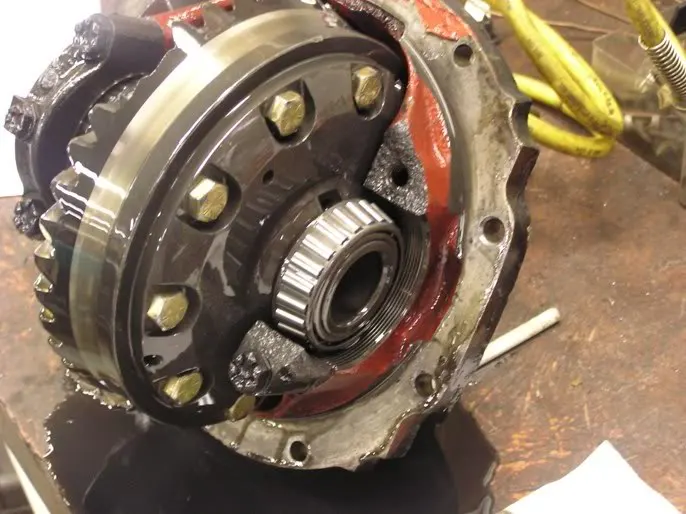

A friend of mine just blew up his 8" last week. 3300lb car, ~375hp, 5 spd, 235 drag radials.
