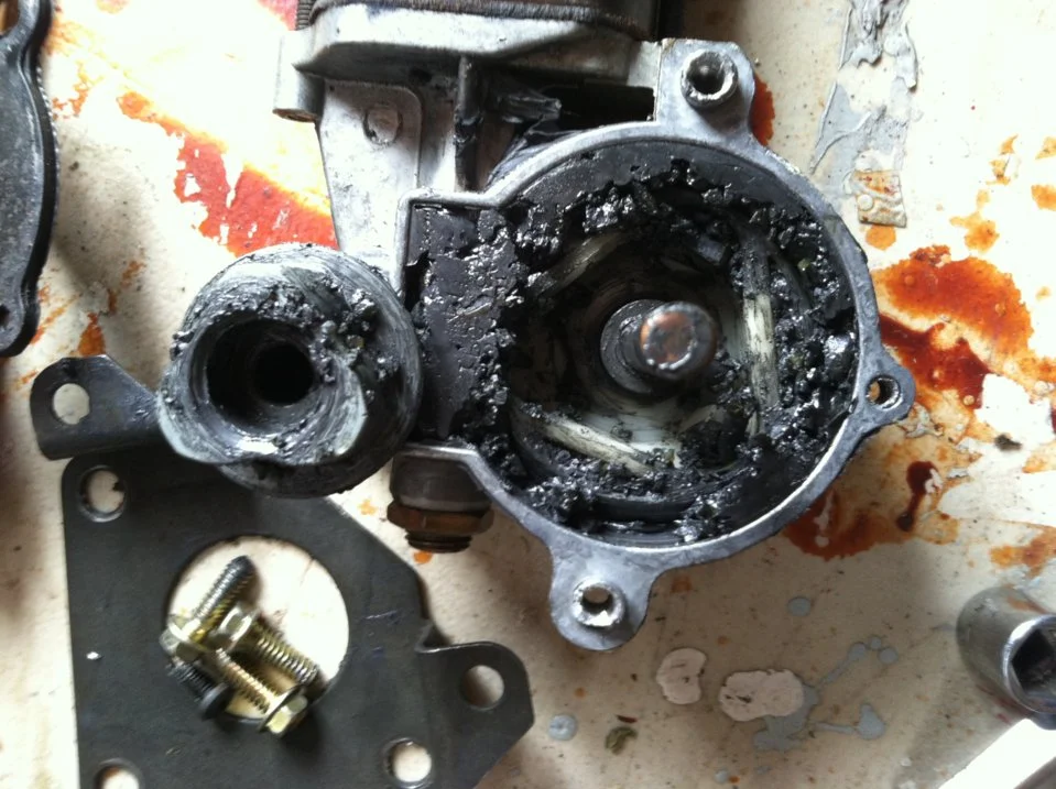

Now my passenger side window won't budge. It's getting power. I hear it's draw from switches anda click from for ppanel
Most likely culprit is the plastic drive gear on the motor. The rubberish drive bushings disintegrate over time. Heres mine from the rear quarter on my vert vThere should be 3 pencil size bushing in grease there, not that mess ... new dorman bushing are like a buck at the parts store.

I'll check that out when I get the chance to. I tapped on the door panel in the general area of the motor and played with the switch and got it up. The motor has been weak for awhile. But the bushings around the guide in the middle and the guides on the sides are gone.. I did find the main ground to firewall strap unhooked. Don't remember taking that off though but hoping that will help since it's been weird. Lol

That's probly what it is though. Since everything else is disintigrating

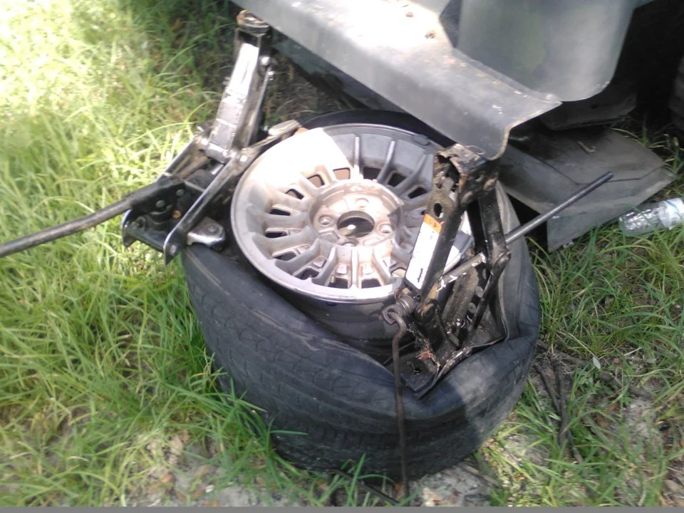

It's time for an update on this never ending project.. I'll keep it short this time.. The gas tank decided to pick up a hole in the bottom of the tank. Went and got a nice looking 96 v6 tank from the local junkyard. With some 'modifications' id able to make it work, with some longer bolts I was even able to use that plastic guard under it. Got it running again so decided to get more then a gallon in this empty tank. Got halfway to the gas station and it died. Was able to coast almost the rest of the way. Pushed it the rest of the way to the pump thinking I was out. Total distance half a mile from home. Put gas in to find that wasn't the problem.

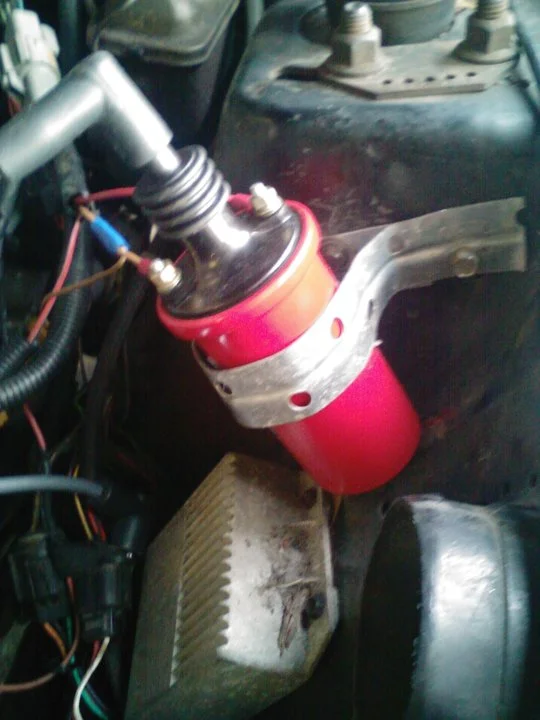

Ended up messing with it for 2 hours before calling tow truck. Ended up not getting spark. Found it was the coil. So upgraded to a msd blaster 3. Had to make a temporary mount until I can get a real one. But is running good now aside from its still overheating. I'm going to get some flush tomorrow and flush it I think. May be time for a upgraded radiator and belt driven paddle fan

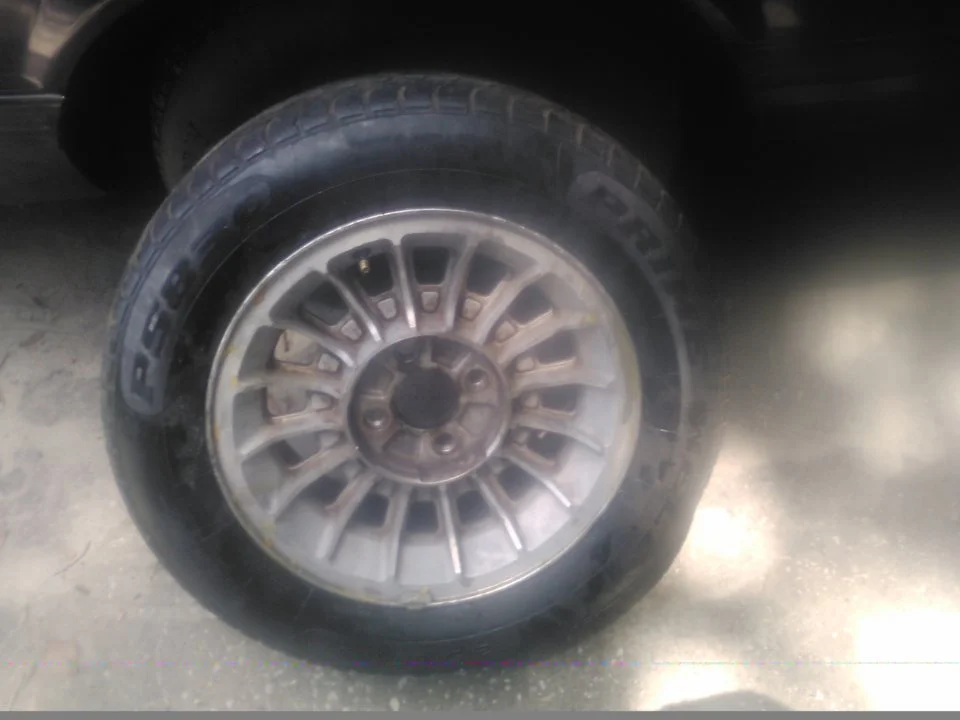

Oh and have pictures of this project. Picked up a matching tire from the junkyard. Just a hair smaller by less then a centimeter. Popped it on the wheel today. No more doughnut finally... And found a good use of a dodge in the process Lol. Thats the bumper in the pics.. Apparently I have a pic of the msd with my makeshift mount. Will last a couple weeks at least
