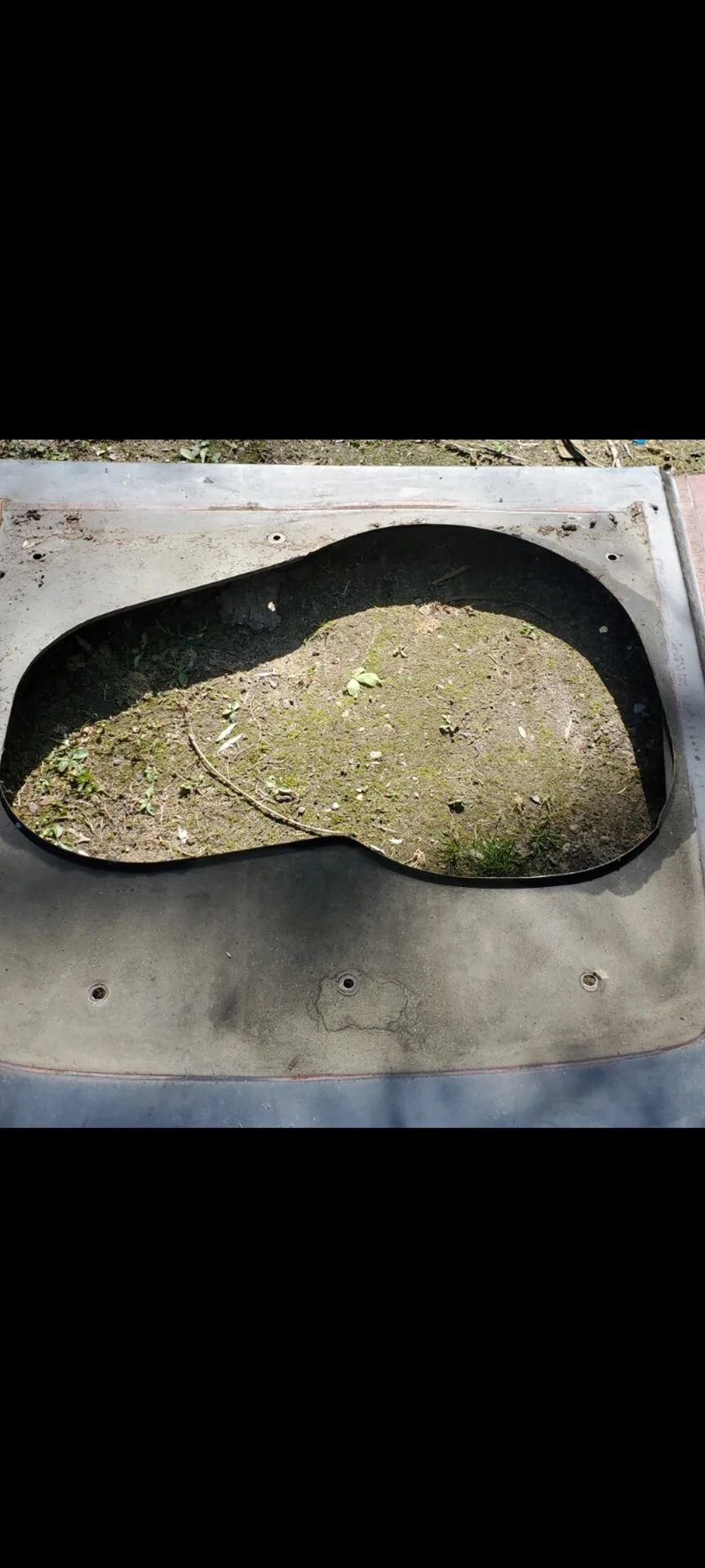

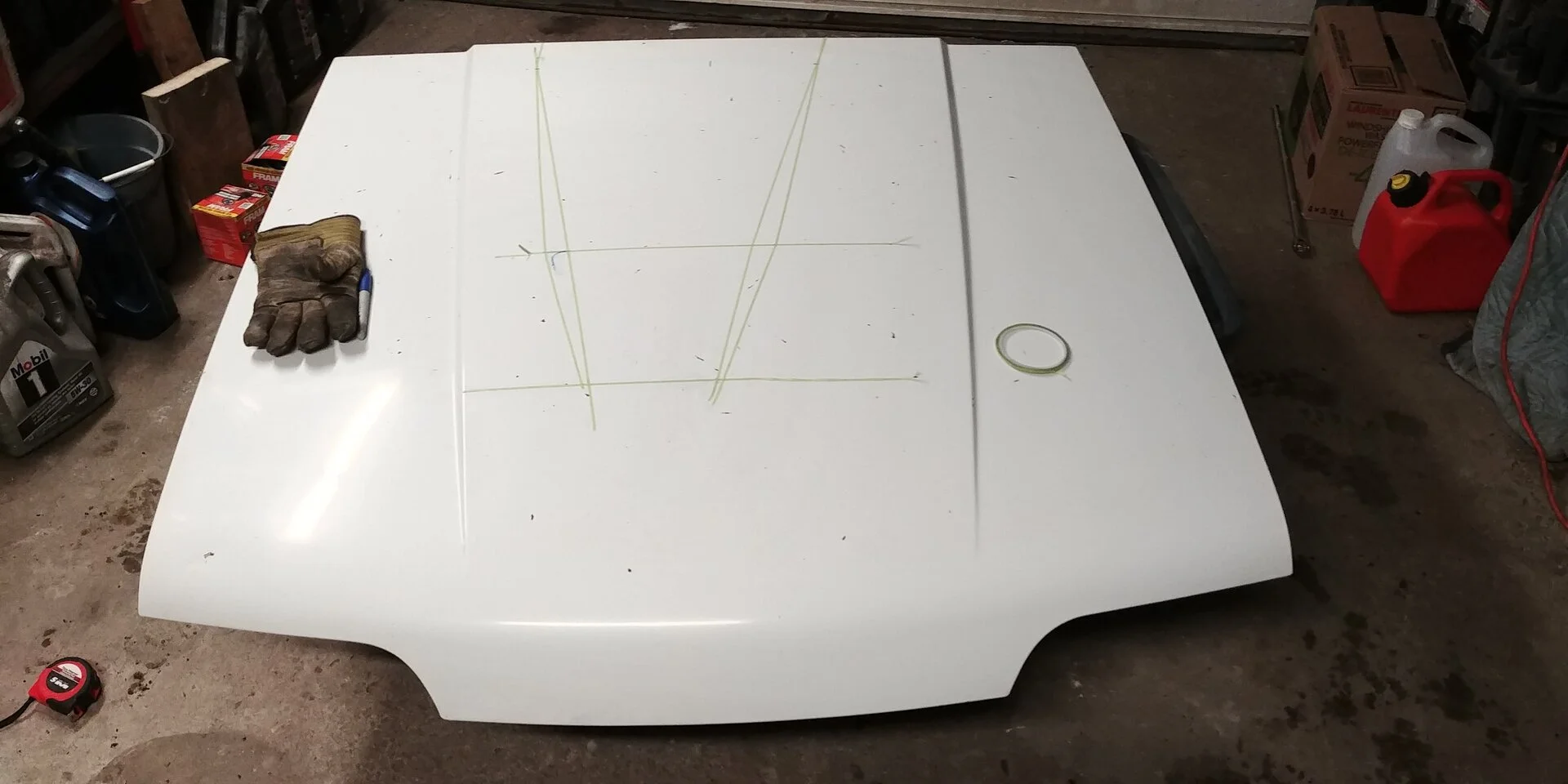

I was only doing it to let heat out I haven't done it yet my hood is junk the glue is melting off the brace in the middle I wasnt going cut a huge hole just in the middle of the brace I loved the look on the hood it was on

If you want to cover the entire scoop,you'll have to cut out part of the brace. You can do it however you want really. Curious,do you have the little grille for the back of the scoop?
na the grille is gone they had it backwards taking in air to the carburetor that was the hood I took it off I don't want the hole that big I made a template also to see where i would need to cut to let heat out I found 1 video about it but it was on a 86 mines a 91

Do yourself and all of us a favour. Take a pic of your hood with the template taped out or marked on the hood. We can then mark up the pic with our suggestion.

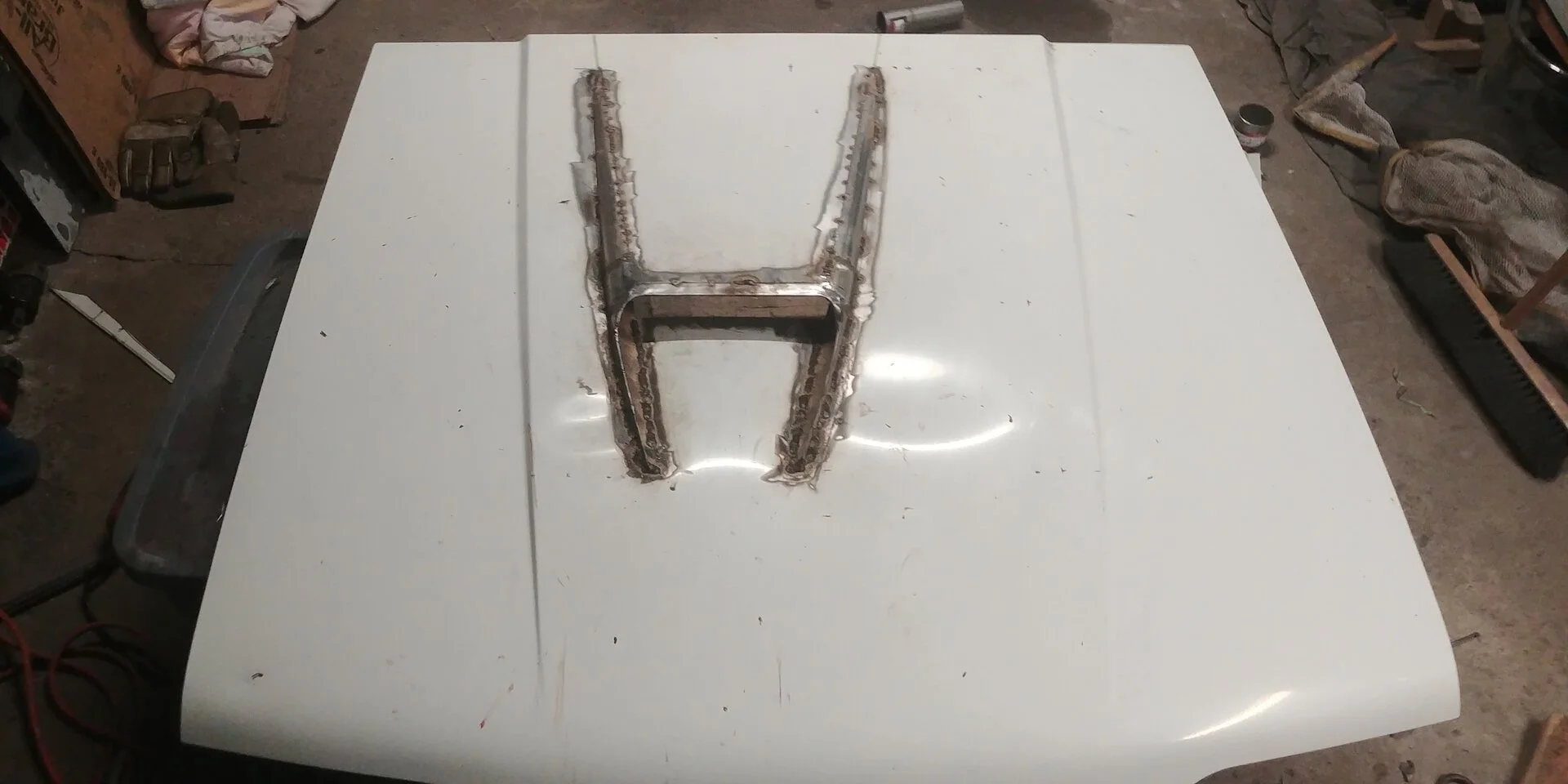

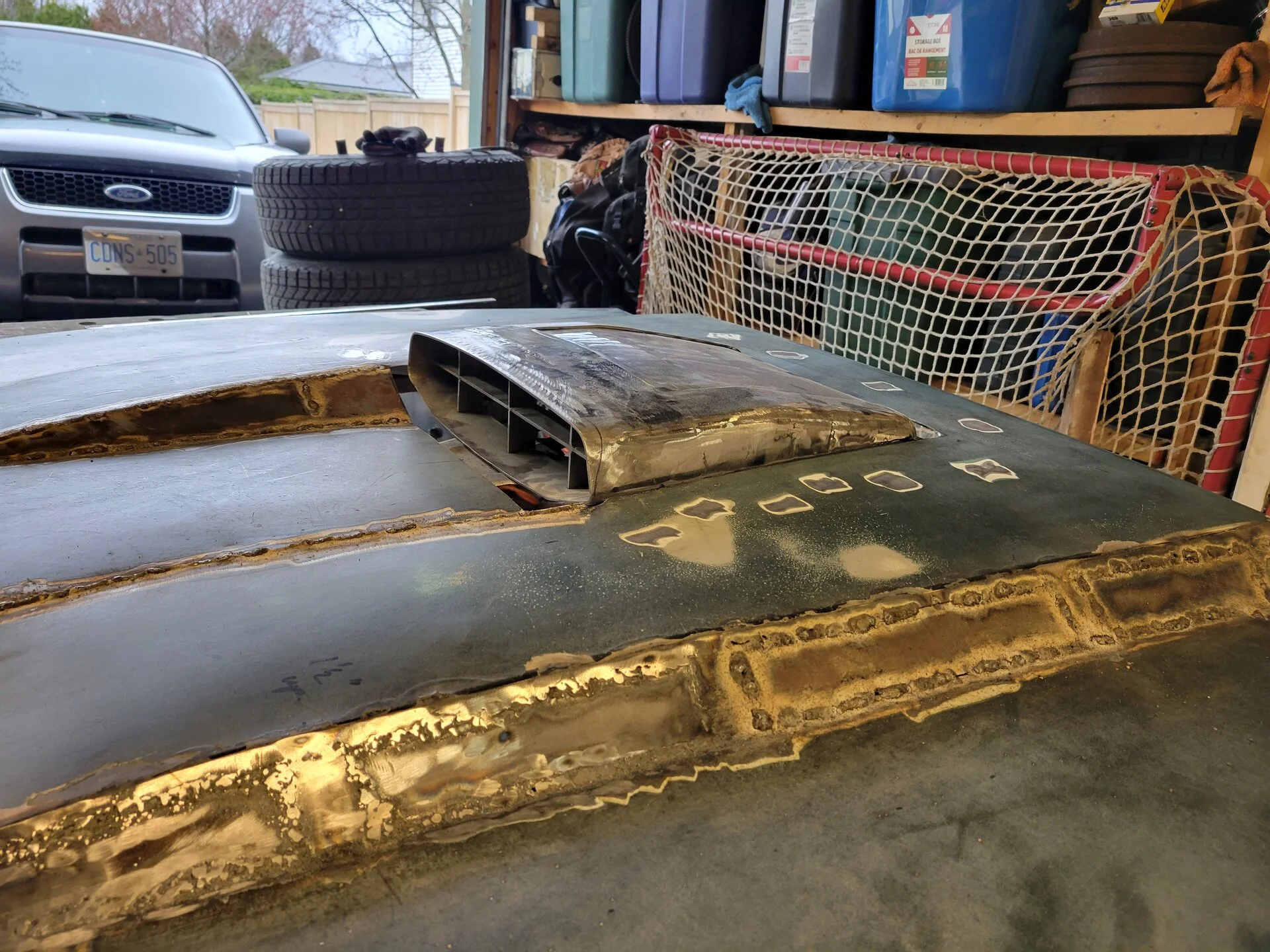

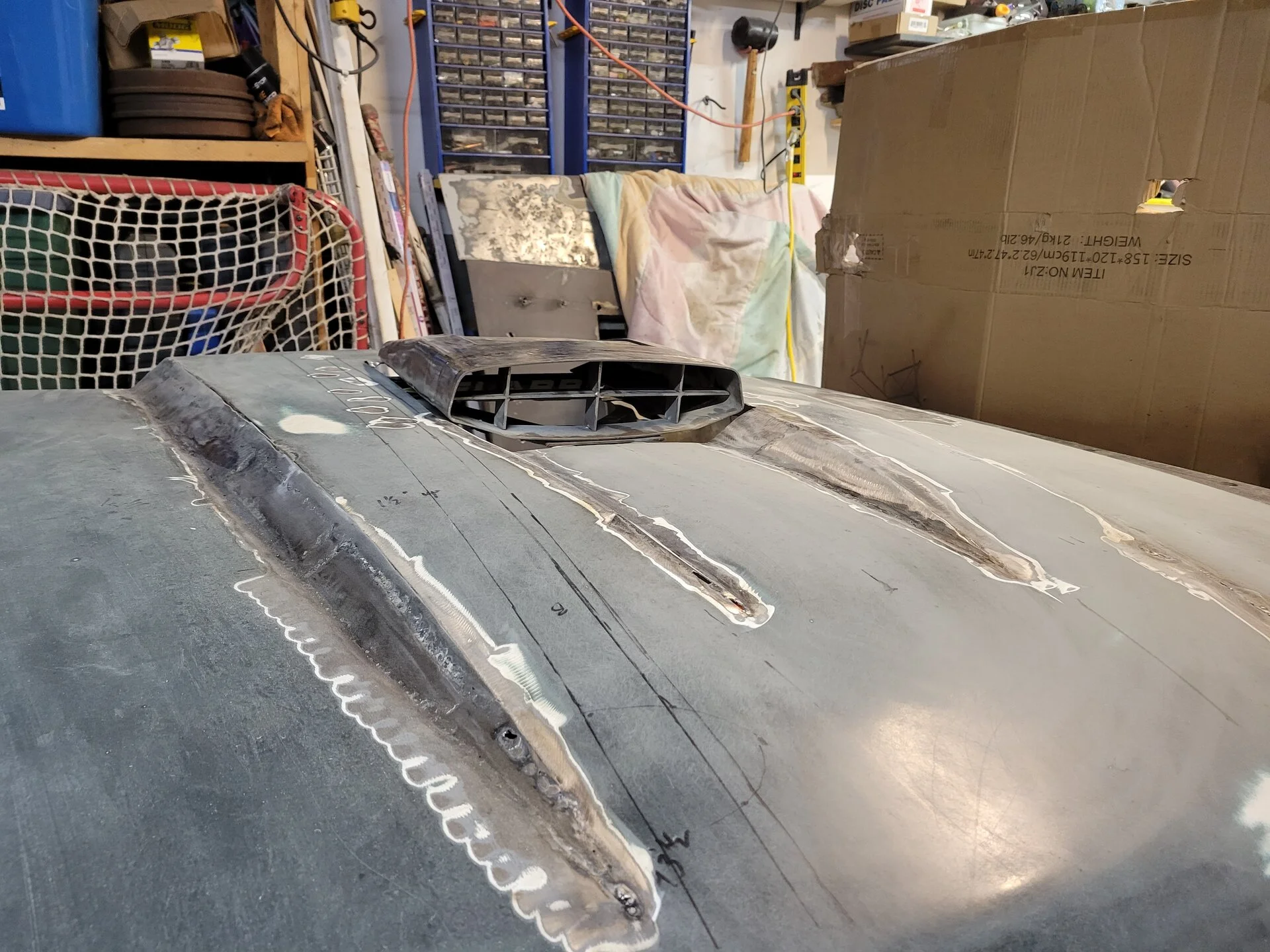

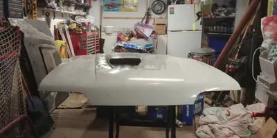

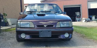

When I made my current hood I marked out the cuts to help visualize the modifications ...
Now I am working on a raised cowl with custom made shaker hood scoop.
The scoop in these pics is still sitting on the bracing (I haven't cut it out yet). My point, where is your scoop going to sit on the hood, find that location. Then my suggestion is go 3-4" forward of the rear edge of the scoop and draw a horizontal line from side to side. Leave a couples inches on either side of the edges and mark inboard from there. Make the hole 2-6" wide. Make a trim lip you can mount underneath if you want to help keep some of the water out. Got it.
It would be so much easier to just lay it out on a pic if you have it. Lots of ideas and talented people here, help them help you.
