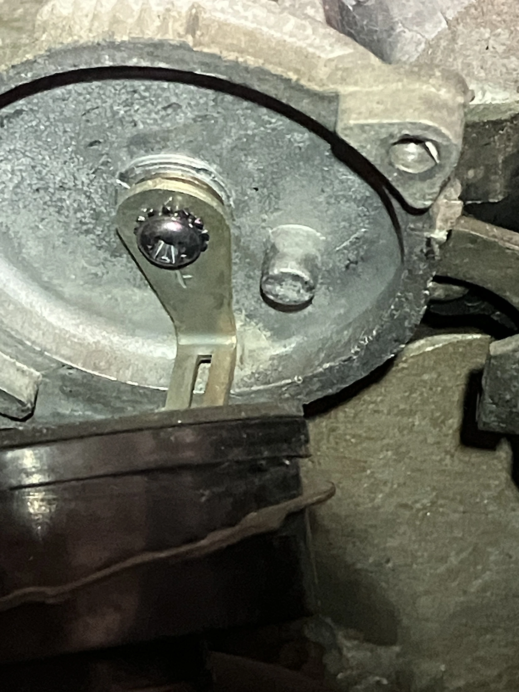

Got this video sent to me from someone’s working high cam mechanism… note theirs has way more movement than mine. Mine cannot psychically move that much upwards because it hits the metal post inside the choke spring area as seen in picture below video.
View: https://youtube.com/shorts/UKVDD7mketg?si=enbiolBEDvOTk7m-
Thanks! I have reviewed that thread. Actually in contact with the person that wrote it. Trying to find out why my high idle cam (black lever) doesn’t move like it’s supposed to. The post I posted pic of is why but not sure of another way to hook up
