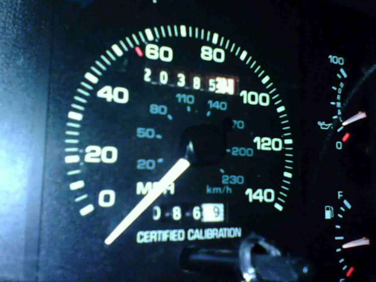

The speedo is out of a 89' cop car. the speedometer has "certified calibrated" printed under the pointer. there is no needle for the pointer to rest on and there is no indication there ever was. the number printed on the speedo says, E7-Z. Some people ive talked to say because it was a cop car it would have been a 5 speed and that l probably have to change the gear in the trans. (my car's has AOD).

Heres the speedo

shouldnt there be a peg to hold the speedo needle at the 0?? Im not sure if when the car is started that the speedo needle will move to zero or if it stays in the same spot.
