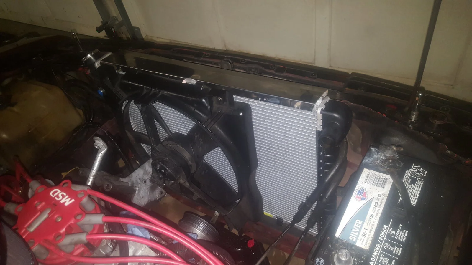

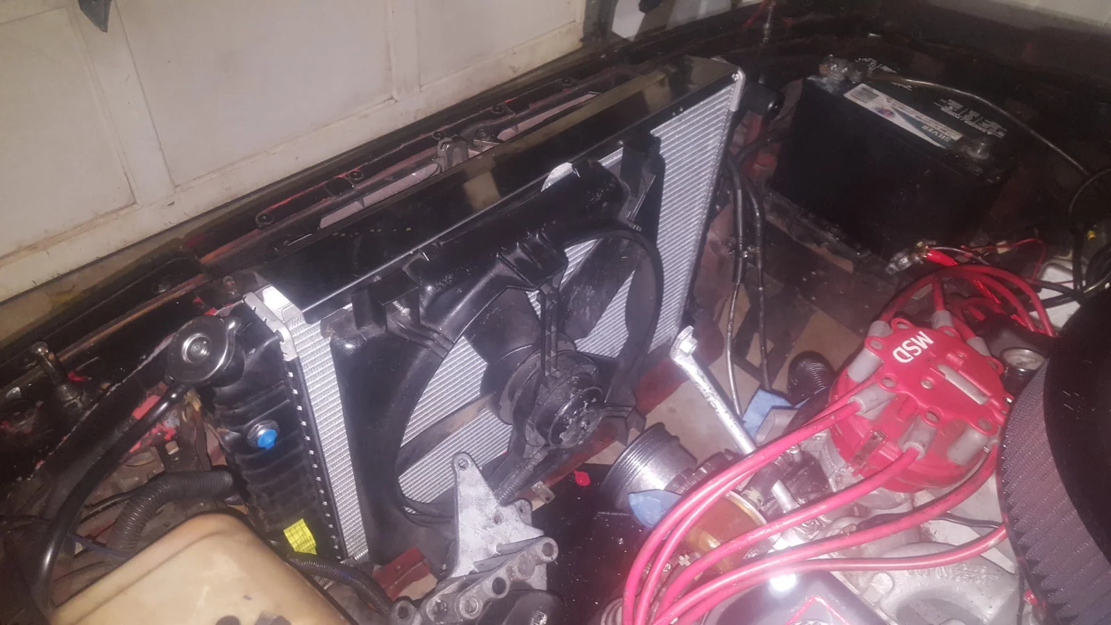

Ok, I bought me a 86 mustang with a 306 carb engine. Holley 4 bbl, edelbrock performer air gap intake, gt40 heads with comp cam alumi saver roller rockers 1.6, edelbrock long tube 4 to 1 headers into single chamber flows. That being said I purchased the car with an overheating problem. The radiator, water pump, thermostat have been changed. Also replaced junk heads for gt40's with nice rocker set up thinking heads where just warped. Still overheating, Could it be a air pocket? Could it be a bad radiator? Or most likely is it the block at this point? And if it's the block what's the best bet for a new short block for my set up? Mostly to drive and enjoy but some street/track stuff.
Do you have a fan shroud on the radiator? I ran dual electric fans on a nice three core radiator and still had overheating issues at stop lights. Installed one large fan with the correct shroud, and boom, fixed.
You're about a fan shroud suggesting individual aren't you?
I think its best if you post pics of the existing install. One things for sure.....Its not the block:O_o:
Could be air pocket. Have you tried to burp it? Jack up the front. Could also be pump rotation incorrect. What is your timing at? Does it begin to over heat really quick? As mentioned a fan shroud. My 66 tbird would get really hot until I spent the money for a shroud and for that thing it wasn’t cheap but I can sit in 90° traffic with no issues. Oh if you’re running stock fan/clutch make sure it’s good as well
Takes about 10 mins to overheat. The pump spins clockwise and showed a mechanic and said correct pump is in the car. Timing is @12degrees

Post #4 stated the upper and lower radiator tubes where cold, figure your talking about the hoses, that is a sure indication of no flow.
#1 check/replace thermostat
#2 check rotation of water pump. This will likely require removal.
#3 possible head gasket on backwards. It is possible to install both gaskets on backwards and cause a no flow issue.
it also would be possible that the radiator is plugged, that is easy to verify.

It's a ribbed pulley moving clockwise facing the engine. I showed the water pump to my mechanic friend and mechanic at my body shop. Both agreed it's correct pump moving in the right direction and looked to be in perfect shape. Unfortunately. When I put the heads on paid very close attention to the correct placement of the gasket knowing that it's common that they are out on covering up the wrong holes. Made sure the thermostat was in correctly too. But that being said the hoses are almost cold to the touch especially near the radiator once gets to temp on the upper and lower hose.

Yea I'm gonna check radiator for flow and get a better thermostat. And burn the system. My guy at the shop has a vac that will do it more efficiently so will be utilizing that this weekend.
