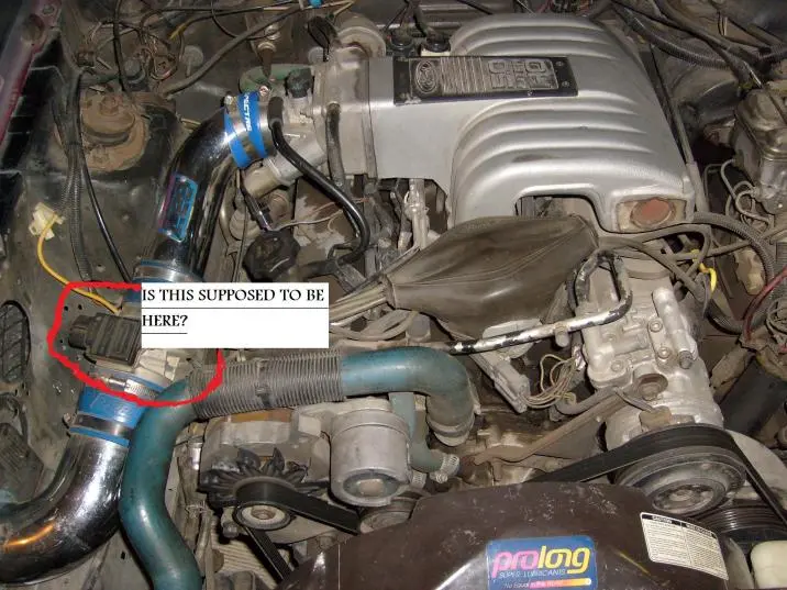

Hello- My brother just got an 86 5.0 I have a question about one of the sensors, it's the sensor on the cold air intake setup, I am thinking it's not supposed to be there. I have looked every where to try to find the wire connector to hook it up and it's no where to be found. Hopefully the picture works.
I am in CA so the smog checks are a pain in the butt, I think everything else besides this one sensor is in order.
Thanks

Thats a mass air flow meter, but an '86 has the speed density set up; so your MAF is just "there". It shouldnt hurt anything performance wise, but I dont know how the Cali smog inspectors would feel about it though.
It looks as though the previous owner was going to convert it to mass air, if you want to convert it to mass air later then at least you have the meter.

The speed density uses a few different sensors to "guess" the amount of air coming into the engine, (thus supplying the proper amount of fuel.) The mass air system actually meters the amount of air coming into the engine. ( More precise, fuel efficient, powerfuel, etc.) I don't know exactally what parts you have, so I dont know exactally what you need to complete the MAF conversion, but if all you have is the MAF sensor, first step is a MAF computer...

The main sensor in a speed density car is the MAP (Manifold Absolute Pressure) sensor located in the middle of the engine compartment mounted on the firewall just behind the driver's side of the upper intake.
Strange that there is a mass-air meter with no other supporting mods, and it looks to be a stock meter, too. Check around that side of the engine bay, are there any loose wires that look like they could reach the plug? My worry would be that the car already has a MAF computer (A9L or equivalent), and the car is running in limp mode, though it seems like it would be running really rough. You can look at the computer, which is hidden under the passenger side kick panel, and see if it is an SD computer or MAF. See my website link below.
If the car runs fine, yank that meter out (replace the gap with some tubing, look into speed density specific CAI intakes, BBK has an adapter) and wait until you really need or really want to run mass air to complete the conversion. The speed density setup will run fine on the stock motor, and can handle most basic bolt ons. With that meter being a stock unit, and just sitting there with no purpose, its actually hurting your performance, and may stop you from passing emissions just because its not supposed to be there in that year car.
In any event, do some reading at Ford Fuel Injection. This website has a TON of information regarding the inner workings of that car, and will help you find a solution.
speed density cars stock for stock vs maf cars were faster it's just when upgrading the maf setup handles it better and with speed density your limited on how big of a cam you can go with but if your leaving it stock or just adding a few mods here and there without swapping out your cam speed density will be fine. To convert to mass air you need a meter which you have, a computer from a mass air car, some wire and some ecm pins. Do a search on here and you'll see full write ups on how to do it. it's not hard but again it depends on your plans for the car. I do have a speed density intake elbow that i'd let go if your intersted pm me and i'll get a pic of it for you.. it'll basically go from the throttle body all the way down to the chrome piece that goes into the fender in your pic.
