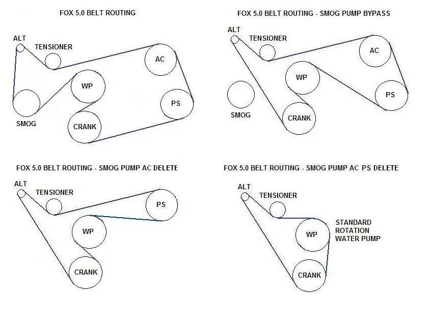

Dino Dino Bambino 15 Year Member Jun 13, 2007 1,672 89 79 Cyprus Oct 6, 2012 #1 Oct 6, 2012 #1 It's a FAQ so here's a sample of what's possible. I chose not to quote belt lengths because of variations between belt manufacturers and the installation of underdrive pulleys in some cases:

mikestang63 SN Certified Technician Aug 27, 2012 11,606 8,859 214 In the garage Oct 6, 2012 #2 Oct 6, 2012 #2 These belt sizes worked for me.
