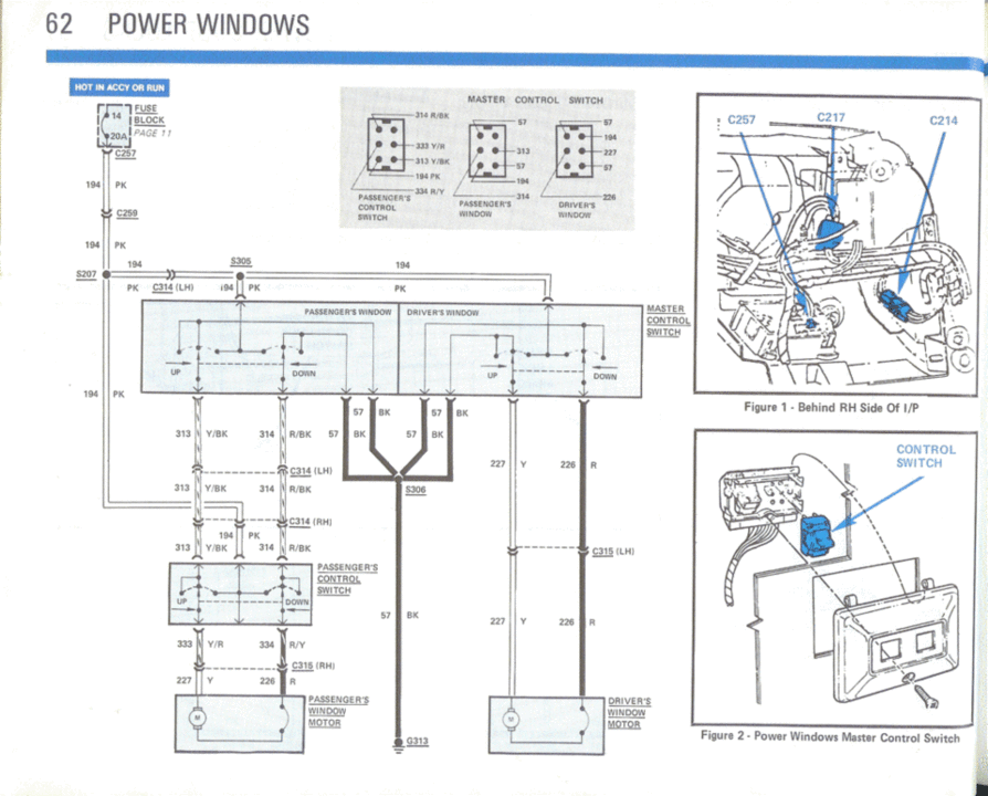

Any help with this would be appreciated. The passenger side power window stopped working, it wont go up or down. I checked via test light, that I have power going into the switch. I have power coming out of the switch at that plug. I put power from the battery to the power window motor plug and was able to get the motor to raise and lower the window. I plugged the switch back into the motor and was able to get the motor to raise the window but not lower it. any opinions as to whether it would be the motor or the switch ?

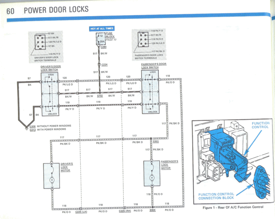

I have some diagrams that may help...being that I am lazy and busy, you'll have to copy them and rotate them so that they are easily readable.
See http://slantnosefox.com/picturehosting/jeremy/86 electrical & vacuum troubleshooting manual.zip you can download the whole set for an 86 Mustang courtesy of Jeremy, AKA V8only.
