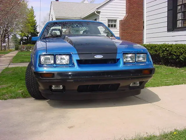

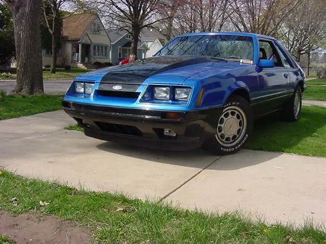

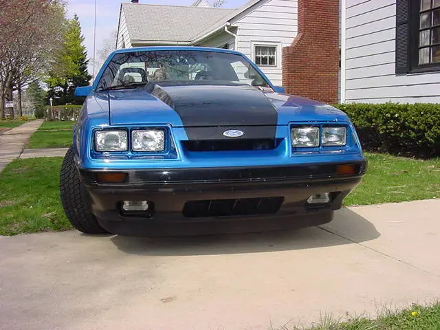

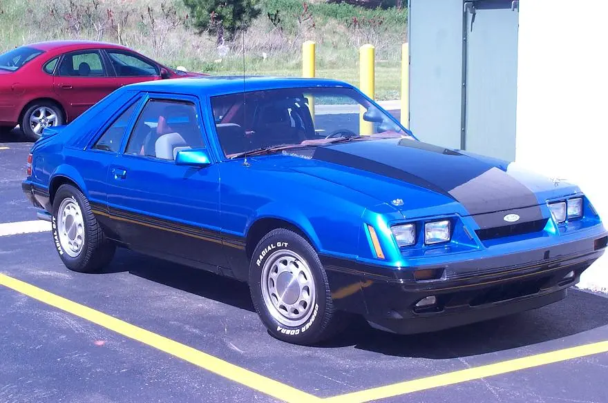

Here's mine:
I used a dremel to cut it down and an orbital hand sander to shape it. I cut reliefs into the corners so that it would bend and fit the way that I wanted and heated it with a gun to make it more pliable while I bolted and screwed it all down. I drilled the holes into the air-damn to take advantage of stock hardware locations and only had to drill 4 holes into the sheet-metal of the car itself for the wrap around side pieces.
Later, I cut it down even more to get rid of the wrap-around pieces. They were more trouble than they were worth for catching the edges of driveways etc. and also made it very difficult to get a jack under the car.
The modification made a huge difference in the way the car handles at high speed. The whole car is a LOT more stable than it ever was. Removing the side pieces do not seem to have had an effect in that improvement.
Edit: BTW... the spoiler sites approx 4 inches off of the ground at it's lowest point. You've got to be mindful of that when driving/parking etc.

Yes... (sorta). The orignial part number came from a Bronco II (same thing basically). The shipping of the part cost as much as the part itself did.
Edit: Which by the way was only like $23 or $26 for the part itself.

Well, the main thing I'm concerned with is ground clearance my car is low as it is and I dont want to be like the import guys that do the diagonal turns over speed bumps. I guess I could get a Bronco chin spoiler and make it the height I want it.
Yeah... that's the beauty of it. The spoiler is ABS plastic. Use rough sandpaper disks to shape and trim it then finer stuff to finish the edges. Just make sure you don't do this in your garage or kitchen. hehe A dust mask is also a plus.
