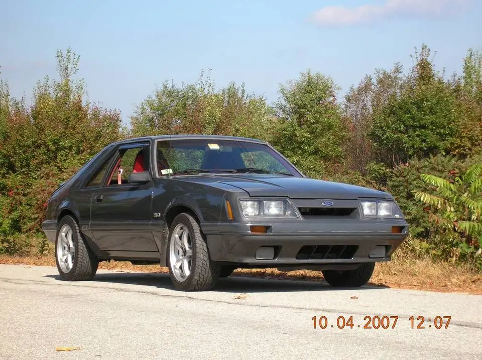

Some old pictures that show my dash with the coverlay:
From:
Mustang Photos 1986 GT
You can see a little of the dash in this more recent picture:
From:
Mustang 86 - Mach1 Springs
