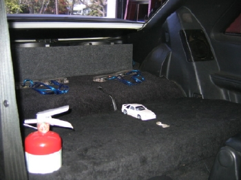

here, this will give you an idea. basically, it was a thinner piece of plywood carpeted. with some excess black carpet. i ran that back over the hump and then the hatch covering came down over it. cut slots for my harnesses and ran all my stereo wiring underneath it.
board sat as you see there pretty good. just pushed it into place from the front. didnt even have it mounted, never moved on me. you just cant sit on it except for in the middle where its suppored by the tunnel.

My homebuilt one complete with fire extingusher holder and model of my car
