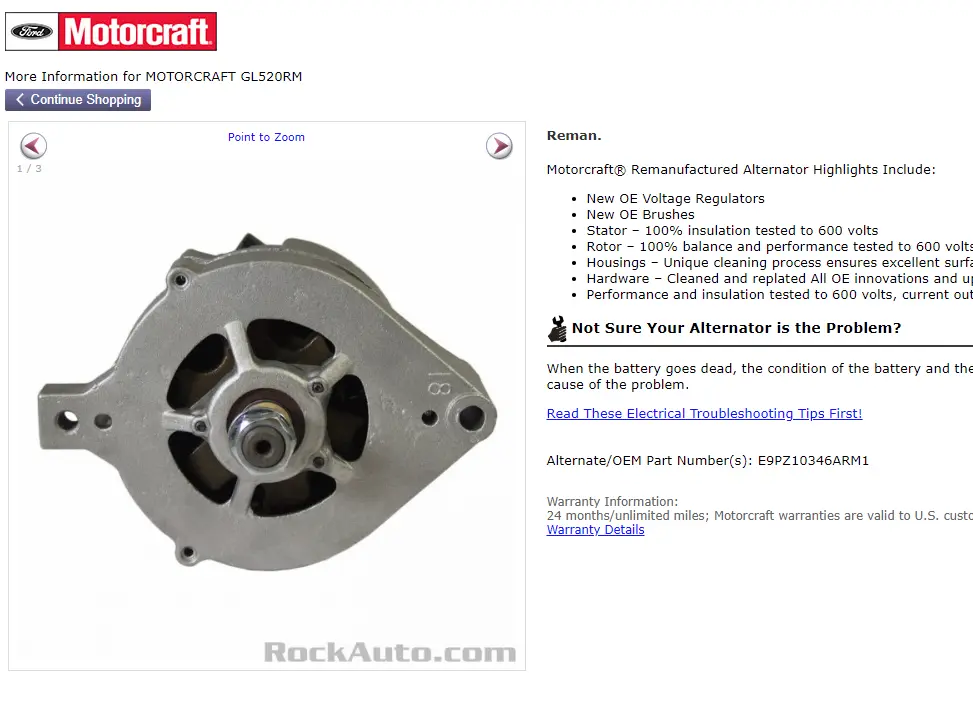

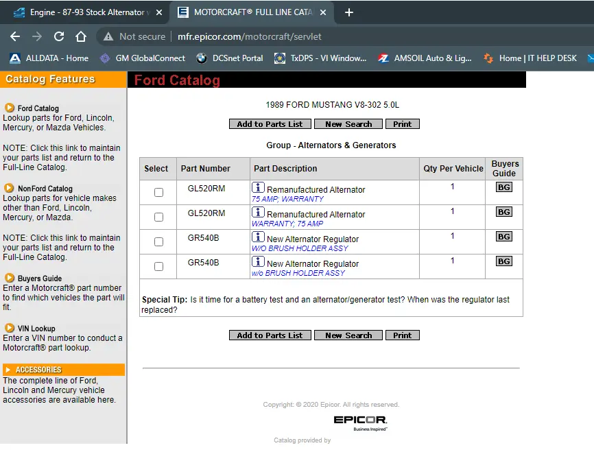

As far as the motorcraft part number for a fox-body 5.0 alternator, here you go, straight from Ford:

I know the original ford part number was gl520rm but i have been unable to trace back the dl7734 to an original ford part number. This is the one that actually comes clocked correctly but its for a 90 f-150 and if I look up the 90 f-150 on ford parts the dl7734 does not pop up but it exists so it must come from somewhere! I would just be more content with the motorcraft equivilent of the dl7734.
