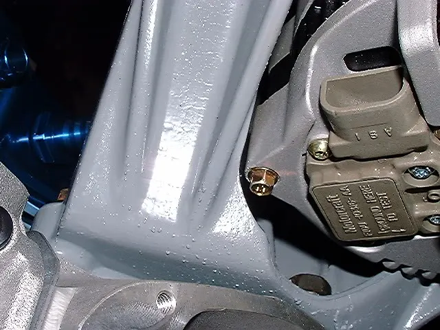

You'll need the alt, a wiring harness, and you'll need to grind down the inside corner ofthe alternator bracket. For specifics, check here: http://www.fordmuscle.com/archives/2001/03/paperformance/index2.shtml

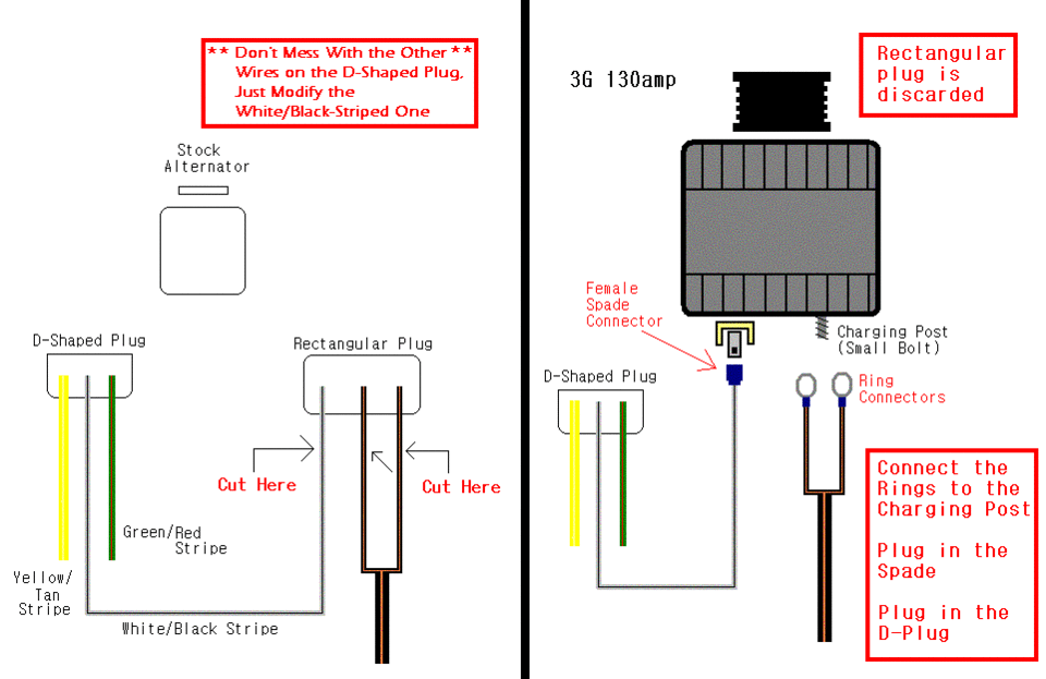

here is a wiring diagram of what to do. also need to add the 4 awg wire as well. and a pic of what area to grind on the bracket.
