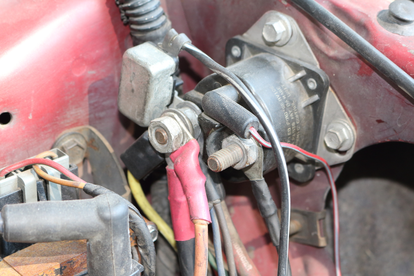

Hell everyone, I'm new to this group and look forward to future conversations. I love Mustangs and own 5 and counting. Although my most current one I bought 6 months ago (87 GT convertible) is giving me some starting issues. After I bought the car I noticed an intermittent issue where now and then when turning the ignition key nothing happened, after a couple turns it would start fine. Then it would start fine for a few times and then the problem would show up again. I replaced the starter solenoid but now a different problem showed up. Now about every three to four starts, when I turn the key to start the car the motor keeps cranking and I have to rush to disconnect the battery cable to stop the engine from cranking, even pulling the small ignition wire from the solenoid will not shut down engine cranking so I don't think it's an ignition problem. I even thought I bought a defective solenoid so I bought a 2nd new solenoid and on the 4th start (not consecutive but while out driving) the continuous cranking happened again. Any help would be greatly appreciated, Thank You.

I think its possible that it is the solenoid connections. Only the small wire from the starter goes to one post. Every other wire and the heavy wire from the starter go to the other post. If the heavy gauge and small wire from the starter are hooked to the same post it sort of does what you said is happening.

On a 87, unless it was swapped to a high torque mini, the big wire from the starter goes to the second post, the rest go to the power side minus the signal wire.

See the solenoid wiring diagram I posted. Both standard and mini starter versions are covered.
