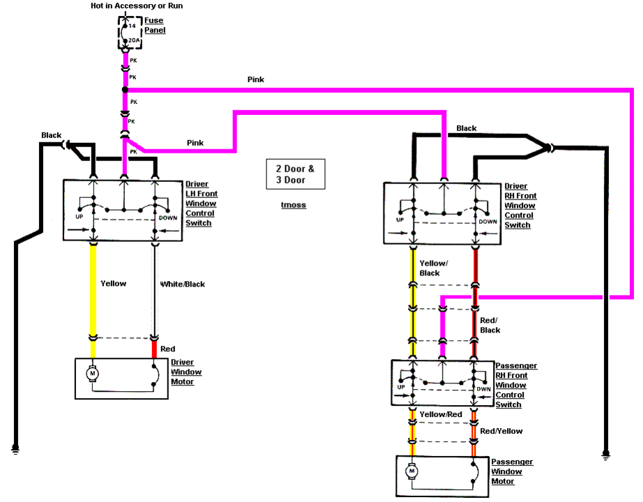

See the following website for some help from Tmoss (diagram designer) & Stang&2Birds (website host) for help on 88-90 wiring and lots more… http://www.veryuseful.com/mustang/tech/engine
Diagram courtesy of Tmoss and Stang&2birds.
The circuit breaker only works for the windows. The locks are on a different circuit. I originally hooked up just power locks and used the original harness connection in the drivers side kick panel, a two wire harness. I didn;t need the breaker with just locks, but with windows it was needed. One of the wires in the connector is the window power (pink), the other the lock power. So if they both stopped working at the same time, I don't think it is the breaker causing both to fail. Maybe the ground wire in the drivers door is loose? Or the door harness is somehow disconnected from the main harness, or by some chance both power supplies are shorted or blown. I would find the connector in the kick panel and test it for power too.
