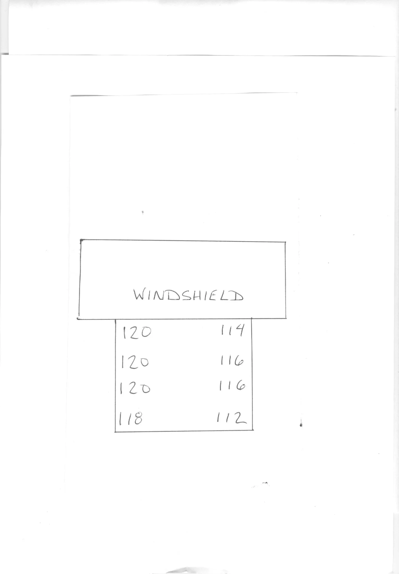

I did a compression test (cold motor) and the results look a little low to me. Does anyone know what numbers I should be getting for a stock 5.0?
Did you hold the throttle wide open and crank for 5 or 6 revolutions??
Try that a see if it changes...
Then squirt some oil in all of the cylinders and crank it again..... If it comes up your rings are probably at fauilt.

Those readings are at the low end of acceptable,
