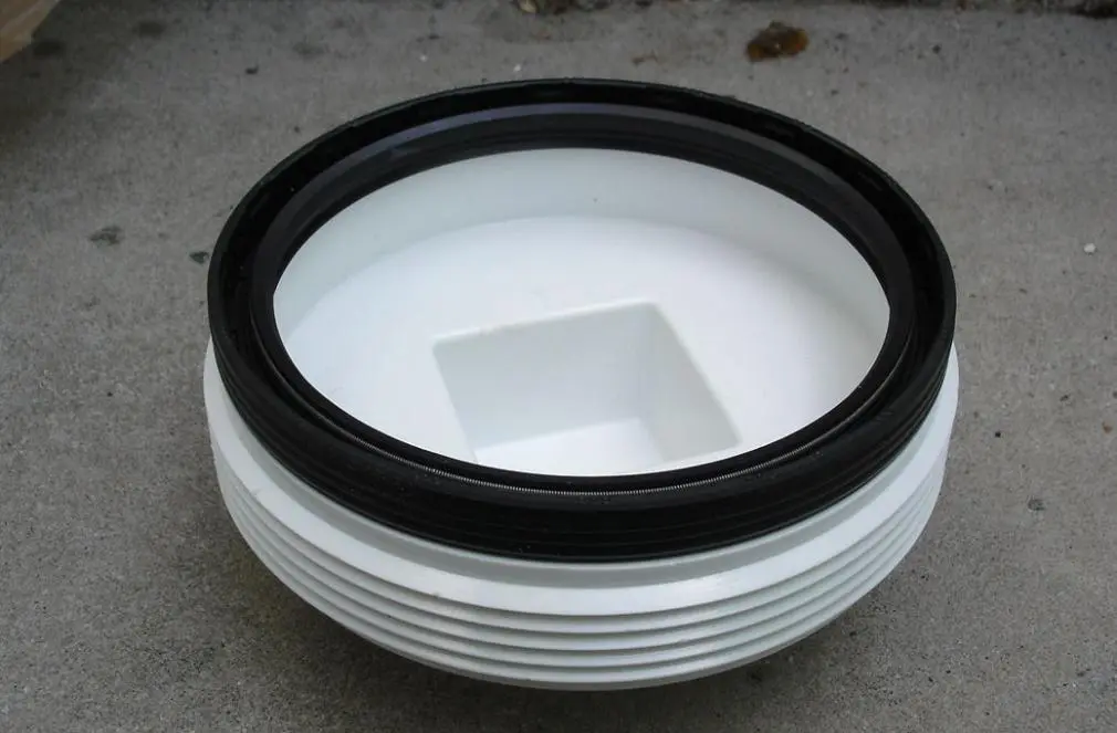

I used a 4" PVC plumbing cleanout fitting to drive in my seal. Worked out well for $2

That is what I used,and worked like a champ, thanks. Now I hope it will not leak.
