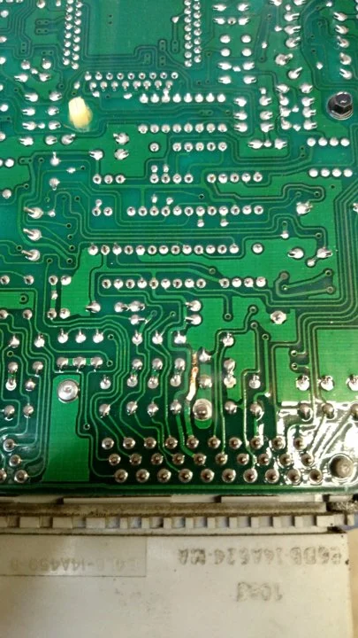

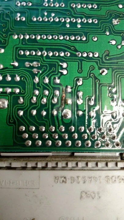

I pulled my computer and looks like its damaged.. What's the process for the fix?

Another pic of the computer, if you could or someone just tell me (show me lol) where to solder a new wire on to fix this (my) f-up I will be greatfull.

Just solder a wire between the solder points above and below the burnt trace. 28 or 30 gauge will be fine.
ok thanks, I know the lower solder point Is, by where the computer plugs in but it's kind of hard to tell with the upper solder point is.could you give me a reference. Please, and thank you. I don't want to mess this up for a second time, lol

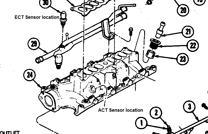

Might want to unplug the ACT and ECT sensor, and check that you have 5v between the two terminals in the connector. Looks there might still be an issue with the SIGRTN circuit. But that depends on what you find when you test for voltage.

I used a actron scanner, when I do is a key on engine off test I don't get an 11, I get kind of a fuzzy blank. then it's followed by a code 51, 22, 54, 81, and 85. when I do a key on engine running test I get a code 98, 54, and 51. I think I'm having trouble dumping the codes I started another threa I sync code 54, and 51 are the a ACT and ECT sensors. I have a new ECT sensor to put in because its broke, but I do not know where the ACT sensor is ..lol

The ACT for 5.0 Mustangs lives in the lower intake manifold #5 runner.

Thanks, I found it. I had nothing plugged it into my harness (no sensor).I replace that I just laid it on my intake,I'm getting a new gt40 upper and lower on Monday with the number 5 tapped and drilled.
