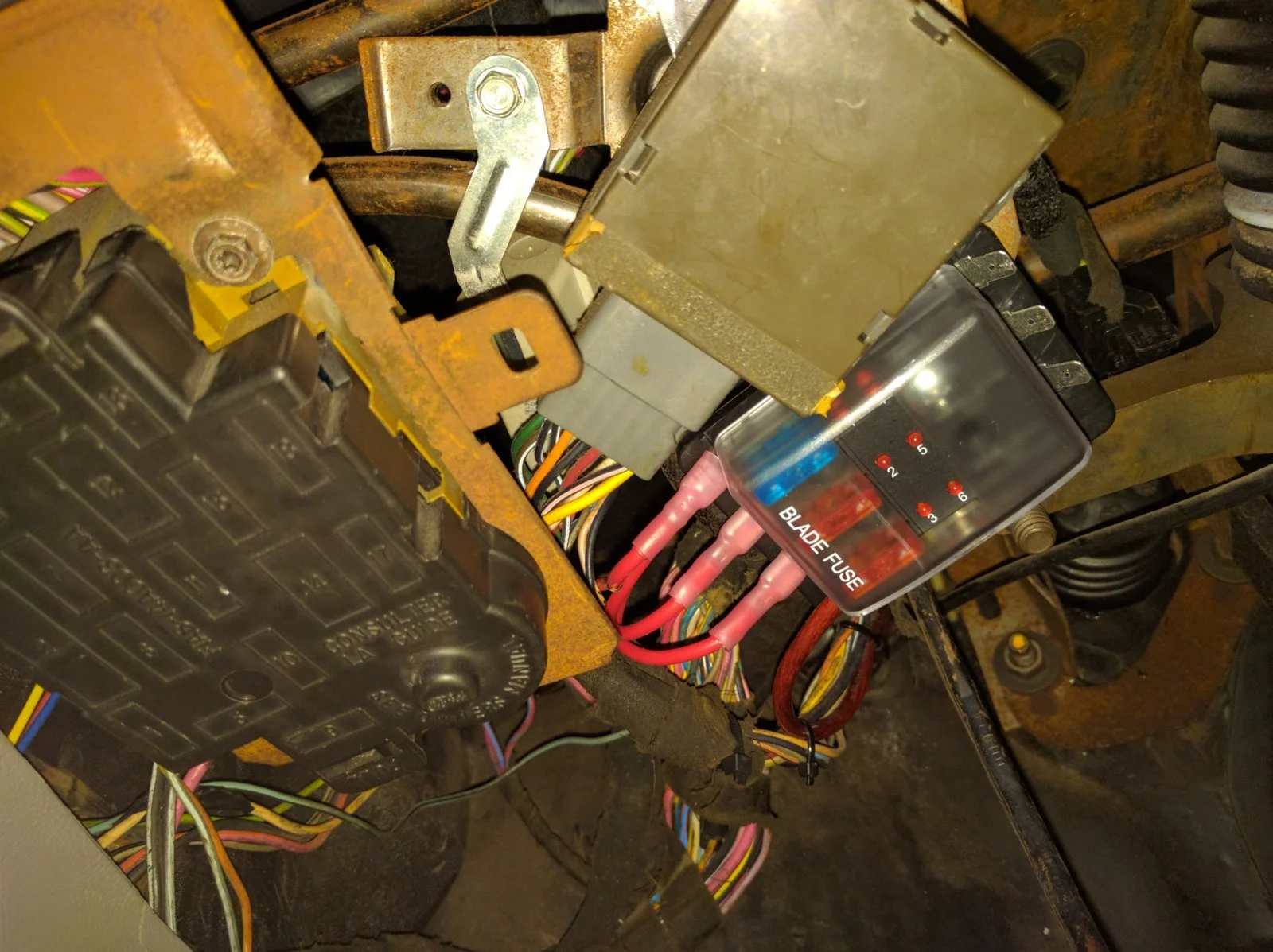

I have been doing some more thinking on powering all the upgrades I am planning.
I am needing to power the:
1. Digital dash
2. Transmission control unit (Microsquirt)
3. Wideband O2
I was thinking of adding a small 6 or 10 panel fuse box to power all these items with extra for the future. This would protect all these items but also simplify the wiring by only needing to run one power wire from the solenoid to the inside of the car.
@a91what thoughts?

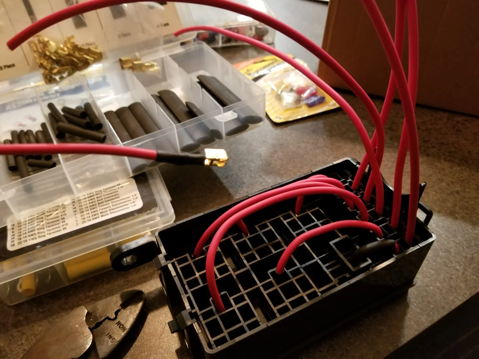

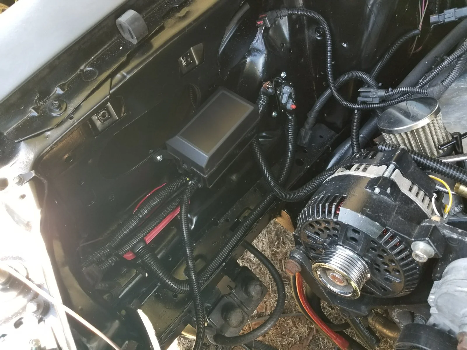

I did just this when I rewired the first time. I picked up a small 6 relay box that was fused as well. I did have to pin each wire and build the box out but I think it turned out very well. It is covered in my build thread, if you want i can try and find a link to the box i used.
still unfinished in this pic.the red insulated busbar is the 12v source for each relay, it is fed with battery power via 4g and each relay gets it's own fused load source. The 12v common for the relays was fused through one fuse and daisy chains to all relays.

The only thing I would do differently looking back is hitting them with some solder before the heat shrink. Smaller boxes are available but I prefer the large bosch relays that are common to find.
1. Digital dash
3. Wideband O2
@a91what thoughts?

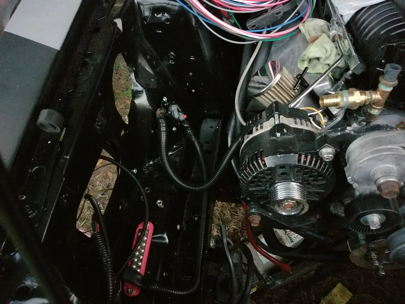

I added a little 6 fuse block underneath the dash to have separate fuses for the radio, cigarette lighter, spotlight, etc and it's worked out well so far. Definitely not as robust as @a91what box but not a bad simple option.

That's not a bad idea but you definitely want your main power supply right off the battery for the sensitive electronic devices, I dont suggest feeding them from ignition power, grounding all of them commonly would be best as well.
Oh sorry I should have said I don't have it tapped into to the ignition, it runs to the battery directly and is fused there as well. I just wanted dedicated hots for stuff rather than using the factory circuits
That is the exact same one I was looking on Amazon. I am just needing fused hot leads since I don't like the idea of running multiple hot lines inside the car. I much rather run one and use it to feed my other additions. This makes it nice that the factory is left alone.
The ignition feed are for items that are just used as triggers to turn on, so no worries of inconsistent powering.

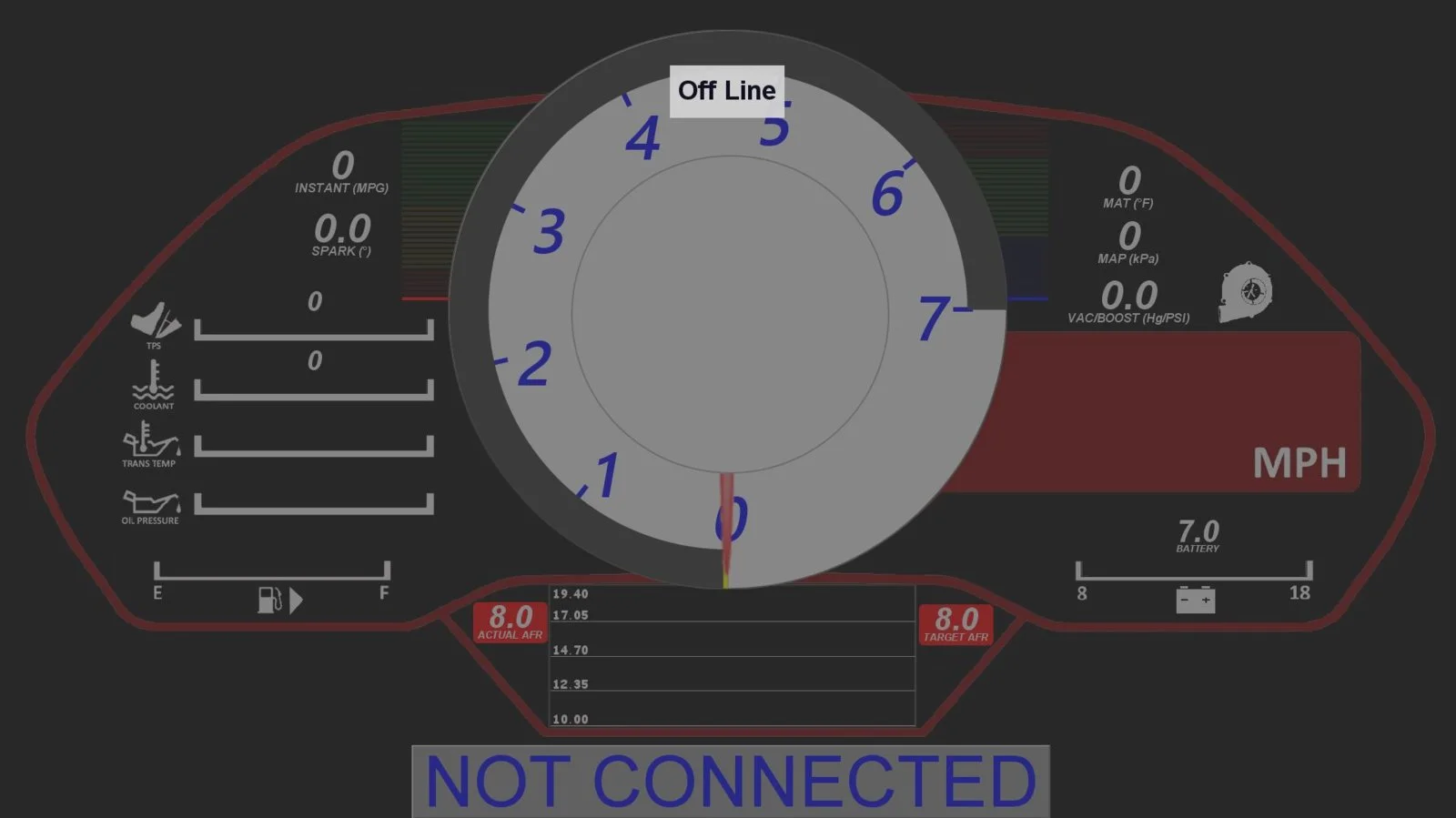

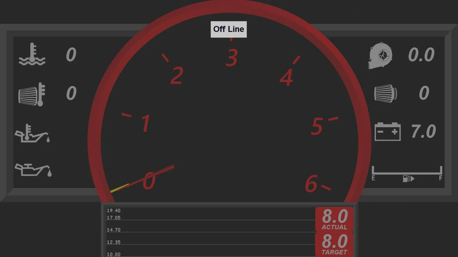

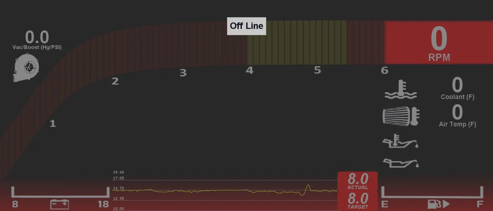

I have been working on a couple dashboard display's and wanted everyone's thoughts. These will be used on the digital dash I have been building.

I really like the bottom one although I would have to use it to see if I could live with the sliding rpm gauge. it has all the pertinent info and uses the entire screen... only having a 7" screen to work with using all of It will be important.
I have been driving with that one in the car, which is my latest one I built. I like the sliding RPM gauge, but are not a fan of the dashes. I would like it to be a solid line, and have an email into EFIAnalytics to see if there is a way to modify the .gauge file in there directory.

I like number 2, does that sound gross?
I'm sure there is, people alter the .ini files all the time. After that you just have to figure out what part you need to alter.

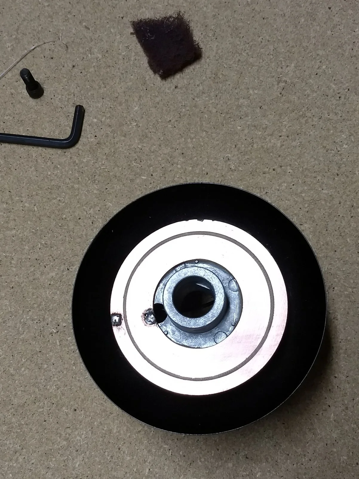

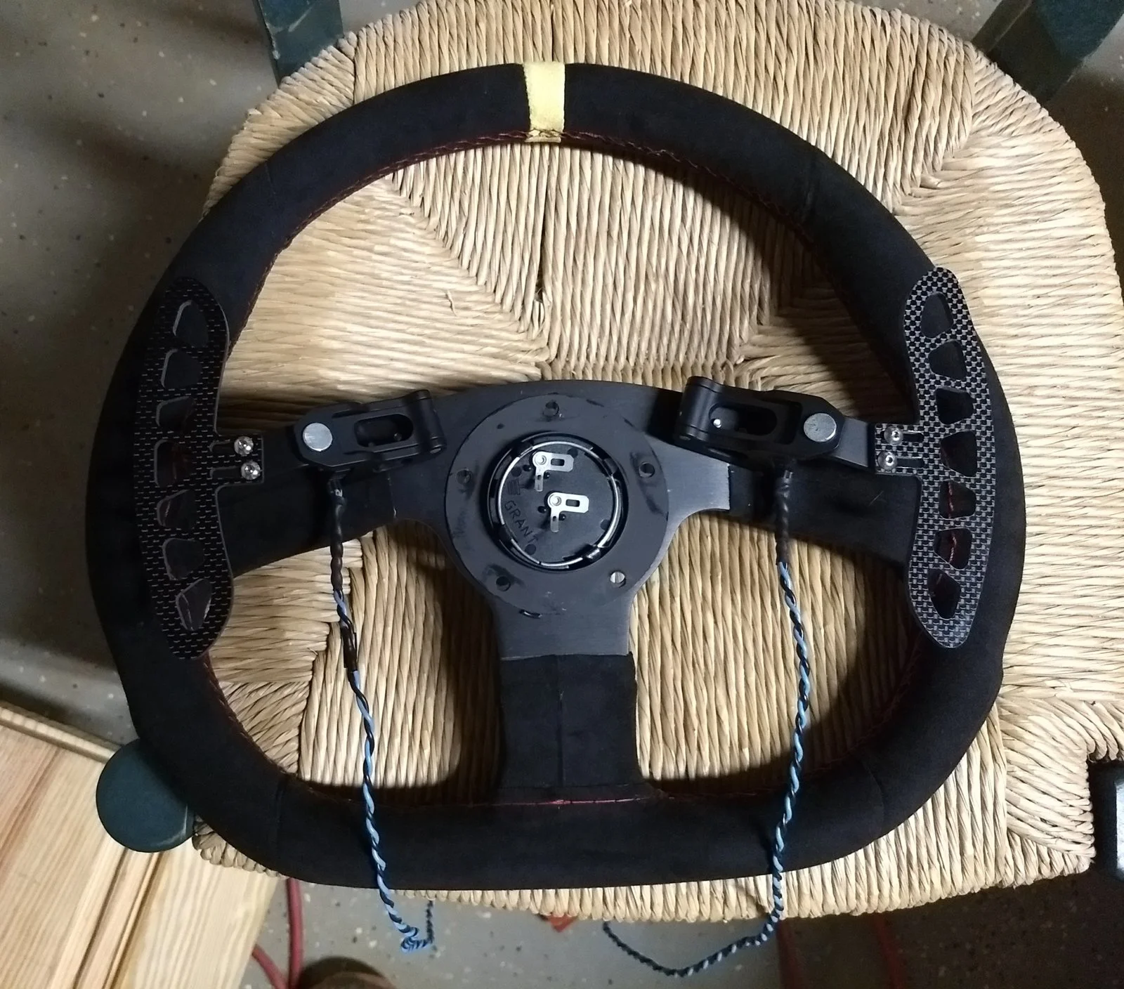

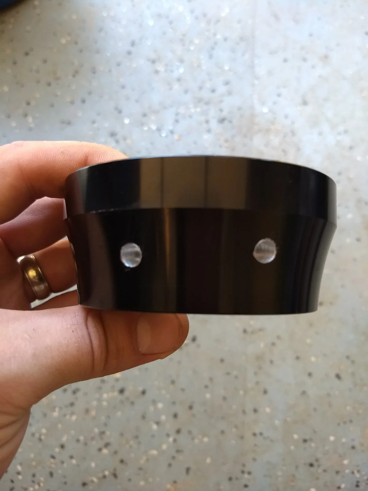

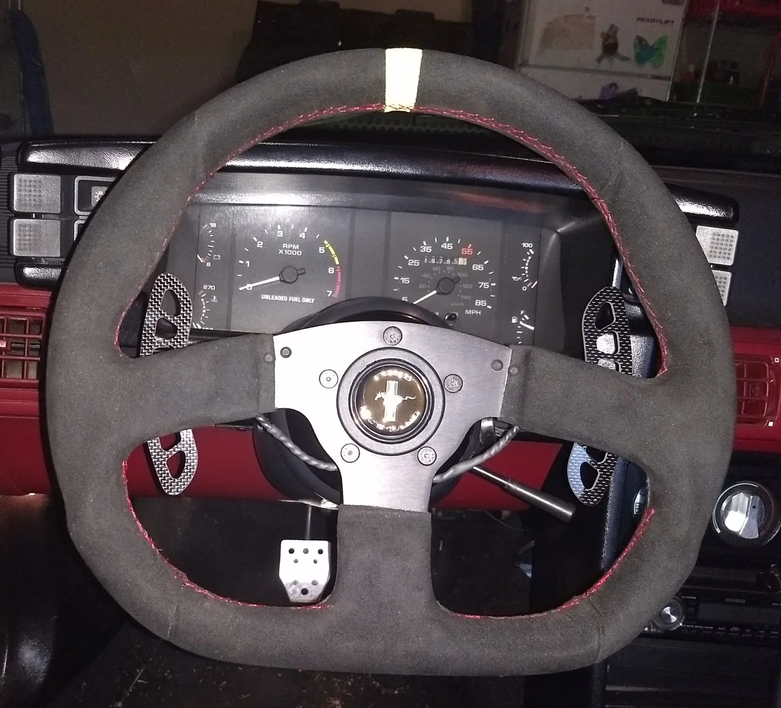

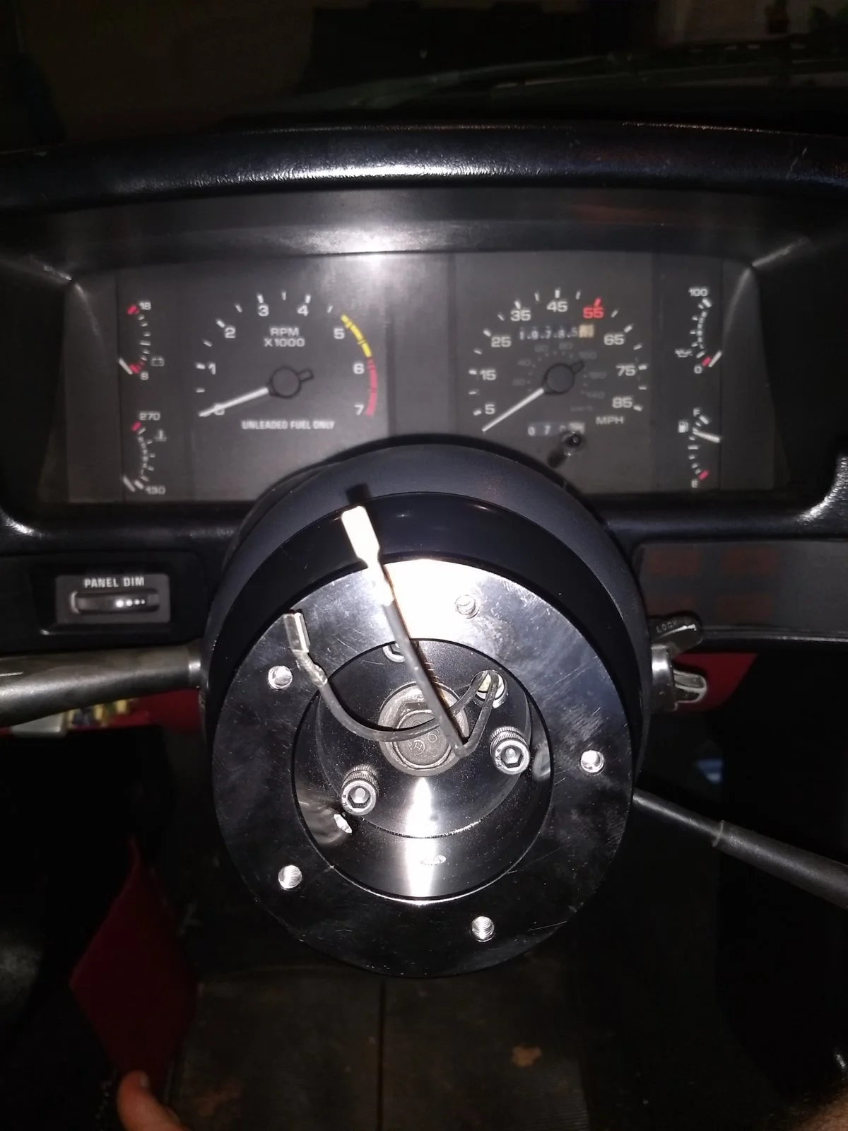

I did get away to my garage for a little bit over my vacation (ie: staycation since I stayed home) I had last week. The house projects that I was working on took at LOT longer than I was expecting, but more importantly the heat just killed you. I accomplished the main task that I wanted over my time off, which was installing my steering wheel with the paddle shifters. The paddle shifters of course are not operational just yet, but everything is ready to go for them.
This project took longer than expected due to some issues with the adapters I was using. The Grant Hub that was on the car originally needed to be replaced due to the mounting holes being trashed. The new hub the slip ring had one of the wires to close to the feed-through hole, so needed to desolder the wire and redrill/solder for the new hole. Then drilled the two bottom holes in my 3 bolt to 5 bolt adapter for the paddle shifter wiring to pass through. I installed the new hub assembly on the steering column and mounted the new steering wheel.
Drove the car to work today with the new setup and love it. Can't wait to get the dashboard finished up and get the transmission and TCU to start tuning again.

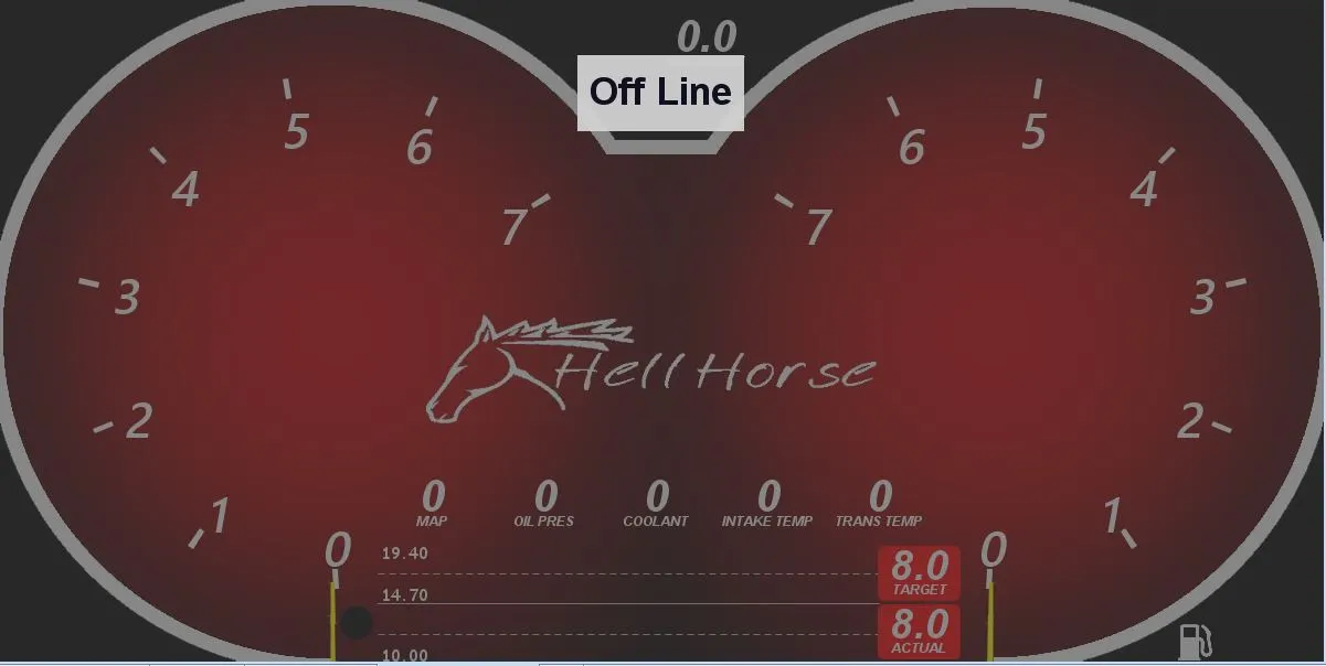

In the meantime, I decided to work on another dashboard display. Still haven't made up my mind on which one I like the most. TunerStudio did add some new features like being able to swipe from multiple dashboards. This is a really cool feature that I can use on my digital dashboard.
That is really awesome, are there any limitations in TS with the small touchscreen or does everything work just like on a laptop but smaller?
