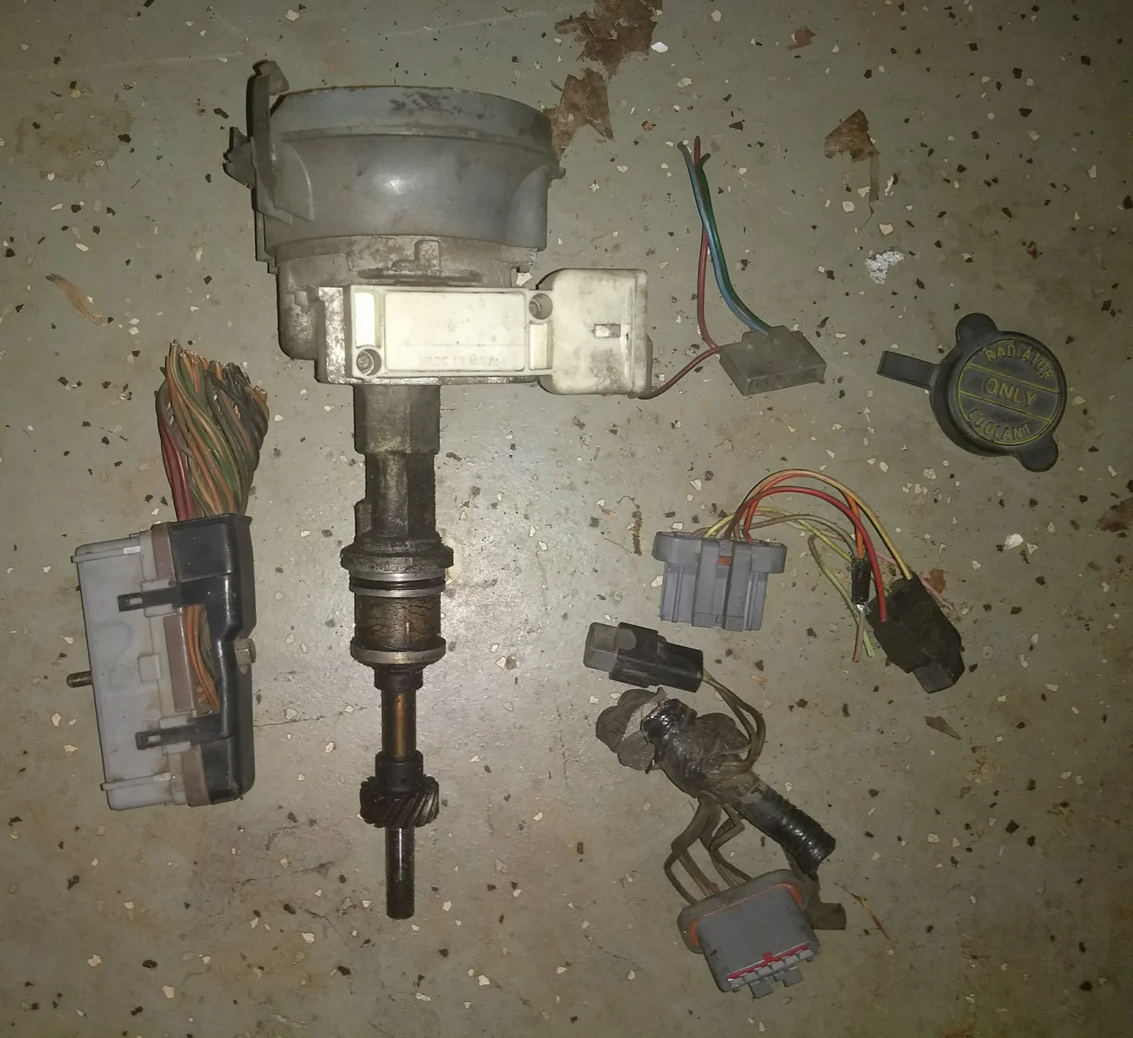

Still waiting on my parts to get in, but was able to get to the local Pull-A-Parts. They had a 1990 Foxbody there, but was gone by the time I got there which sucked. There were 2 Crown Vic's so I pulled a spare distributor that I will rebuild and put on the shelf as a spare. I also got some additional plugs for a future project of building a new engine wiring harness, so I got the 60-pin computer plug, TFI module plug, Coil plug, and IAC Valve. Couldn't find the TPS as they were both gone already.

I was finally able to get a picture of the goodies I got at the pull-a-parts.

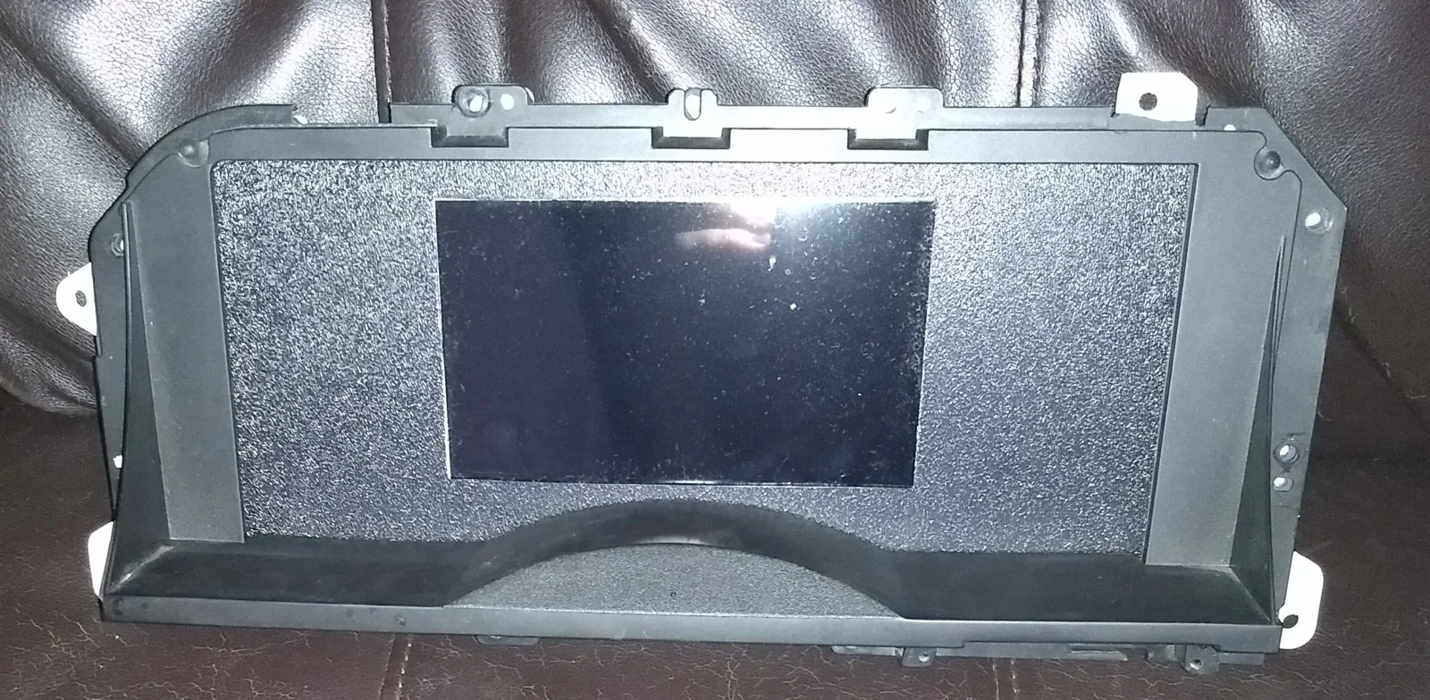

I can then shift my focus back to the digital dash.
Well I got the last part ordered and should be here early next week. I can then put together the power supply and program the shutdown process script. This will finalize the digital dash to test run it in the car.
I am so happy to get to this point.
