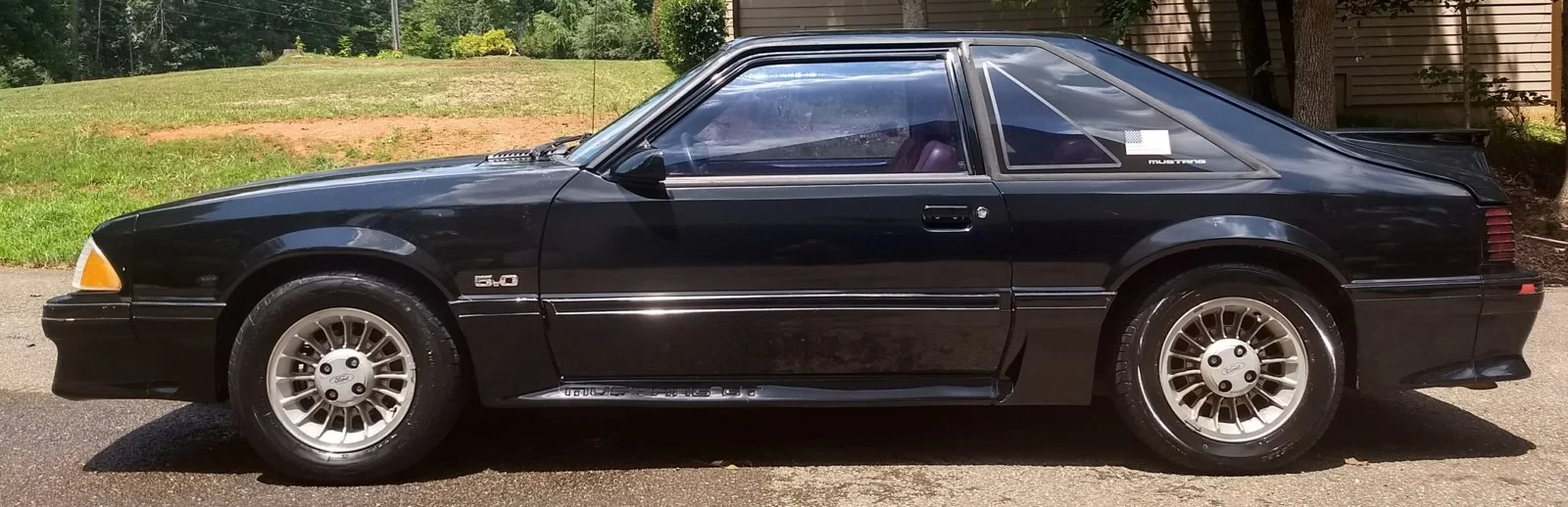

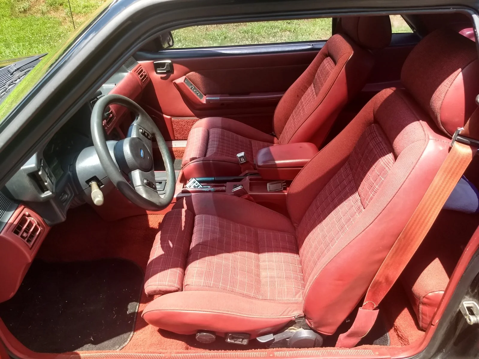

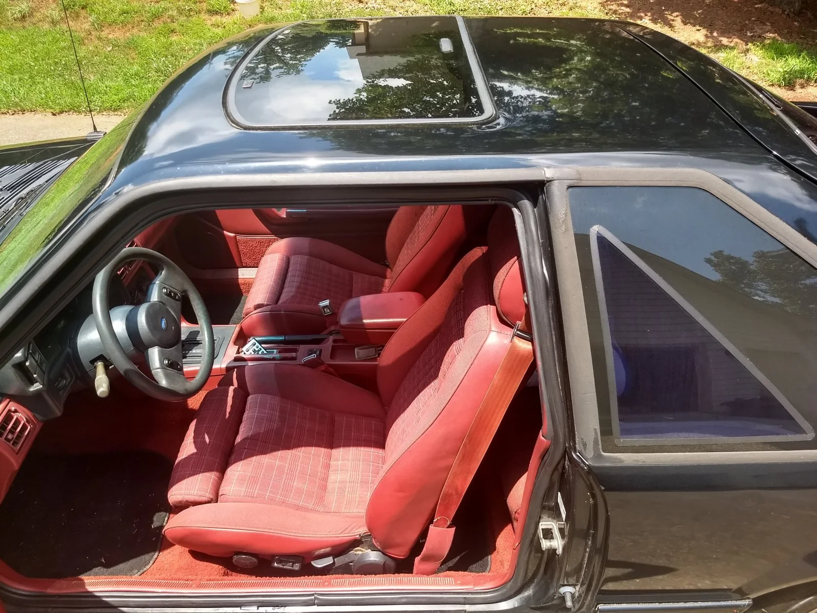

I have been working on another project while researching the information needed to complete the power supply. I bought this from my dad that has been sitting for 5 years. It need quite a bit of cleaning to get it to a driving status. Just finished putting on the new plate front tires since they were dry rotten, and cleaned/shampooed the entire interior.
I am quite happy with how it came out and will be a great daily driver while to work on my main mustang.
So now for the pictures:

WOW man she looks cherry! I gotta say I love the turbines too, brings me back to the 89 gt I had in high school!
You got another spare fox lying around that I can drive while mine continues to live in the shop?
