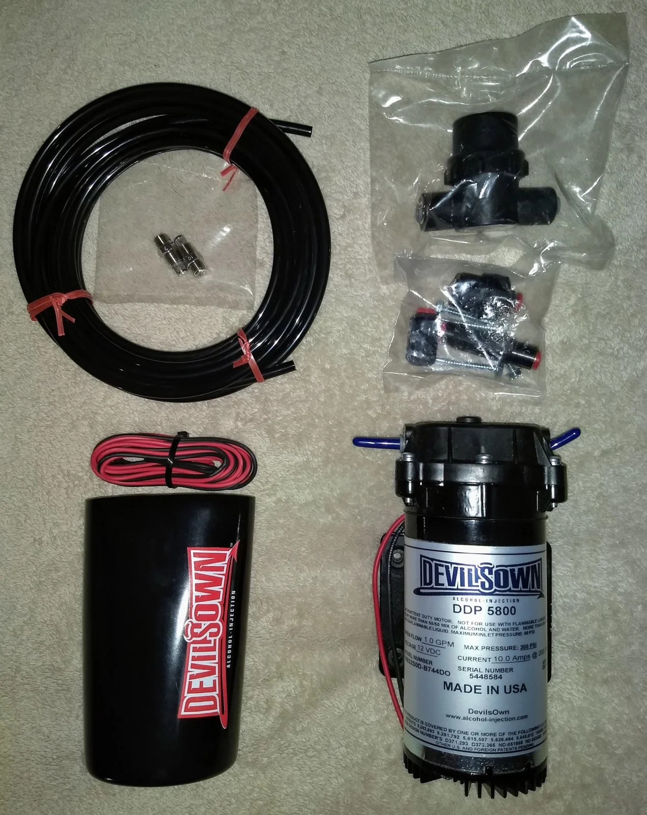

I know it has been a little slow progress wise on new updates, but the weather has been terrible making it impossible to get a new video. I may just do a video in the garage with a couple revs to see it all working.
A bit of good news is I did get my Xmas present that I wanted. It is a complete WMeth kit that will be installed on my new engine build. I got with the kit a 7 and 10 size nozzles, so this will be some fun.
