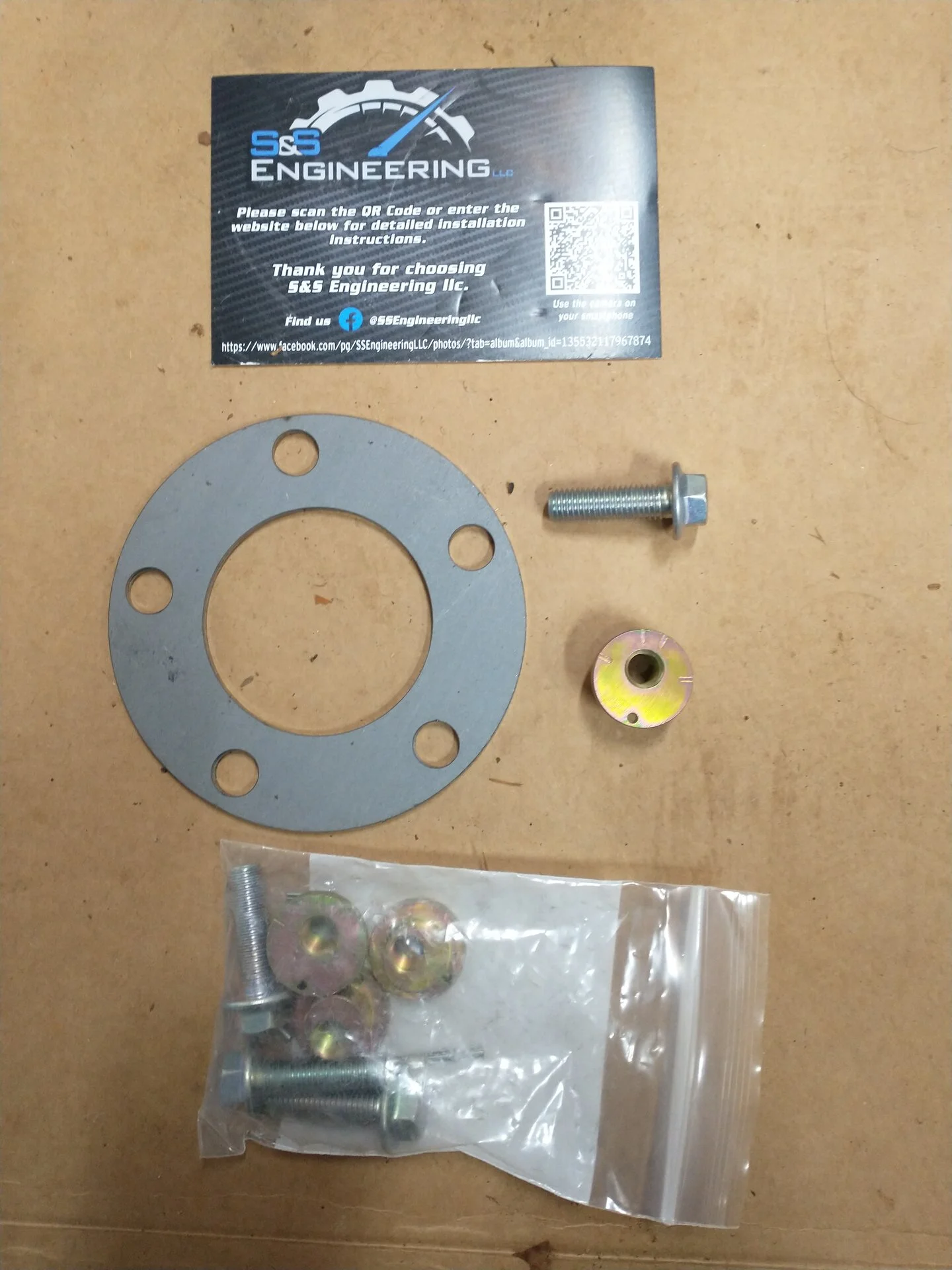

The offset bushing kit came in from S&S Engineering which includes the bushings, rotor spacers, 10.9 bolts, and roll pin and drill bit. This is a well thought out kit in my eyes, and should make the installation process a lot easier.

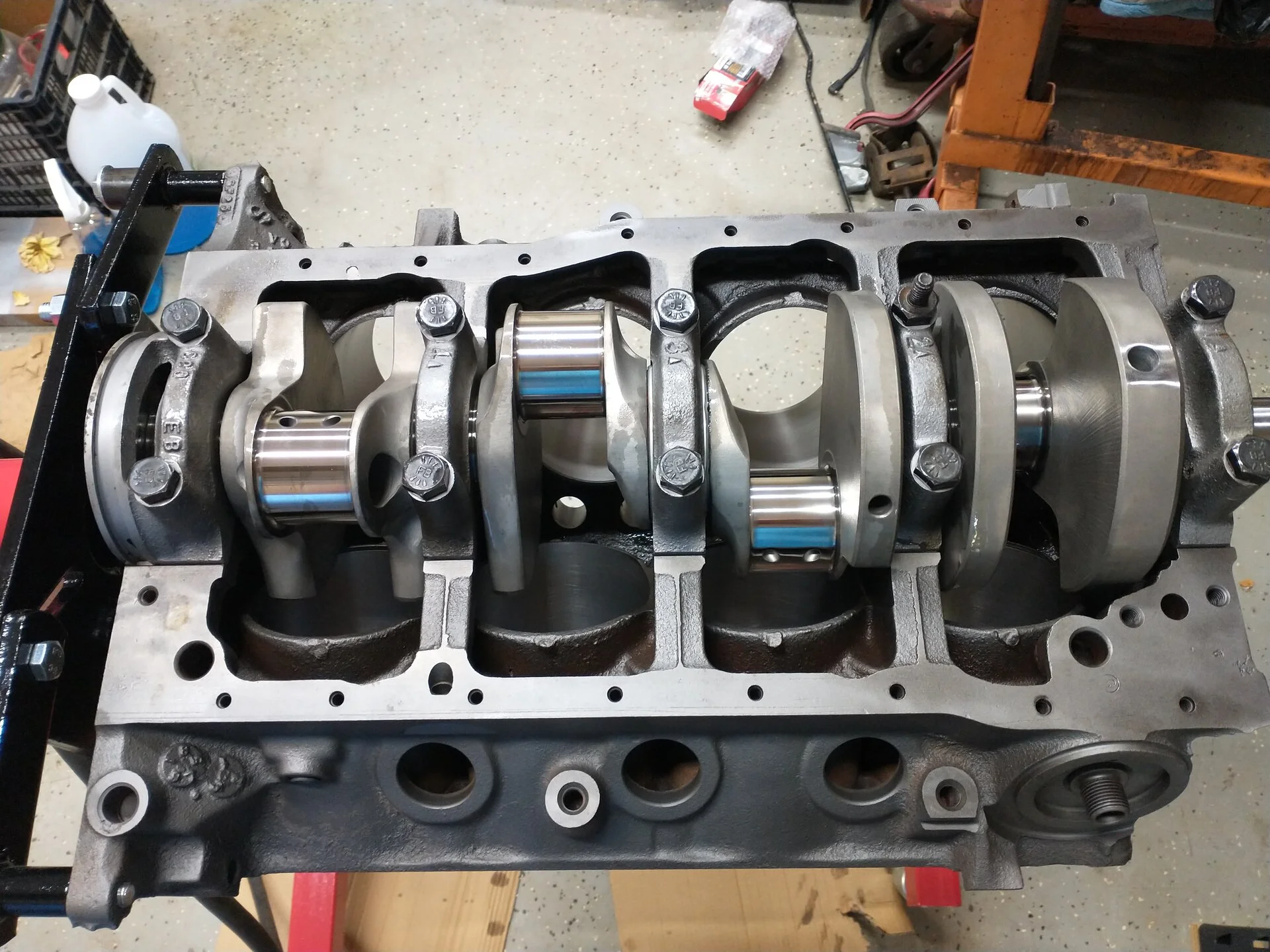

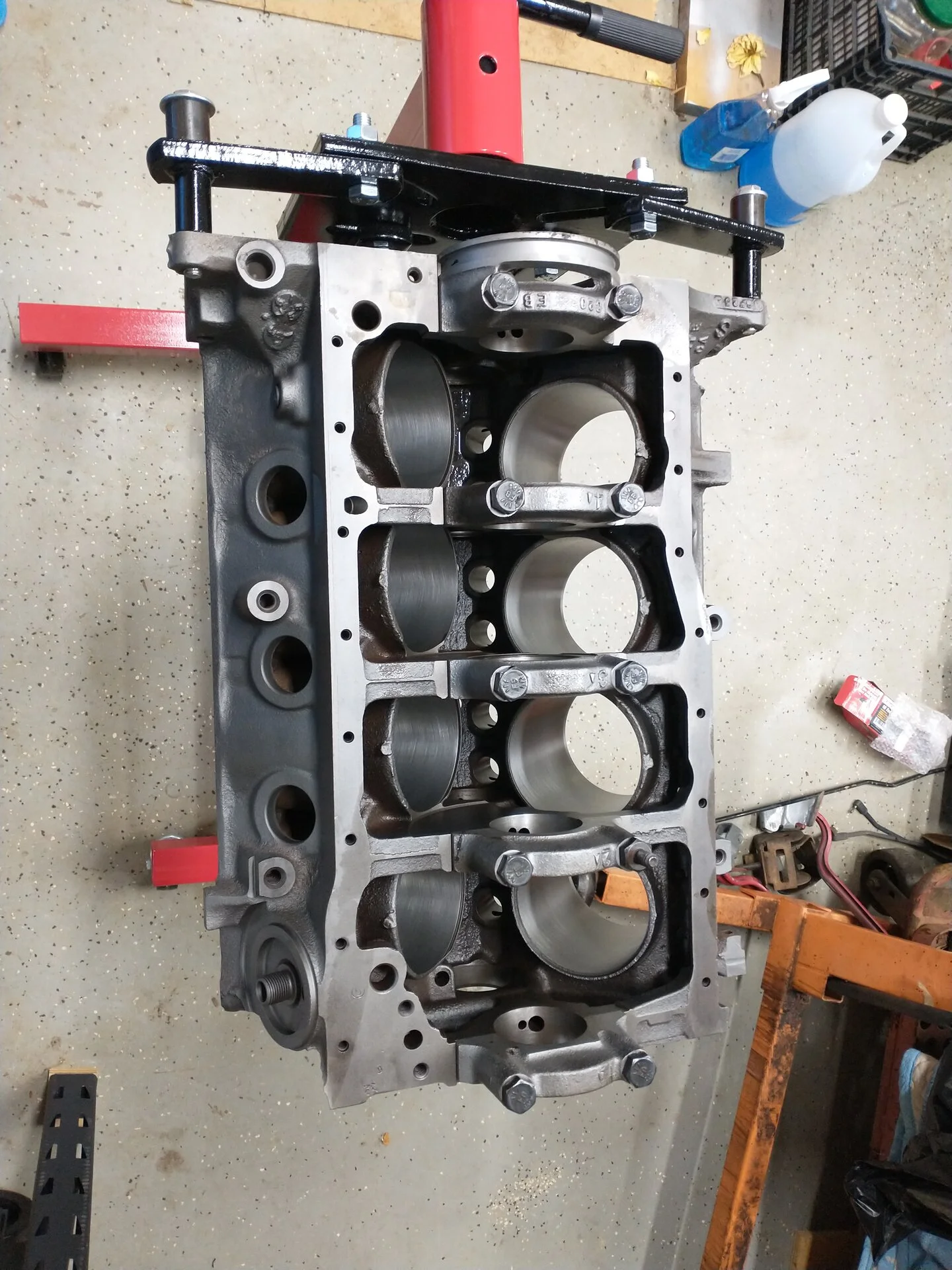

Time for an update now that I have been able sneak out to work on the engine. So yes, I was able to pick up everything last Friday, but then everything sat over the 3-day holiday weekend. Everyone knows how it goes for having time to work in the garage during those times.

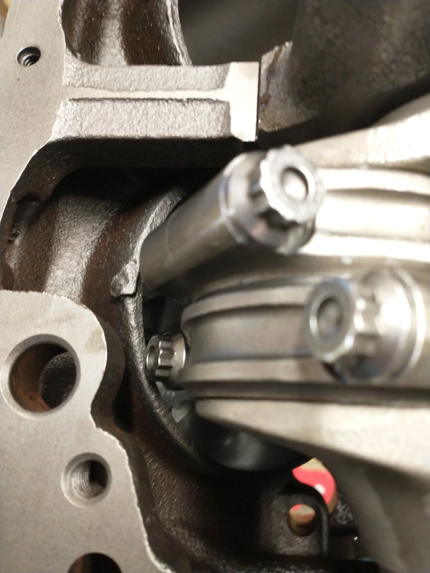

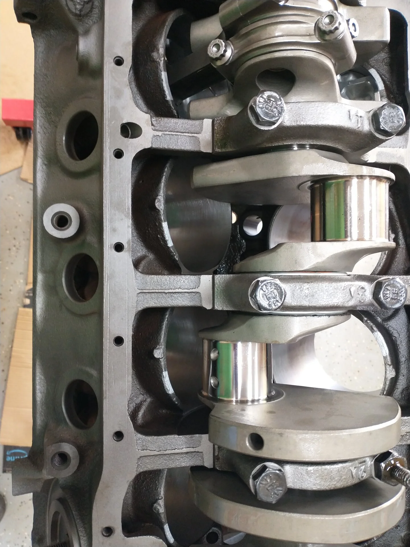

So today I got the block on the stand and the crank and (2) piston and rods put in to see if the block needs to be notched. Short answer is yes it does need to be notched as the rod bolt hits the bore. Not by much so it should be fairly easy to mark all the bores where it needs to be notched. Then I can take everything back apart notched each bore with my carbide bits, clean the block of the shavings, and reassemble to make sure everything is good to go before taking back to the machine shop.
Time for the pictures
I went through and installed rods and pistons into each bore marking the areas that needed to be notched on the block.

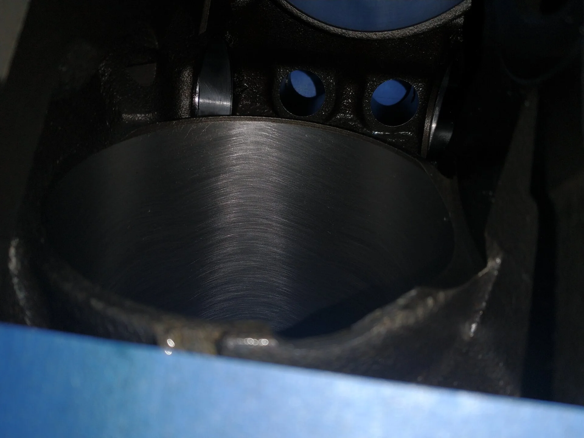

I then disassembled the entire block for grinding of those areas with a carbide bit on my angle grinder and smoothing it out with my dremel. I used a sheet to cover the whole block except the small area that I was grinding and then used a rolled up towel inside each bore. This helped when I ground each bore I was able to vacuum the area and then shake the sheet clean doing this for each bore. Don't have any pictures this time around as the block just got dropped back off at the machine shop. He said that it would be done in the next 1-2 days, so I should be able to go pick it back up before the weekend.

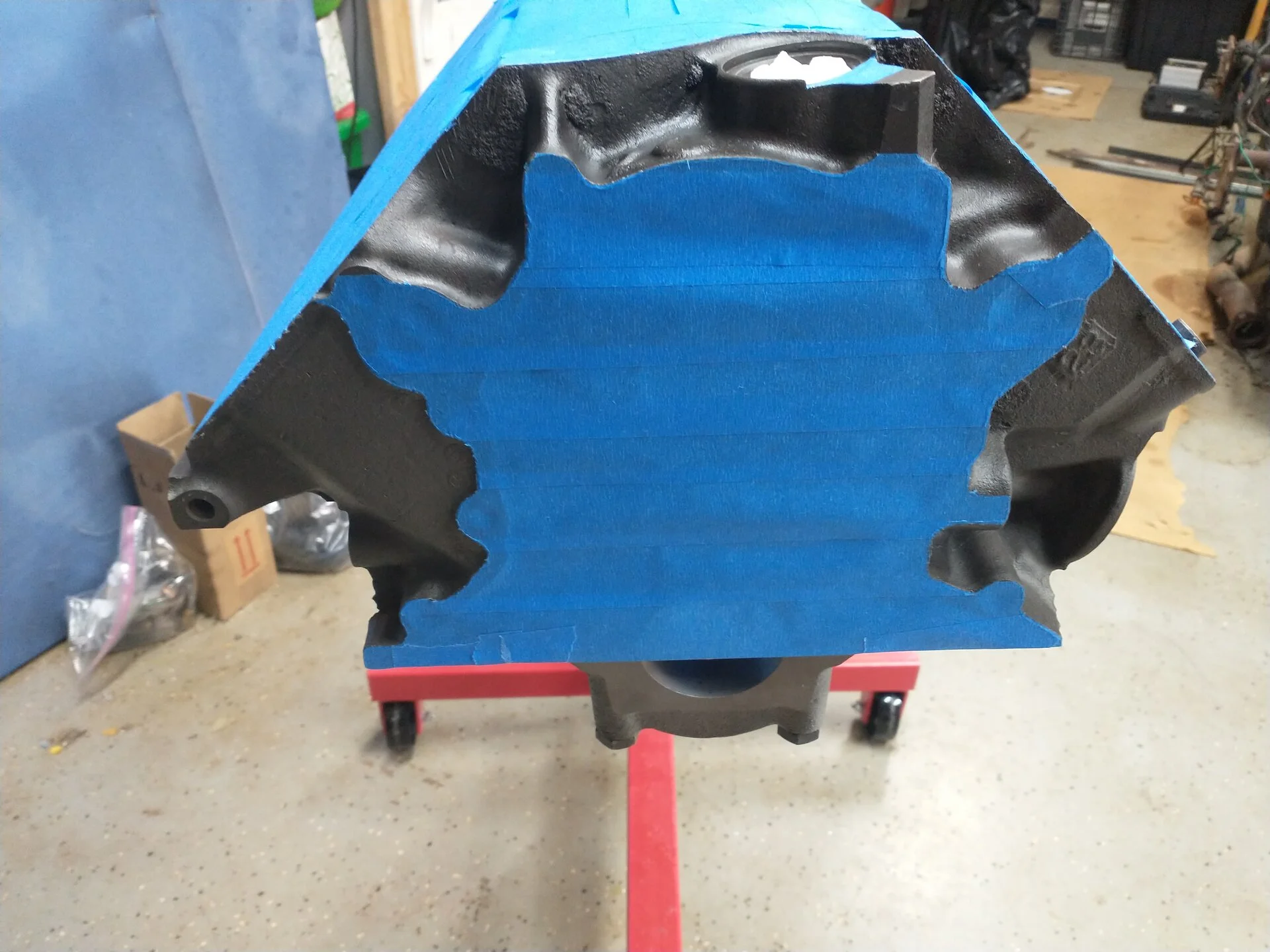

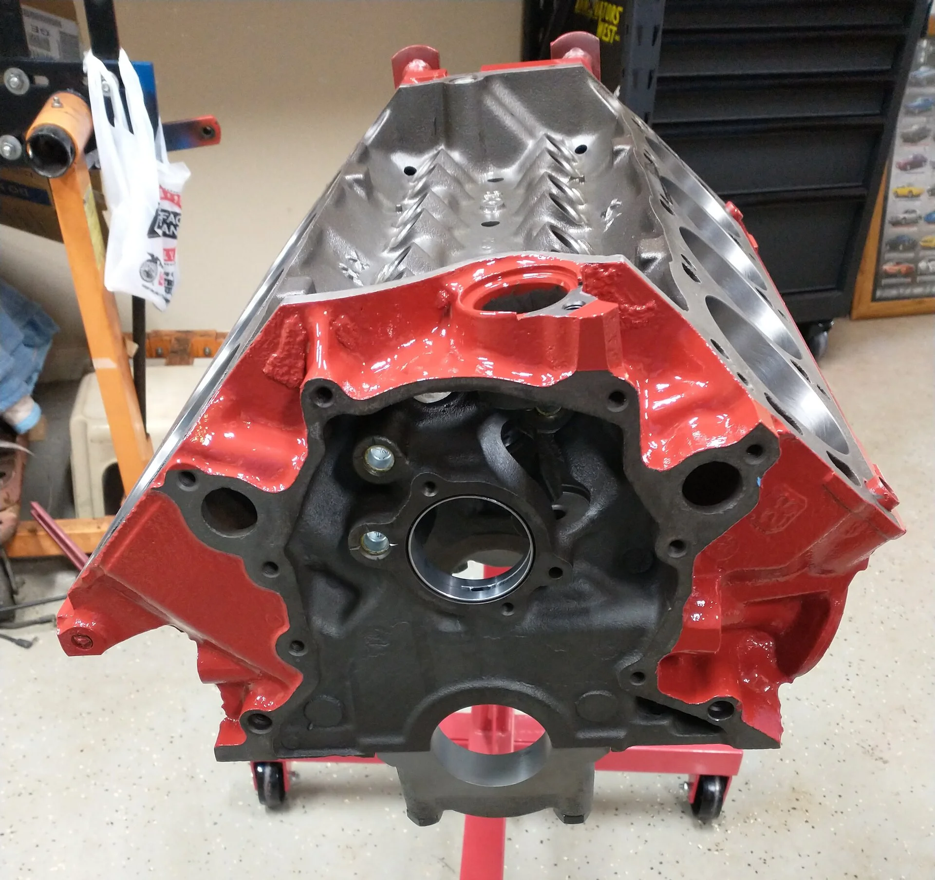

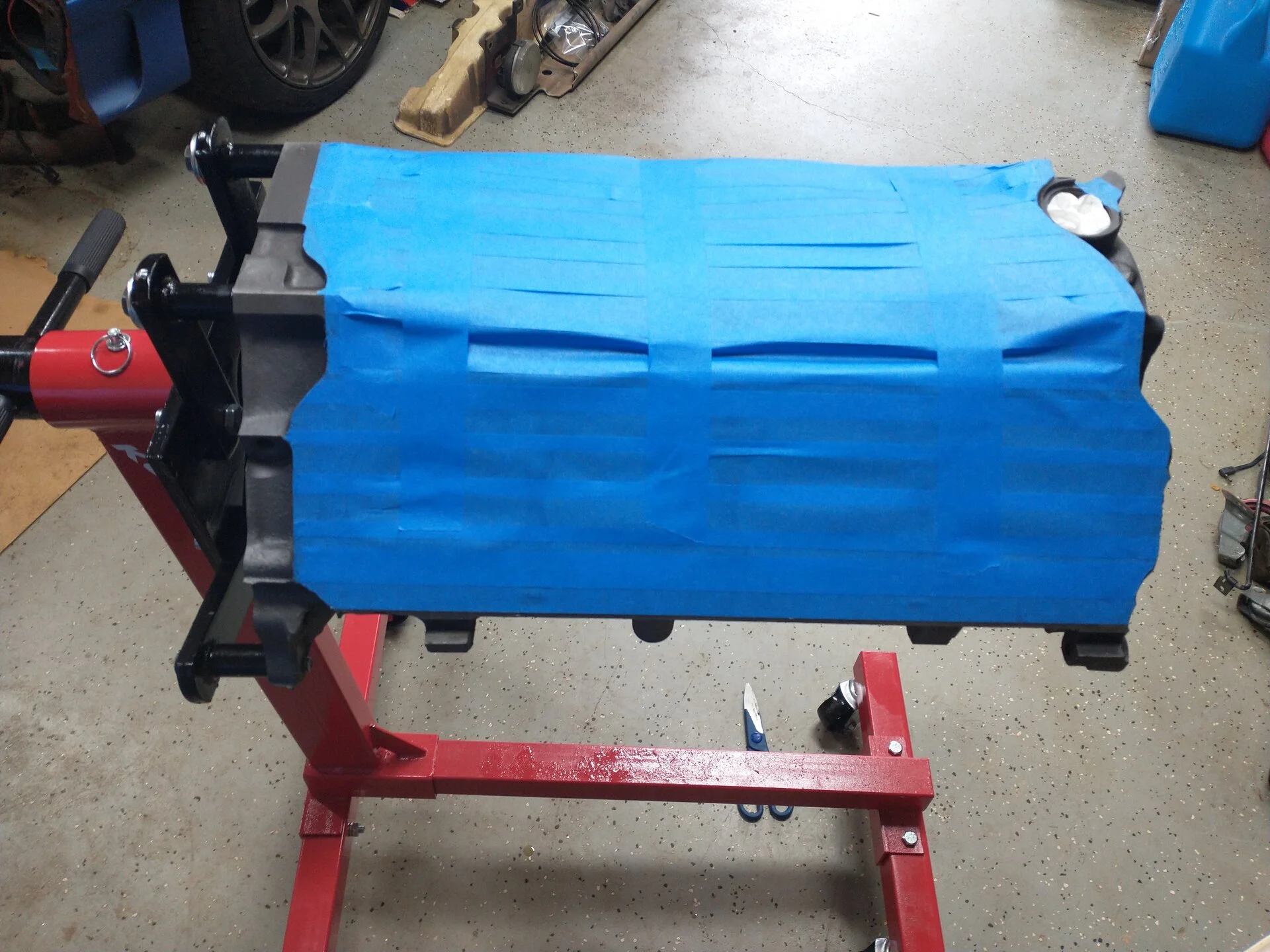

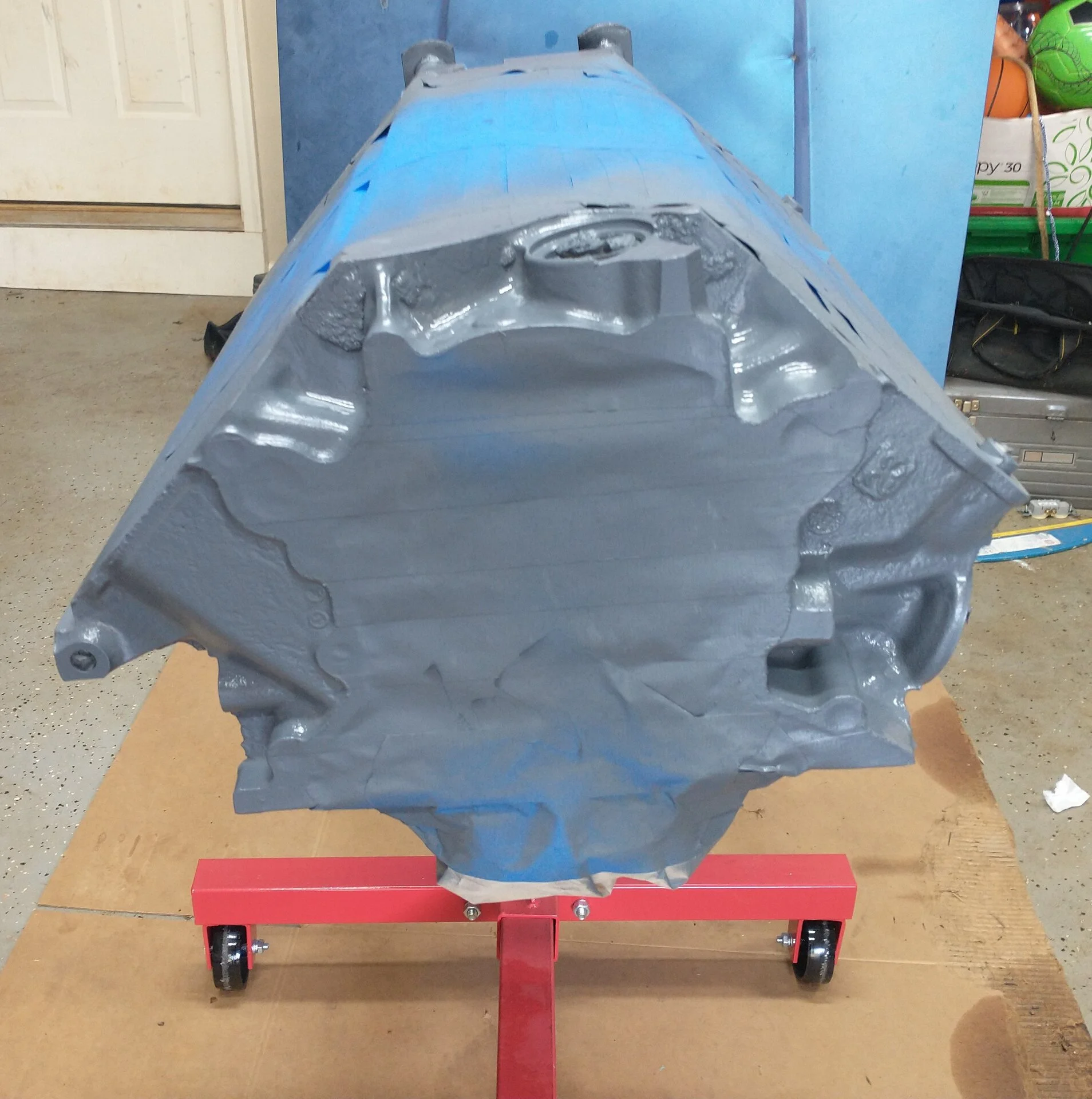

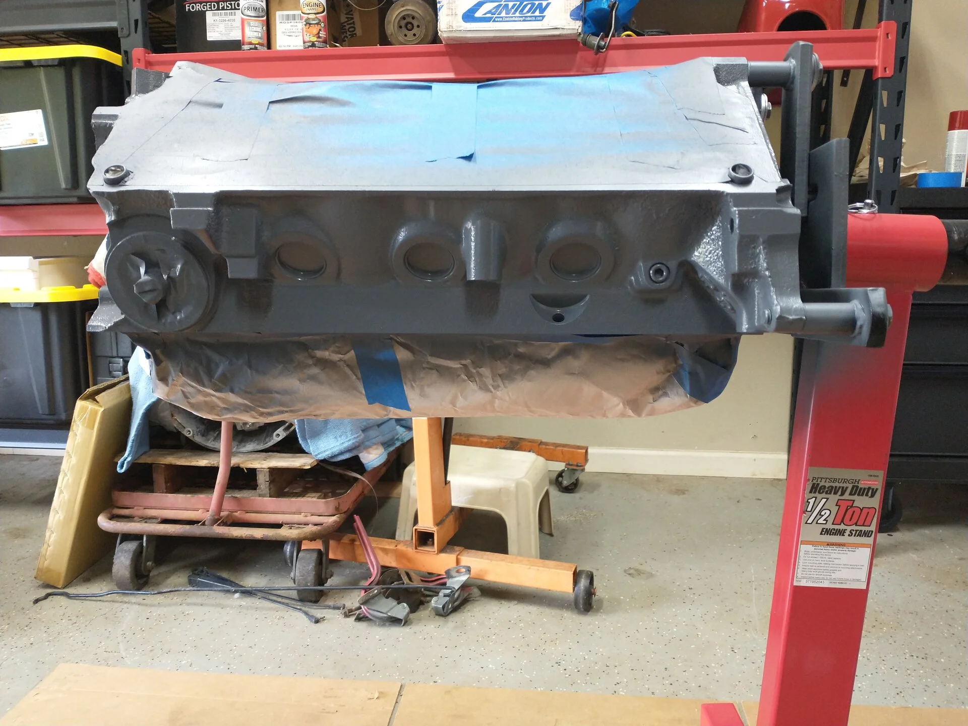

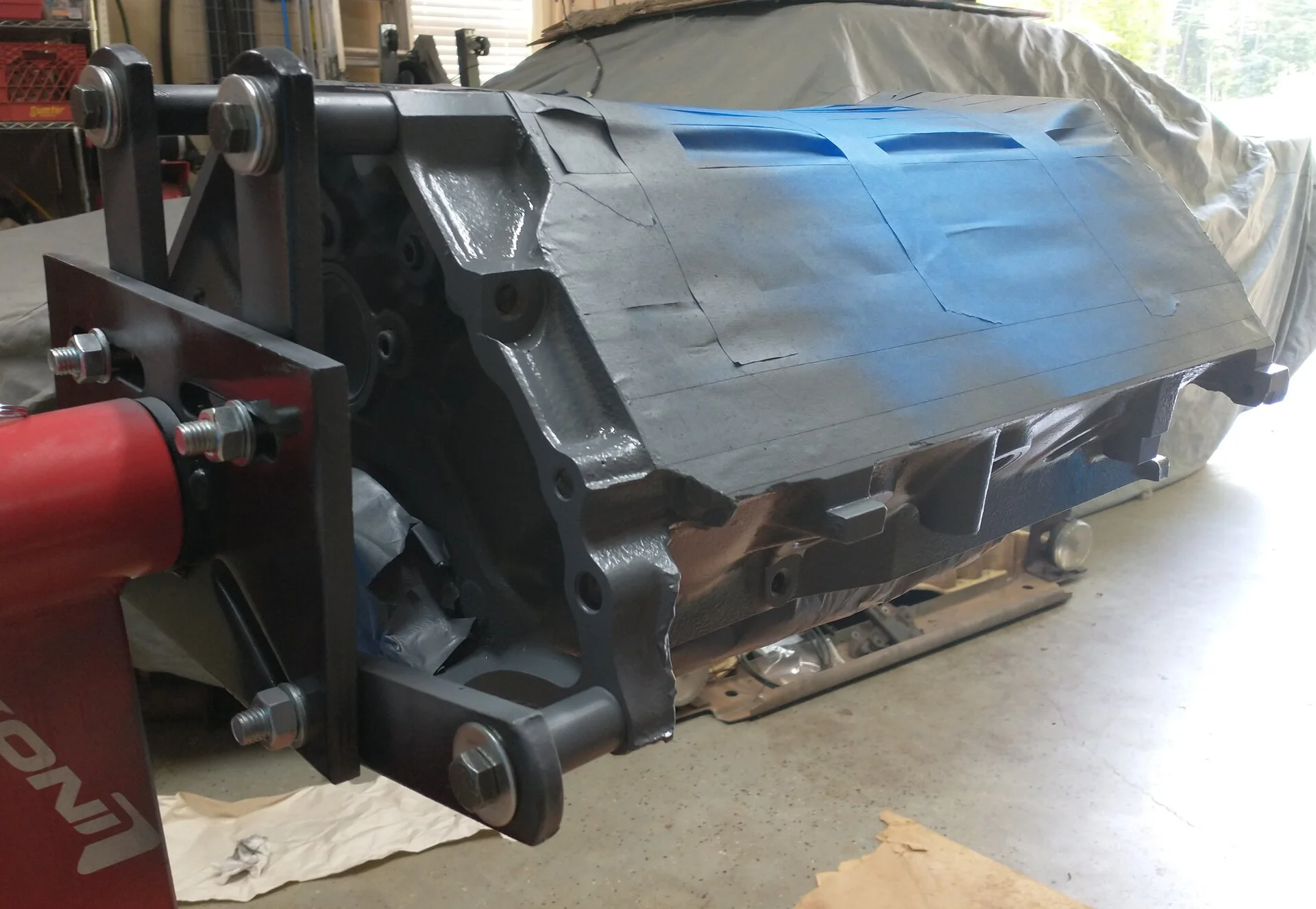

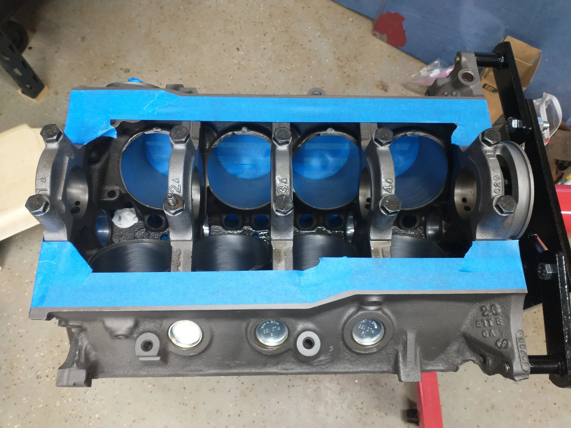

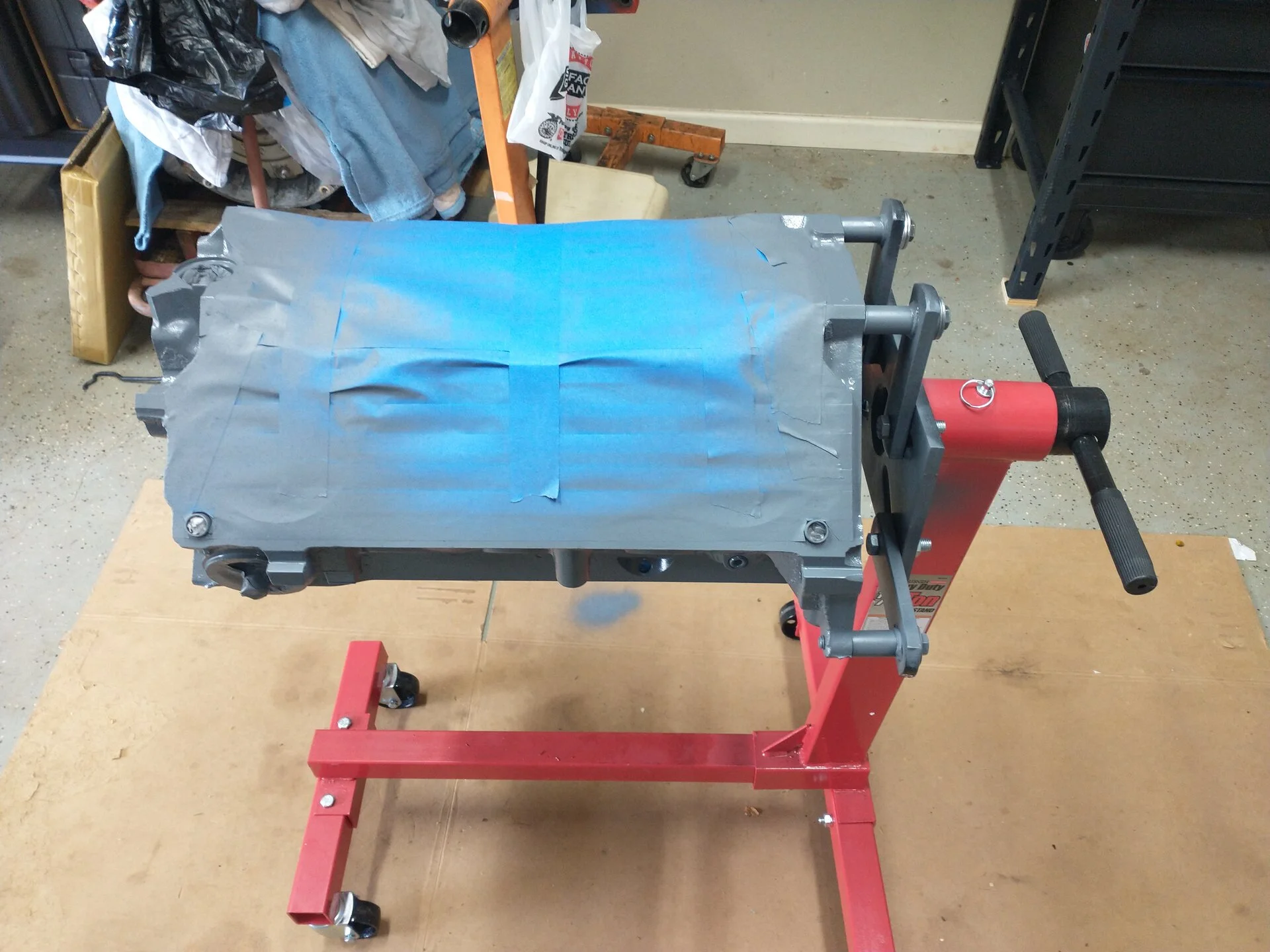

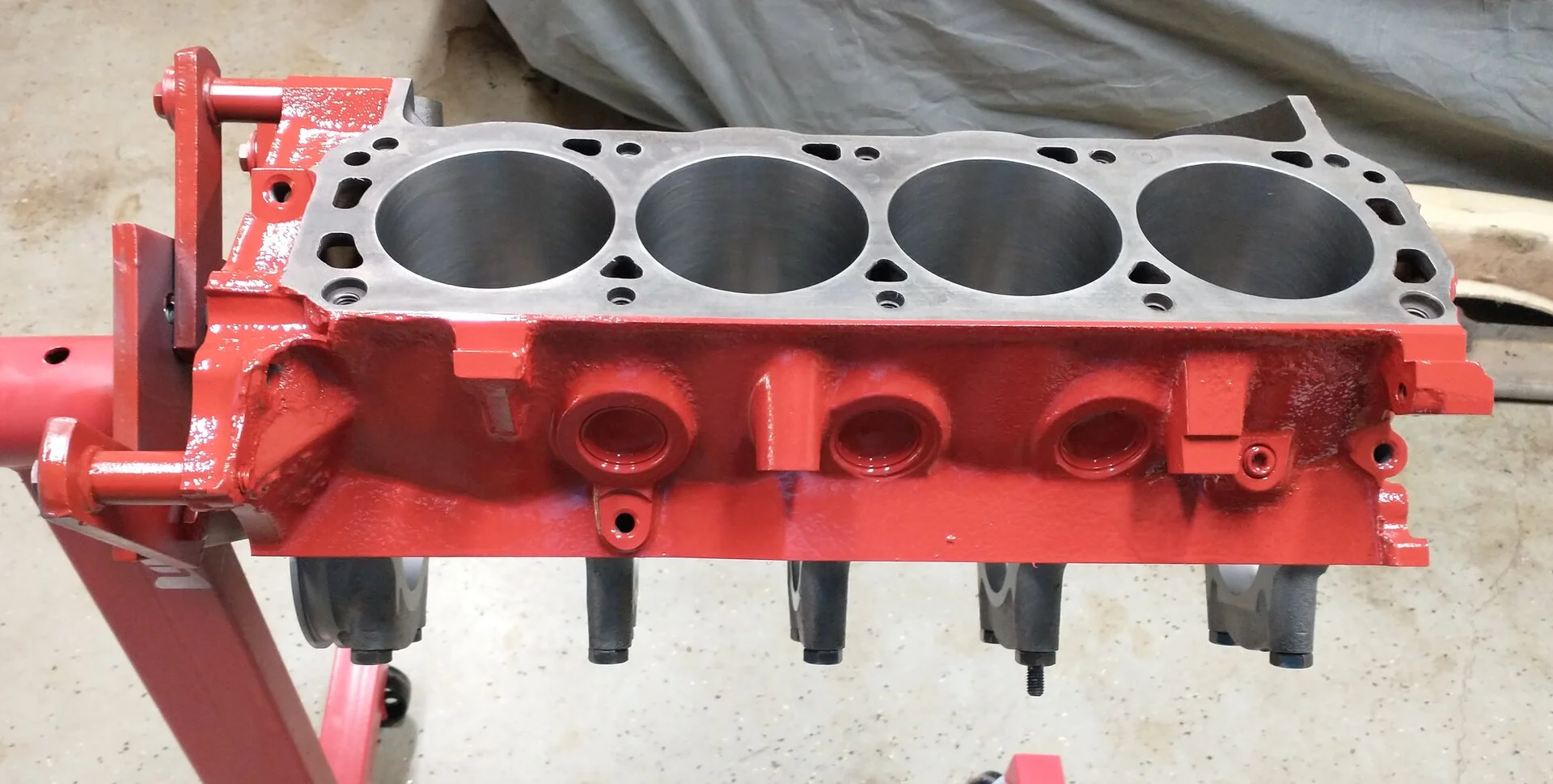

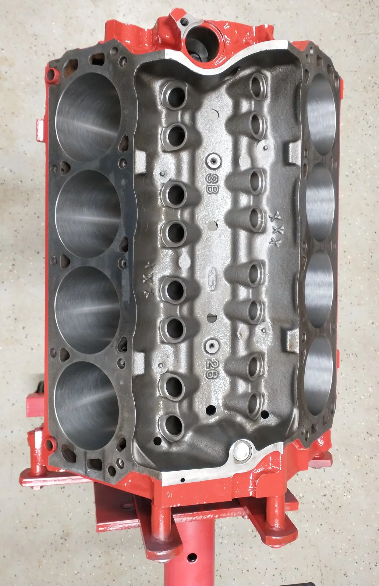

Progress is being made again, so I was able to pick up the block a couple weeks ago as planned. I now have it on the stand oiled, cleaned, taped with the a couple coats of high temp primer. I am waiting for that to dry thoroughly, so I can get the red paint on the block. I will then be able to start working on putting together the shortblock. Progress is slow, but are making movement forward.

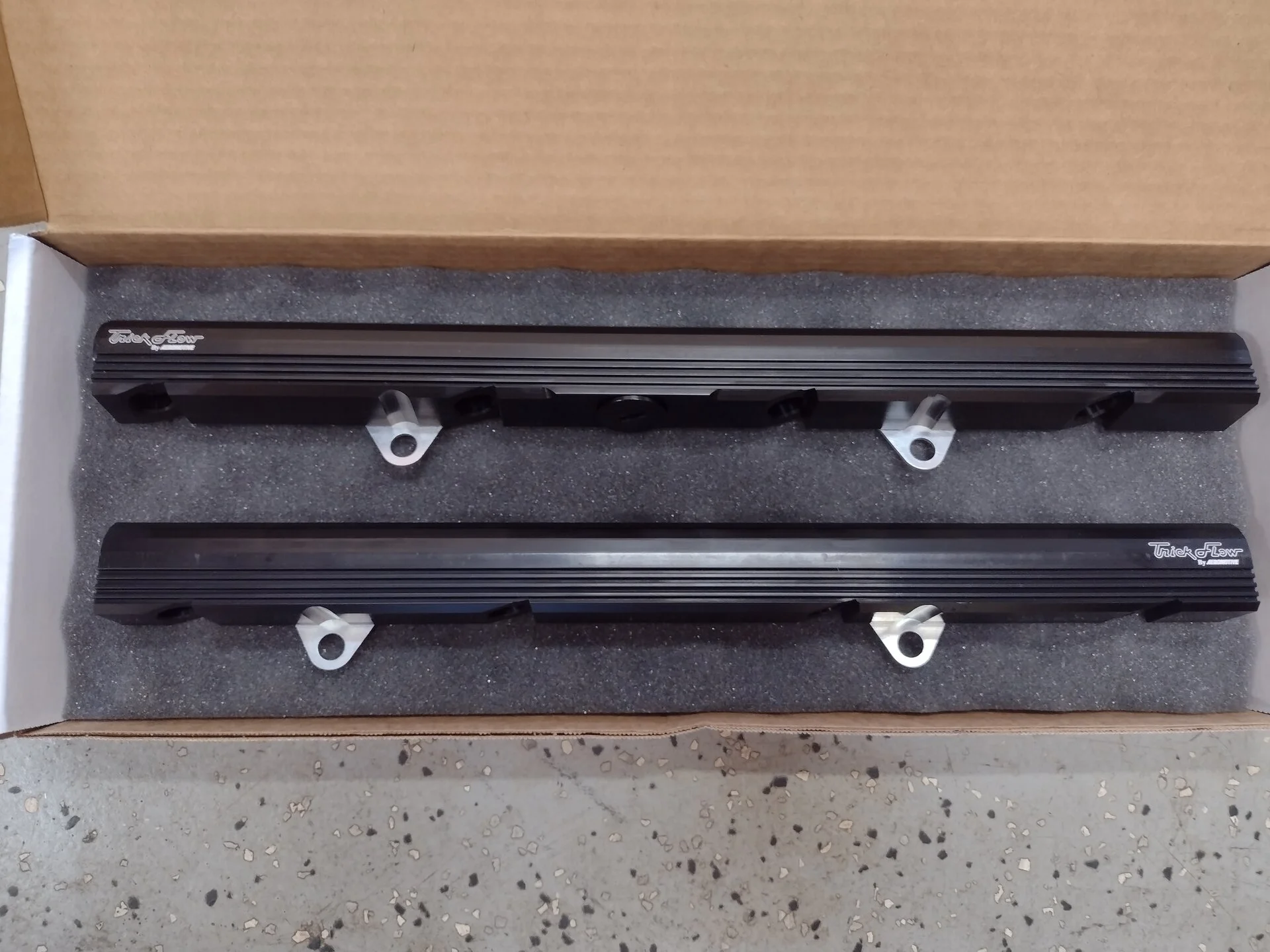

Going from stock fuel rails to these is a huge.... difference.

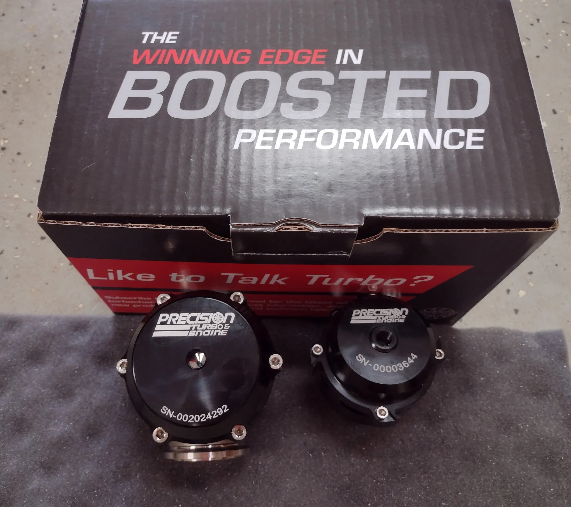

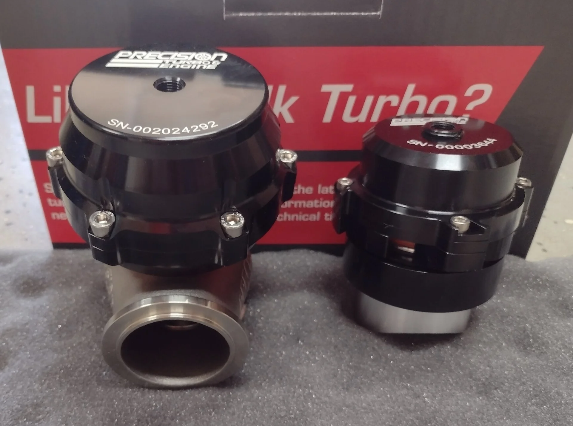

Then went with a 46mm Wastegate and a 50mm BOV. This should be more than enough for this combo.

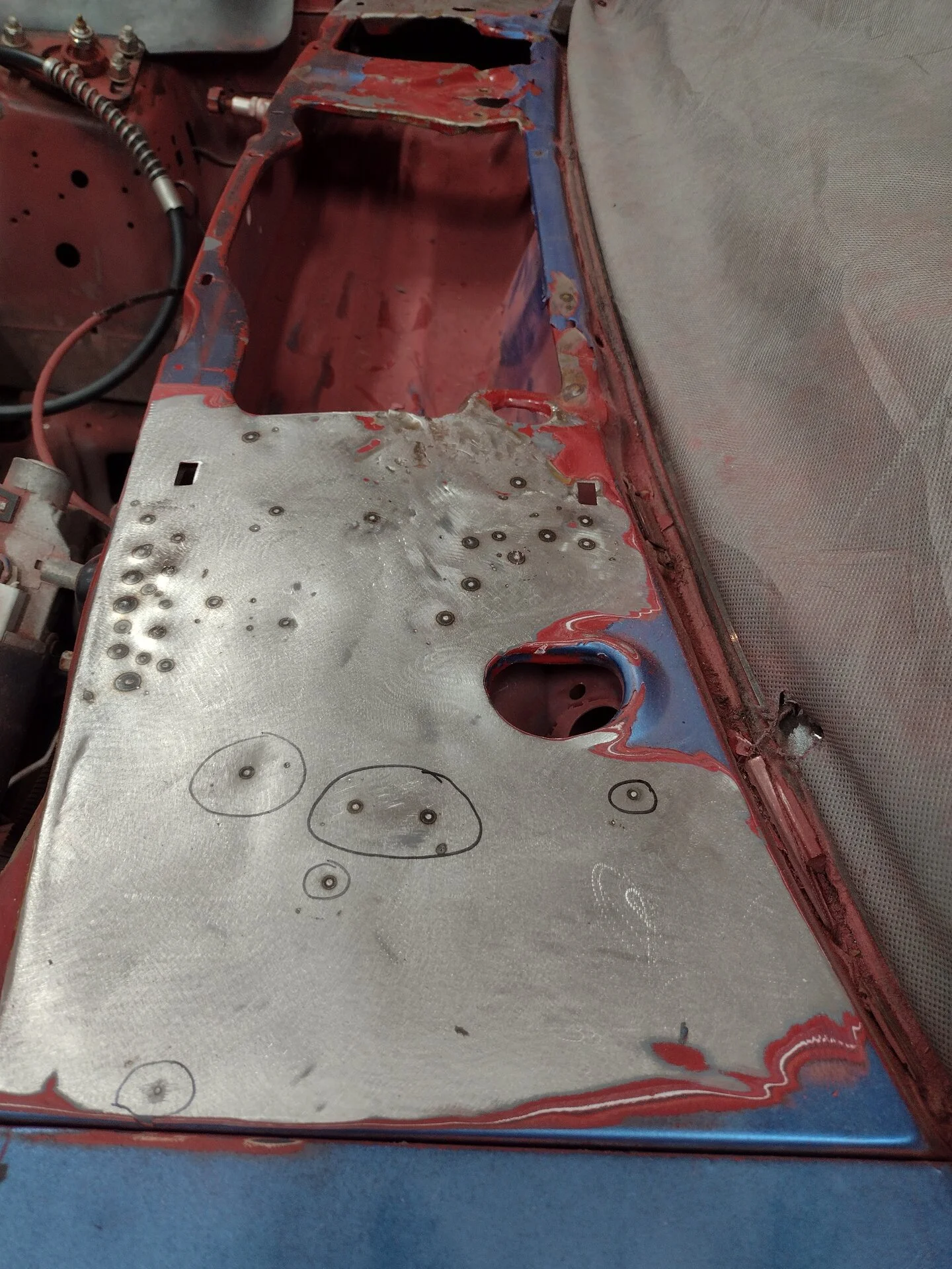

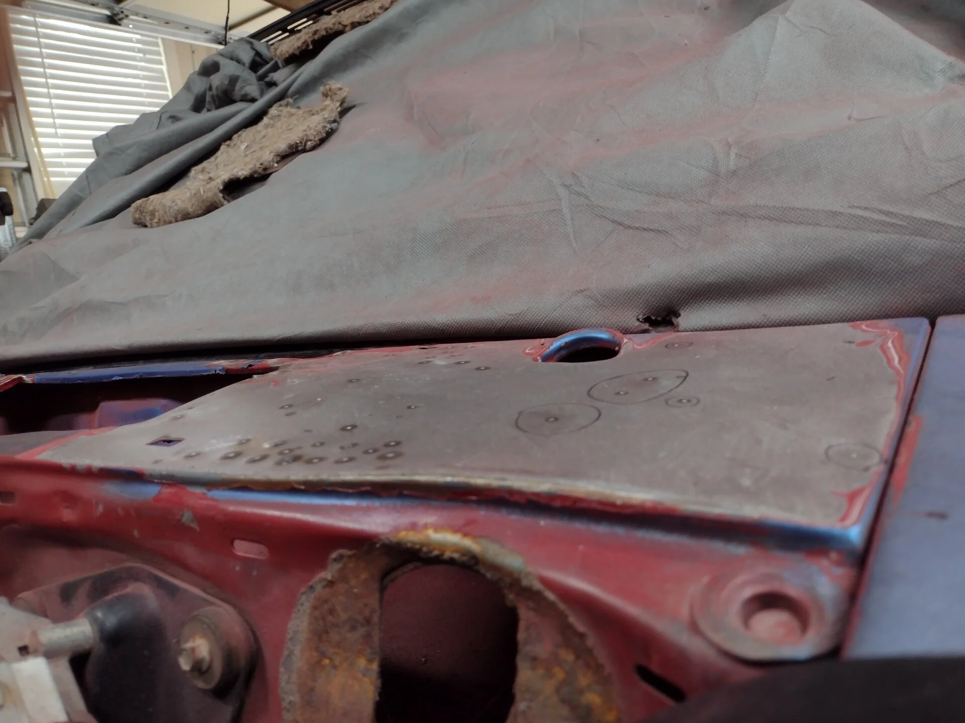

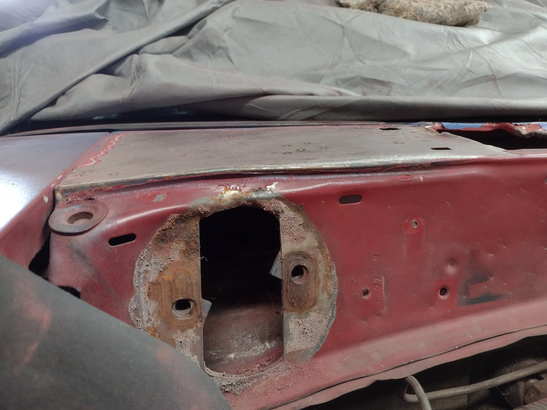

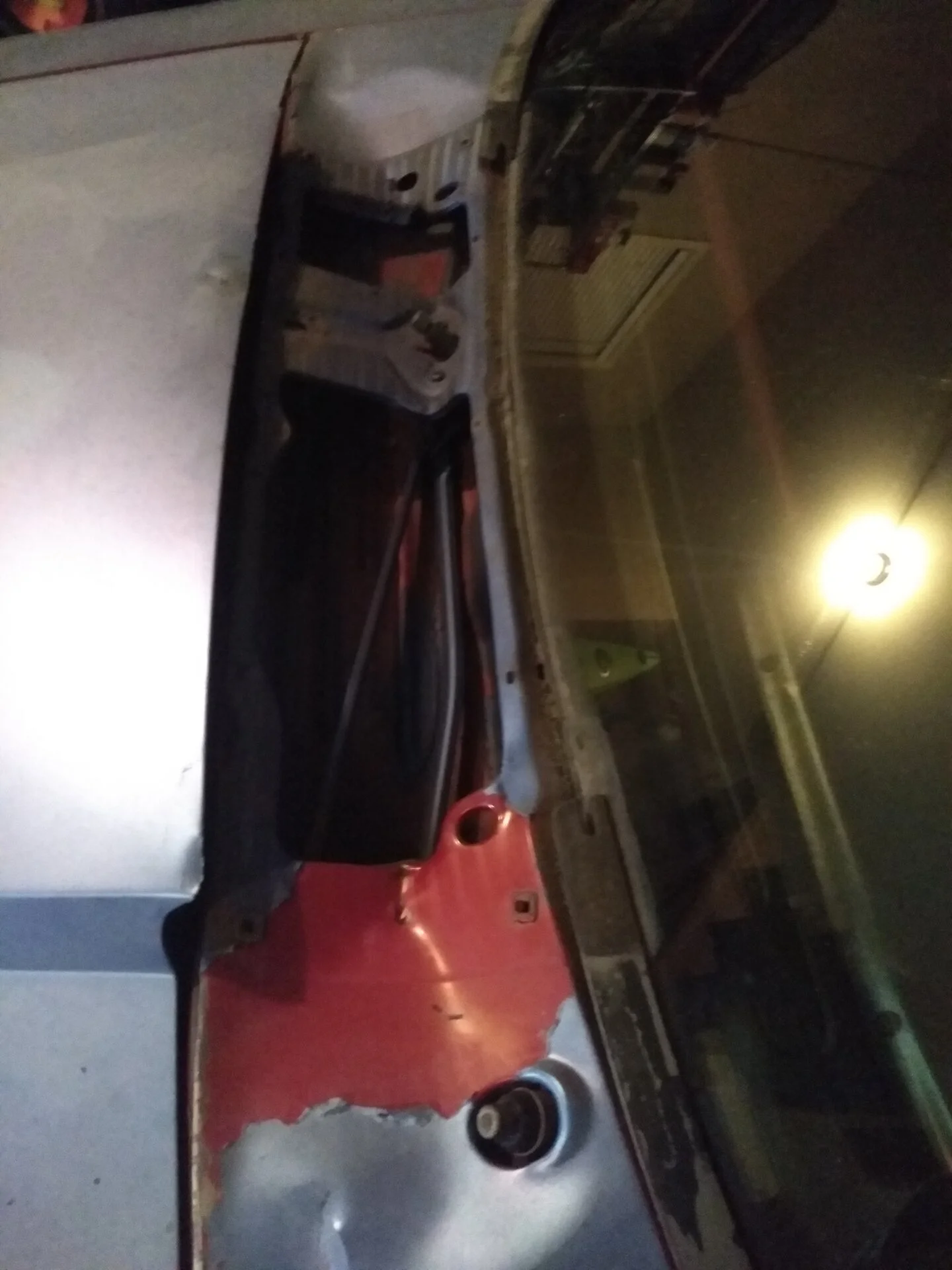

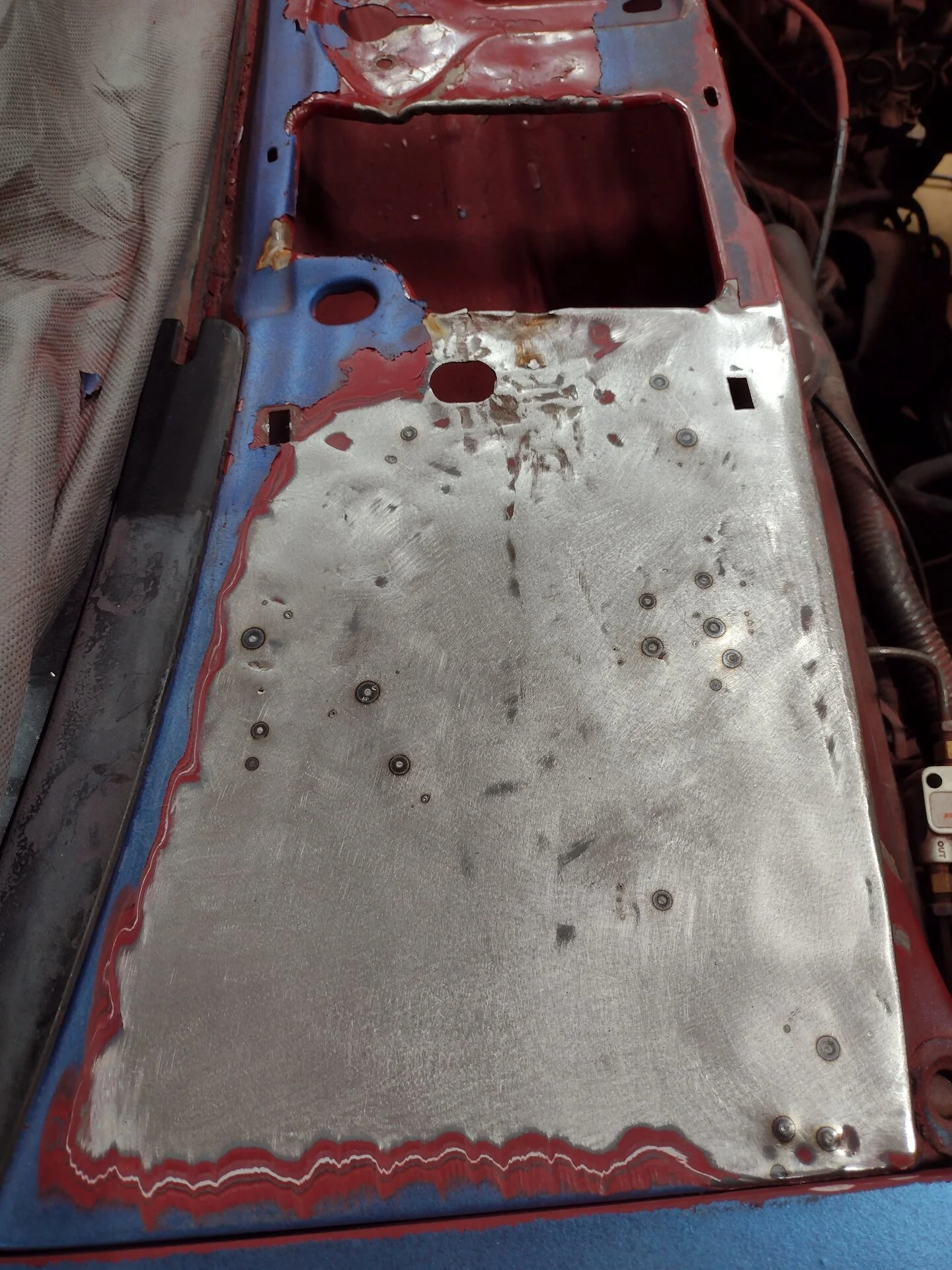

I have been making progress but very slow progress due to needing to tackle a section of the car that I have been dreading since its been parked. The hood flew up 3 years ago now smashing in the cowl area. I didn't want to have it all cut out and put in a new one as I knew that I could fix it. I really really hate body work due to being so slow at it, but in the end I do think that it came out pretty good. It doesn't have any filler on it which should flatten out the rest of the spots.
Before
After
