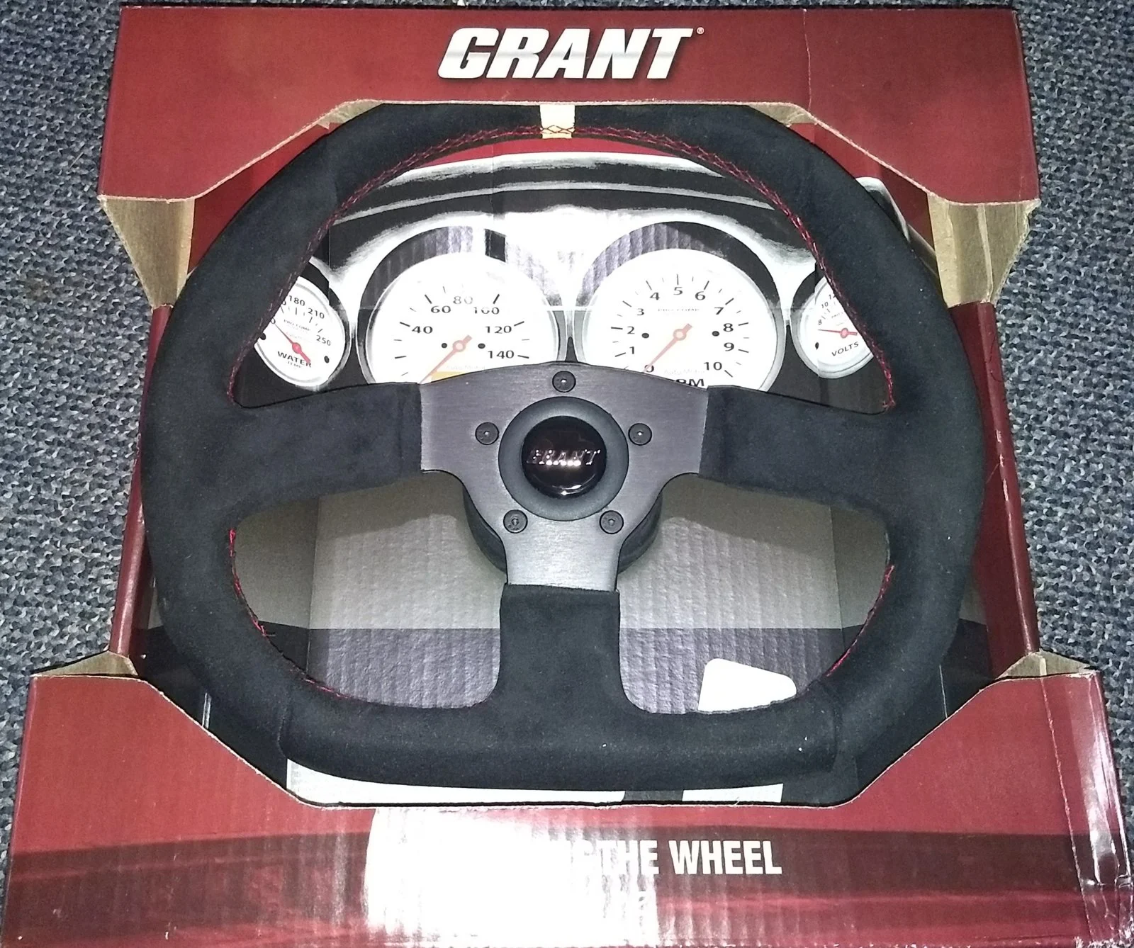

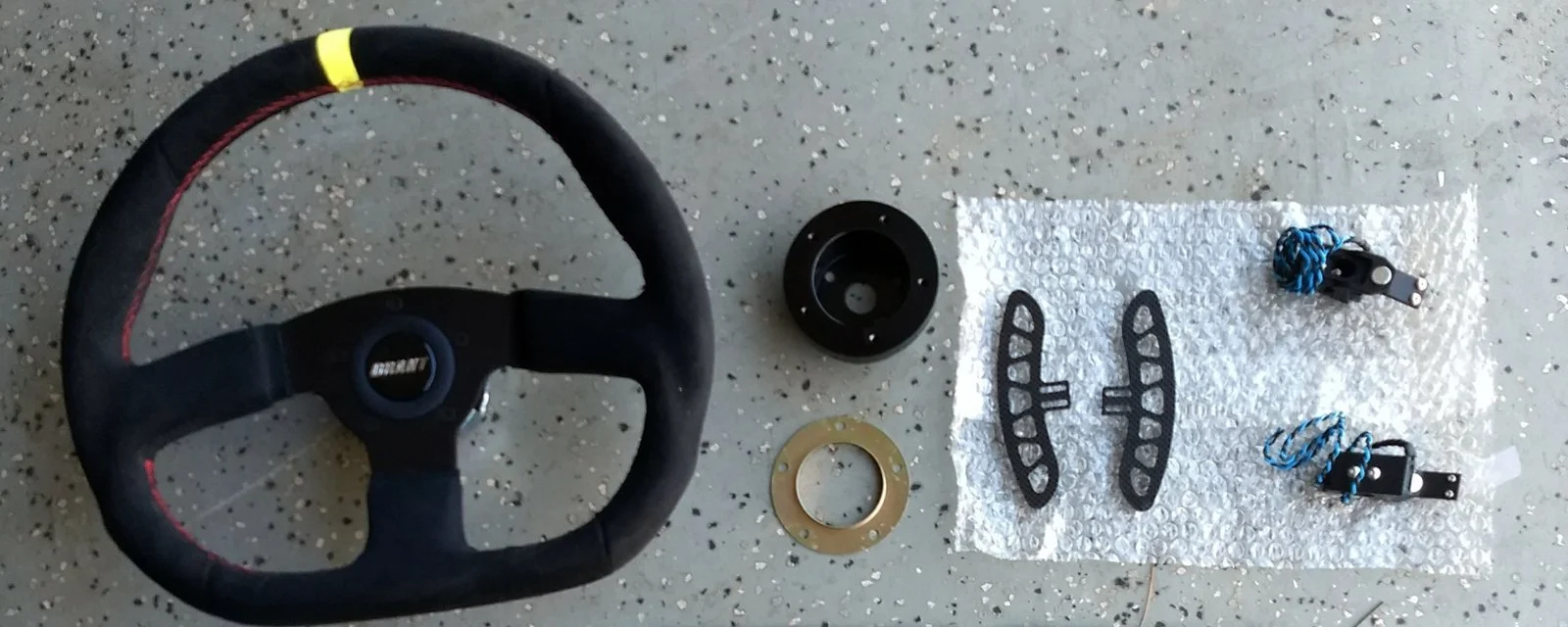

Got the last piece for the steering wheel project for the weekend. Hopefully get the adaptor built and everything mocked up.
Picture time:

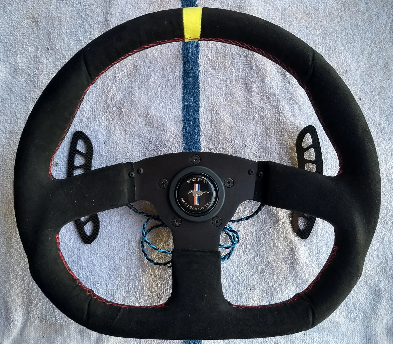

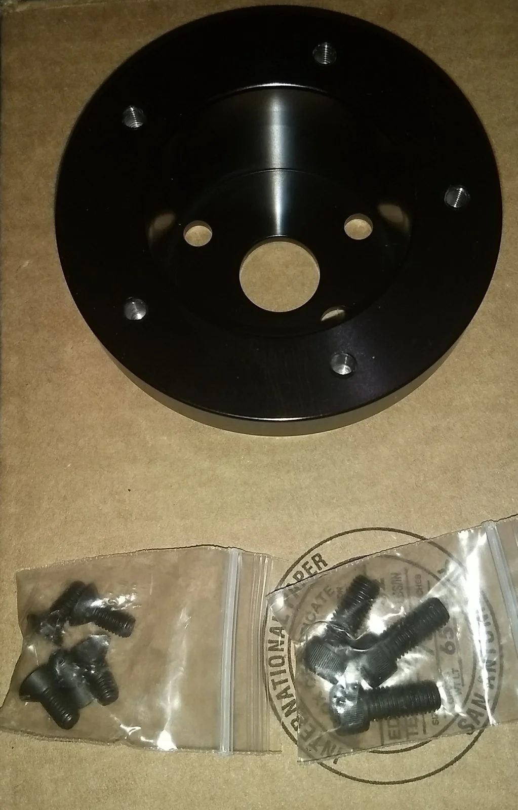

I got to work on the steering wheel project this weekend like I wanted. It also took a LOT longer than expected as well. I started with Version 1 that consisted of a bracket to mount the paddle shifters to, and then sandwitch that between the adaptor and the steering wheel. Well, after I got the thing made and test fit it I noticed I could just mount the paddle shifters directly. This started Version 2 and drilling the steering wheel for the 4 bolts that mount the paddle shifters. I noticed I needed a small spacer between the steering wheel and the paddle shifter due to the grip padding. I drilled the holes and cut the spacers and test fitted everything. After the paddle shifters tested fit worked I took everything apart and painted the bolt heads and spacers black to match. Once it all dryed, I reassembled it all back together including the horn button bracket and horn button. I still need to drill the steering wheel adaptor for the paddle shifter wiring, but will be another day.

Since I can't drive a manual anymore due to my knees I decided to go this route to still have the shifting gear effect. I am super excited about installing this on the car, and it looks awesome in my opinion.

I also have in the mail a new Grant Steering Wheel Installation Kit, so I can start on the process of modifying the hub to except the horn and paddle shifting wiring.

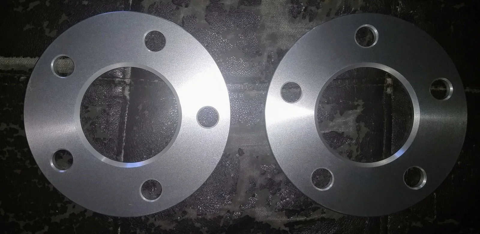

Last, I have in the mail a pair of 7mm hub-centric wheel spacers to help correct the inside of my wheel scrubbing on the front lower control arms. The S197 wheel spacing pushed the rims to far in, and they need to come out just a little bit.

I run half inch hub centric spacers on the front of my car with longer hardened Moroso wheel studs. My wheels are 50mm offset.

I got in the mail my wheel spacers. Really nice looking for some cheap eBay spacers. I like getting parts from smaller companies especially since they were only $26 for the pair. Just for others that maybe looking for spacers the bolt pattern is 5 x 4.5 with a 70.3mm CB (Center bore) as there are different hub center bore sizes for cars.
Did you not get the hub-centric spacers or is the boss on the other side?
