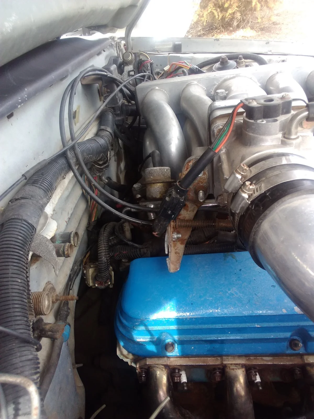

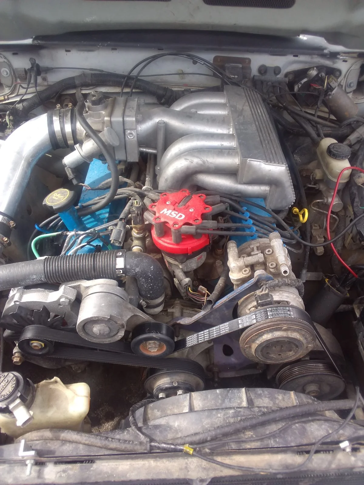

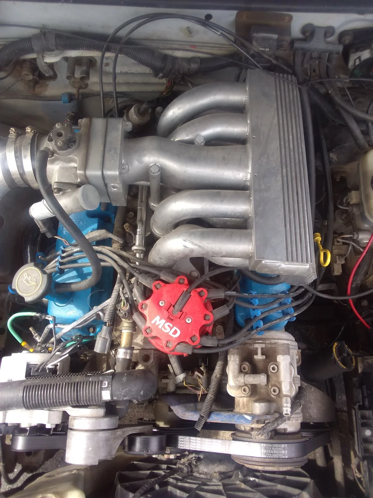

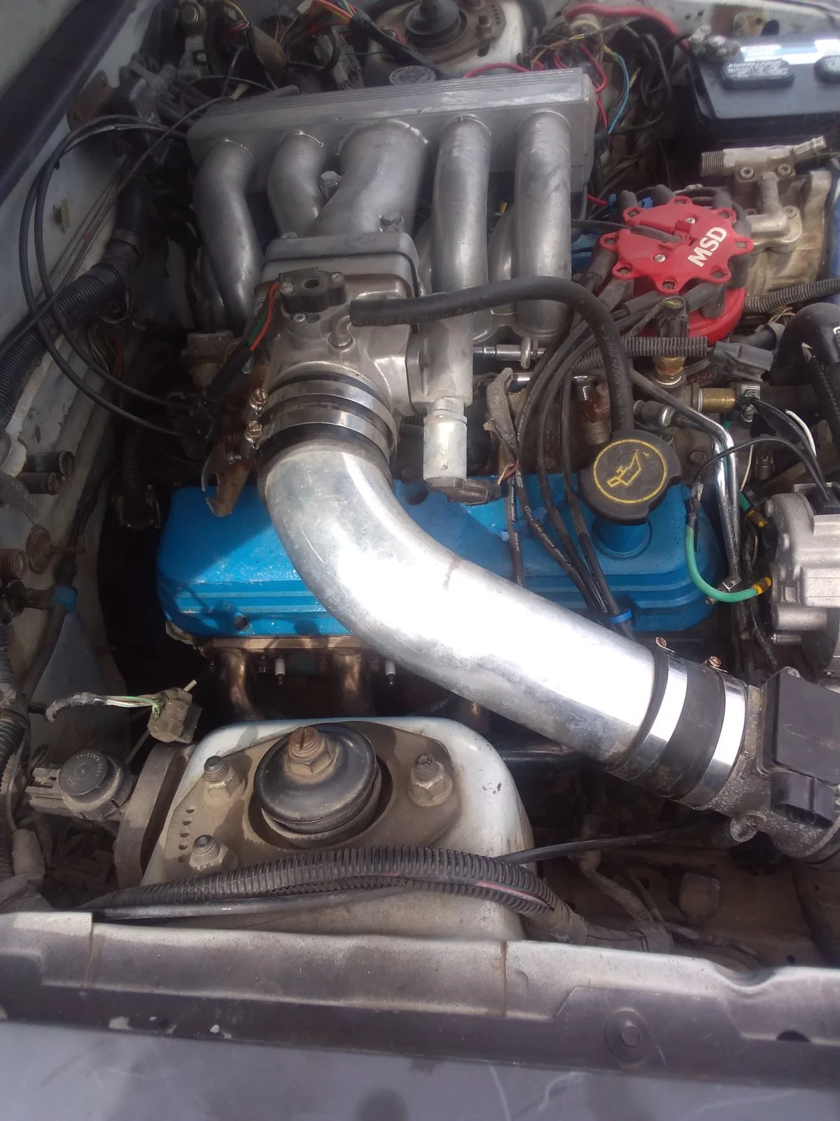

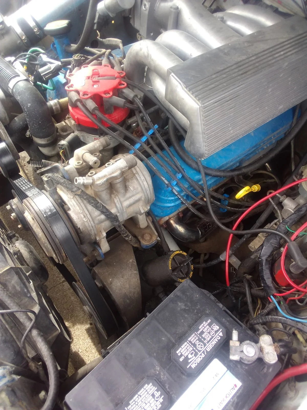

Ok I got some pics and the guy said 30000 miles on the rebuild. The bottom end wasn't touched. So I'm assuming he meant the top end it's basically built. But there's 150k+ on the cluster
