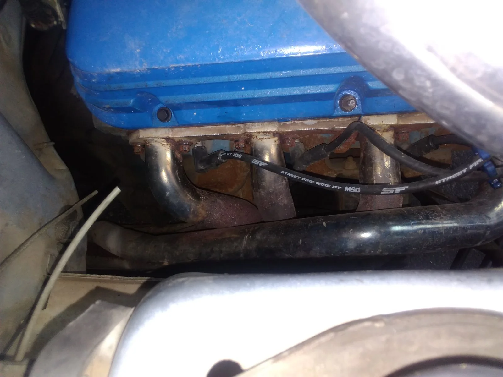

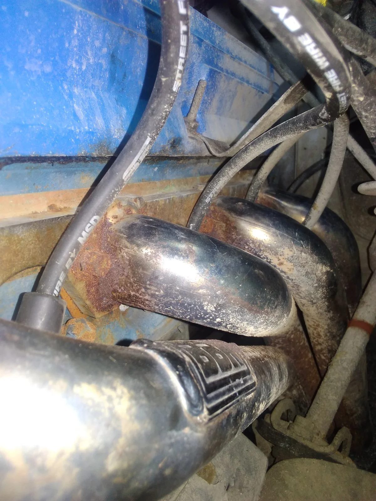

Posted a couple Pic’s of GT40P’s, BBK non GT40 headers. Zoom in & see if it looks familiar.

Hey man, with the header set up in the photos I can barely see them. But thank you for the photos. I have an issue where I'm getting a high rpm misfire. It only happens when I really get on it like 3 grand rpm and up usually between 4k and 5 k rpm. Trying to see what my plugs look like maybe I'm leaning out?
