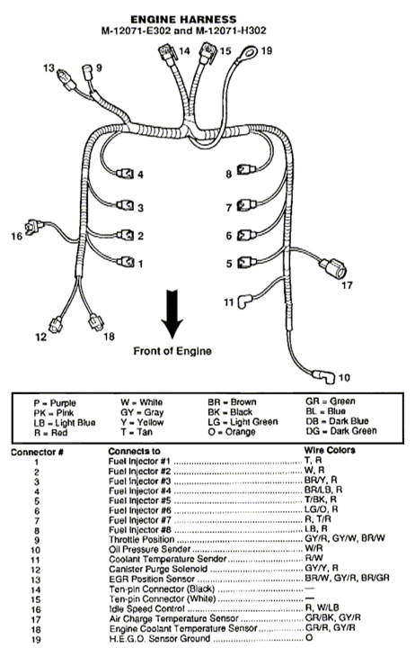

I bet it's the orange wire on the firewall. Make sure it's connected as its a ground for the 02 sensors

I'll check it out tonight . Where on the fire wall is it? And is it possible that the o2 sensors the selves are bad? The car has 152,000 miles.

It would be #19. Make sure the connection is not broken
Also 44 and 94 are hego codes for left and right 02 sensors. I would check the spark plugs then o2 sensors then #19 wire
