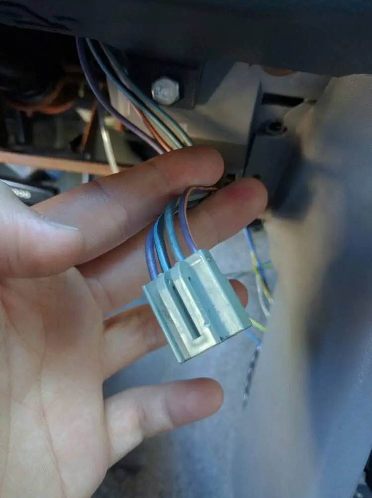

The only thing that I can go off of is that there is this harness with the same flasher wires that was poking out of the bottom of the dash. I had not noticed this before taking apart the instrument cluster. I will include a picture below.
My question is, does this connector have anything to do with the turn signals? And where should I begin trying to troubleshoot this damn problem?

The turn signals also have a regular type fuse too. (not cylindrical) The cylinder pieces you say you changed are flashers, not fuses. Check a fuse box diagram for the location of the turn signal fuse and check/replace it. It's common to blow fuses when messing around under the dash.
I cant identify the harness you show in the pic. Sorry bout that

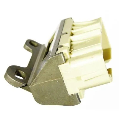

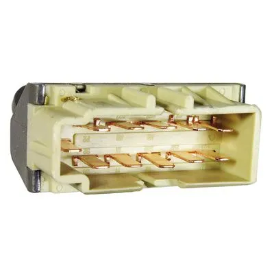

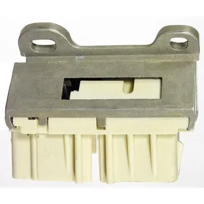

The ignition switch is also known for creating turn signal problems. Make sure the ignition switch and wiring are in good shape as a first item to check. This is especially true if you are having problems with things like the radio and heater/AC blower.
Ignition switch wiring
Some of the symptoms of ignition switch problems are things that don’t work or are intermittent like radio, turn signals, wipers or heater. The auto parts stores sell the switches for $13-$15.
While you are working on the switch, check the wiring and connector closely. A replacement connector with new wiring pigtails is available from most auto parts stores
AutoZone and Advanced Auto Parts have the same Part Number: 434 - may have to order, not always in stock
Advanced Auto Parts alternate part number: PT5534
If just the plastic shell is broken, a small jewelers screwdriver inserted from the front will release the contacts from the connector shell. Do this one wire at time and insert the wire and connector you removed into the same position on the replacement connector shell.

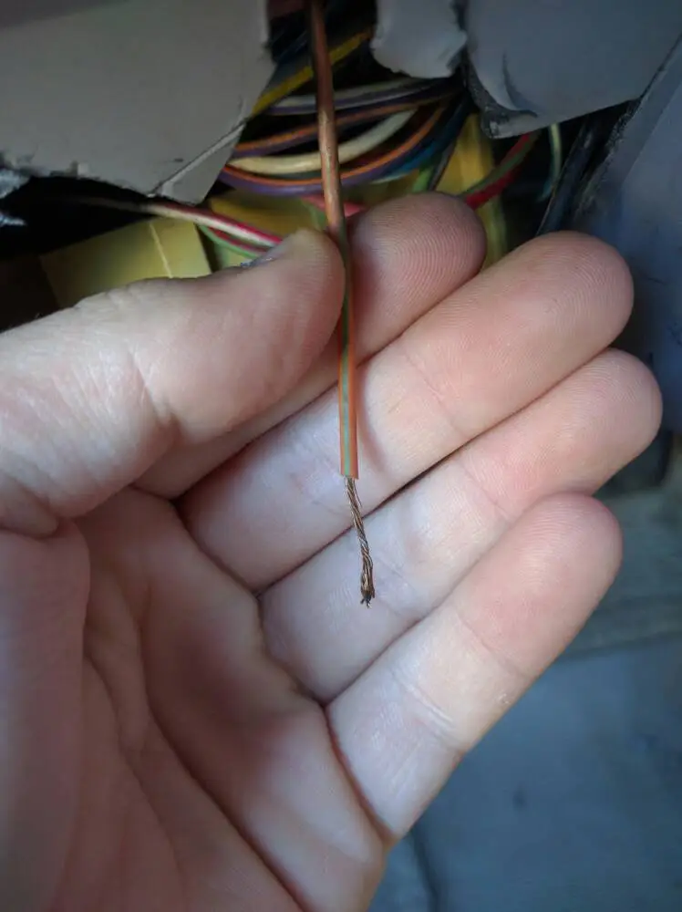

I just found a loose hot wire hanging near the back of the fuse box. Looks orange and green. Is this the red/Lt green wire?
Sent from my Nexus 6P using Tapatalk
Compare it to the other wires with either a red primary color or stripe.
That may be the missing hazard flasher power wire...

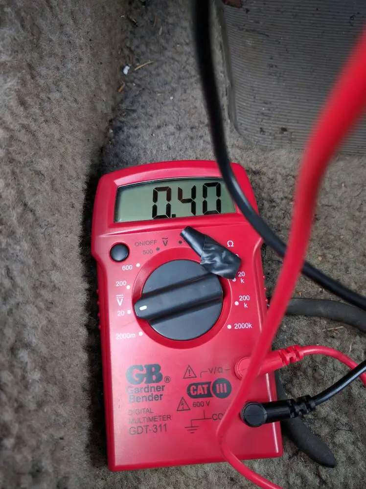

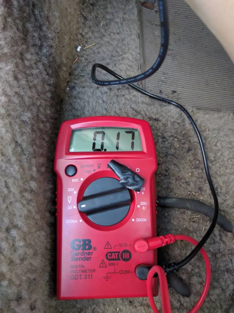

I don't have 12v on those two fuses. I found out that the #8 fuse wasn't even in. I replaced that and now the key chime is back, but still no turn signals. Pics of multimeter on #5-#8 fuses respectively.
If you were to re-read my previous posts, you would find out that no 12 volts at fuse positions #5 & #8 with the ignition switch in the Run position meant a bad ignition switch...
Fix that first and maybe the chime problem will get fixed in the process.
Recall on Ford Ignition switches:
Revised 7-June-2014 to add Torx bit picture and source. Also added replacement ignition switch wiring pigtail picture, part numbers and sources.
There was a FREE recall on Ford ignition switches. They overheat and sometimes catch fire. That burns up the steering column and sometimes the car interior. Since this is very old information, you may not be able to get the switch replaced for free anymore. The auto parts stores sell the switches for $13-$15.
Saleen0679 was nice enough to dig this up for us awhile back: Replace a 1979-1993 Ignition Switch Assembly
Torx bit set from Advance Auto Parts
Autocraft torx bit set – have small hole in tip for tamper proof screws.
Part No. AC571/W1386 Cost approx. $12 +tax
Diagrams courtesy of Tmoss & Stang&2birds
