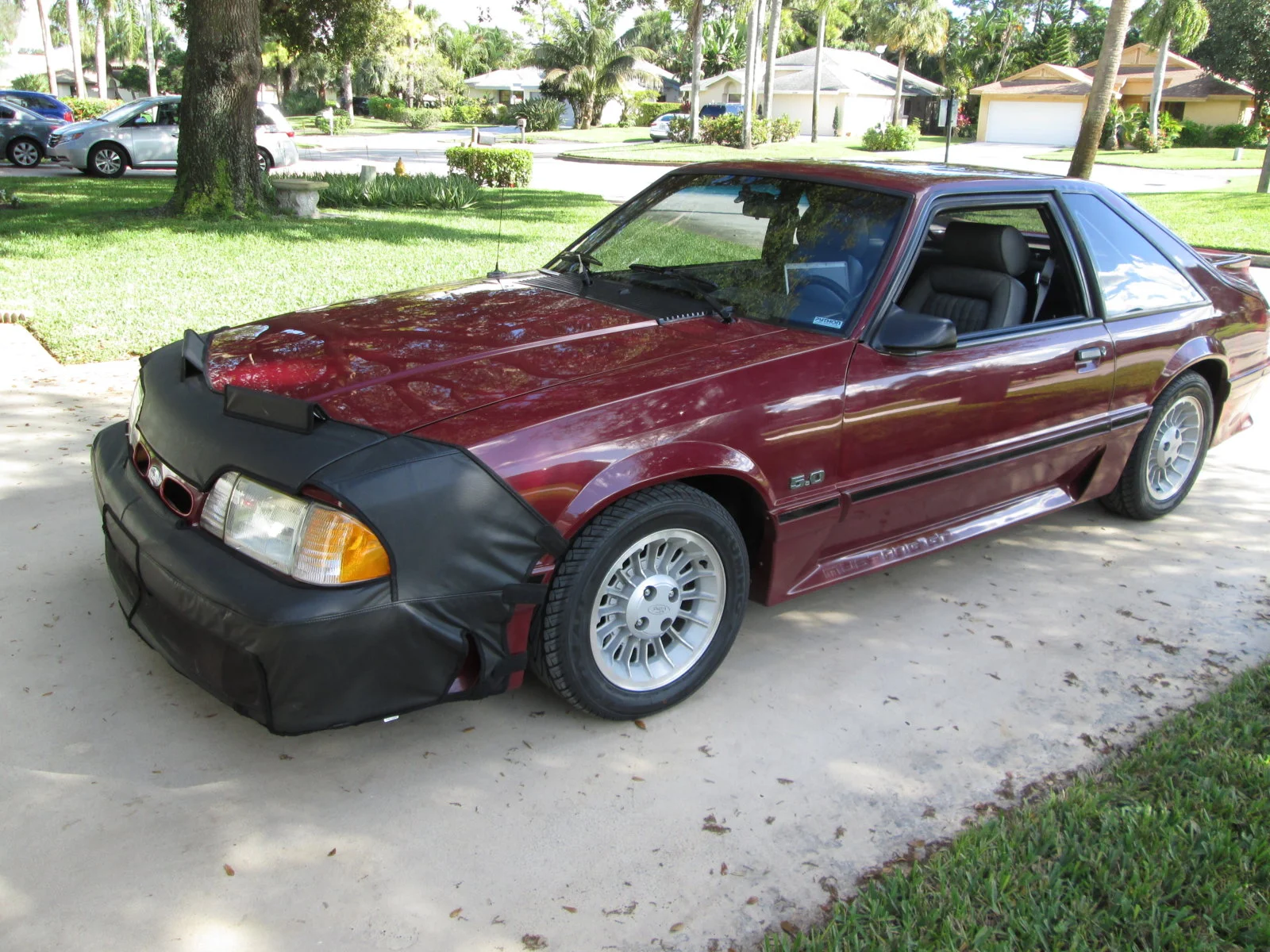

I put these on my turbines.
https://www.tirerack.com/tires/tire...5HR5EAST&vehicleSearch=false&fromCompare1=yes
Kumho Ecsta AST - Size: 225/50R15
