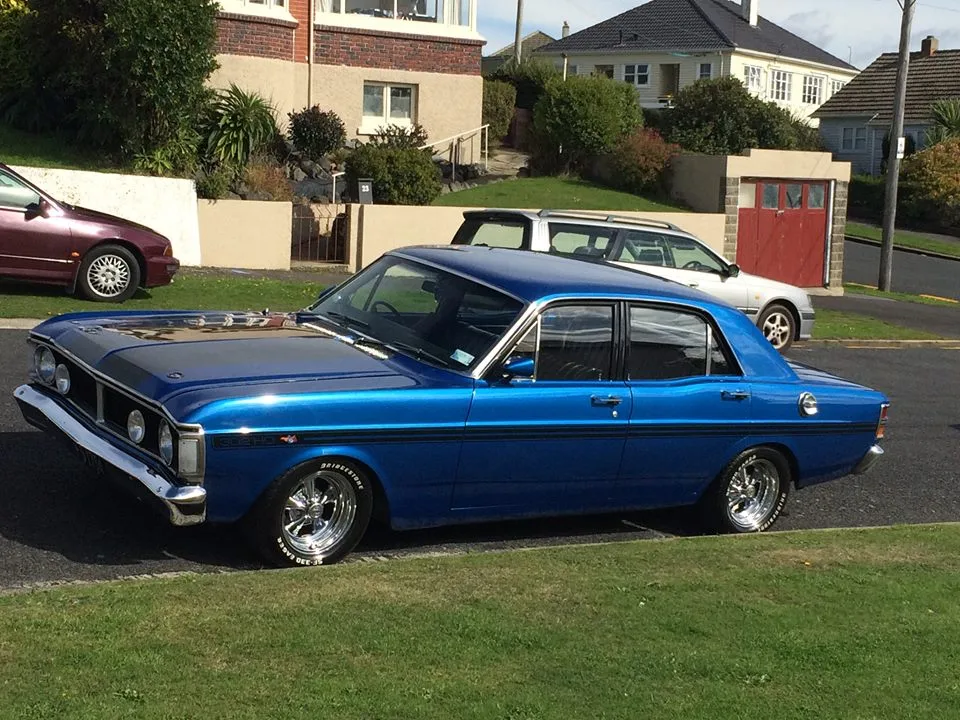

Hi
Im new to this forum and not sure if im posting in the right place, my car is having issues when starting cold day or night. its idles rough and smells really rich white smoke but fine after 5mins.
I have it at the auto electricians and they seem stumped the bill is adding up, they tell me all sensors are working correctly but the injectors seem to be surging during start up 4 to 10ms I think they said they seem to think it maybe a be broken in the loom up setting itI don't quite agree with this as its ok when warm.
its the 302 ho motor stock motor fitted to a xy falcon has been in place for 12 years no issues prior.
wondering if anyone has advice?
