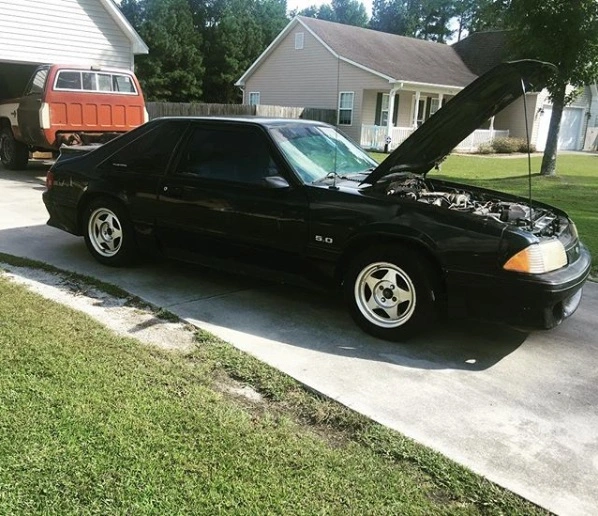

Looking for recommendations for my rotating assembly for my 89' HO 302. Just got back from the machine shop and it was bored .30 over. i am on a somewhat tight budget but i also dont want to cheap out. Willing to use same crank and i have a E cam that going to go in the car. Its a fairly stock car with the exception of 3.73 gears, exhaust and e cam. Really just looking for good .30 over pistons or piston and rod combos that will work well with stock crank. Thanks in advance.
