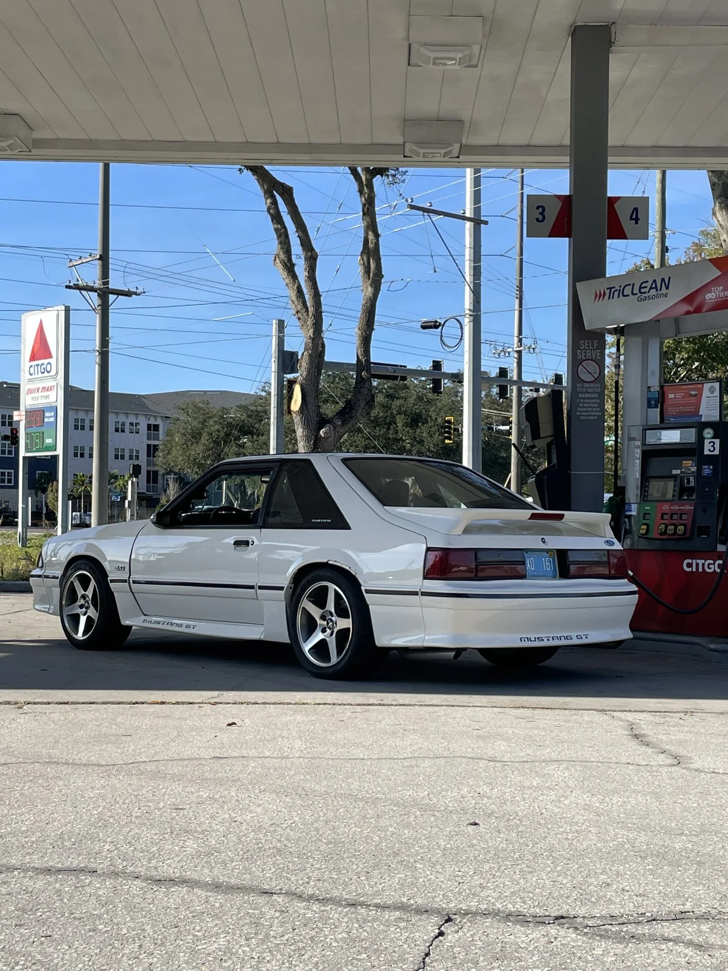

Gee this is one to make ya laugh fellas, had my wires one probe off on the distributor cap. Running strong! New issue while i was timing the car i seen lots of sparks around the #4 spark plug the wire is pushed on well its not touching anything what would cause the spark plug to arch to the head?
