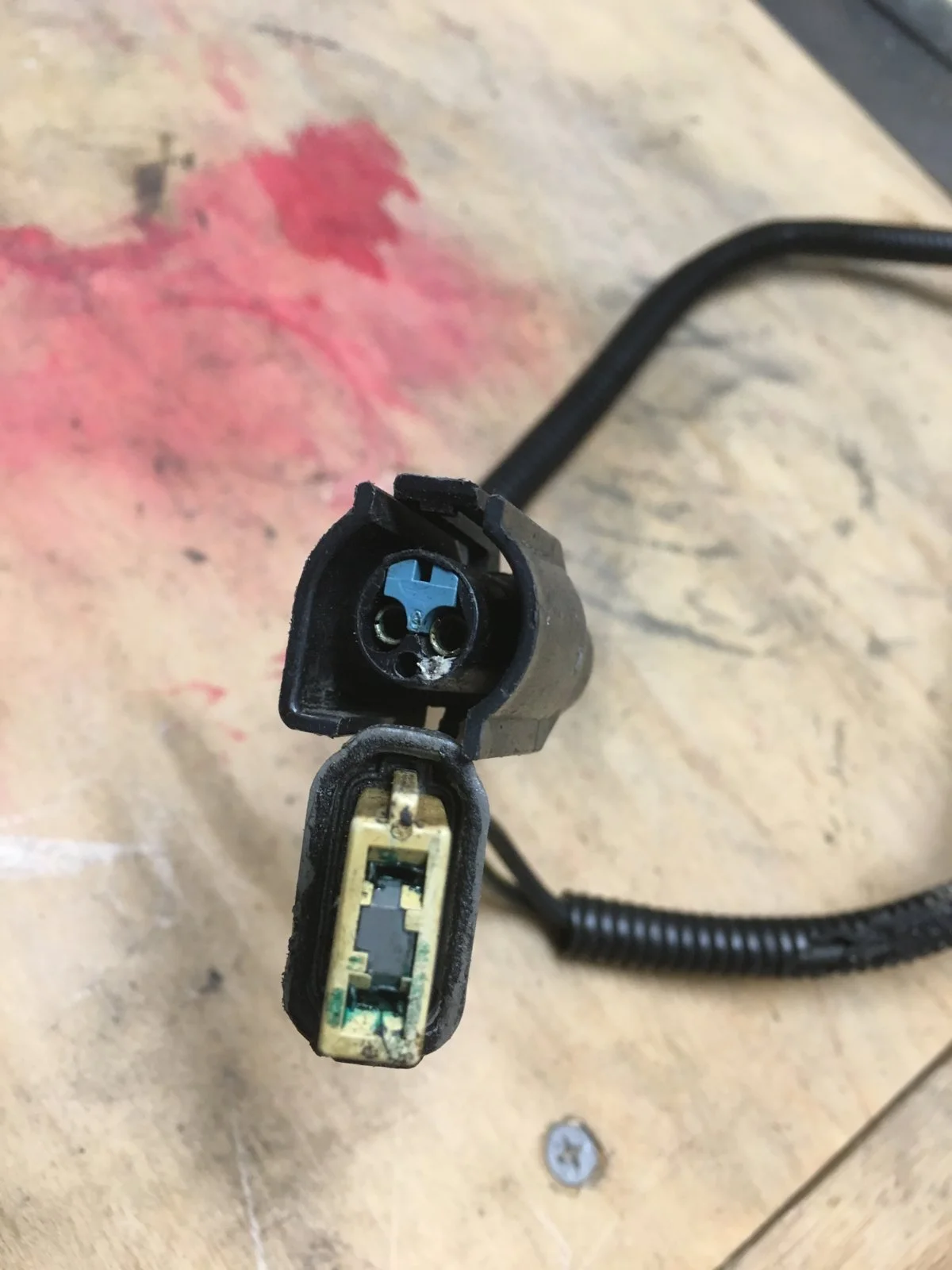

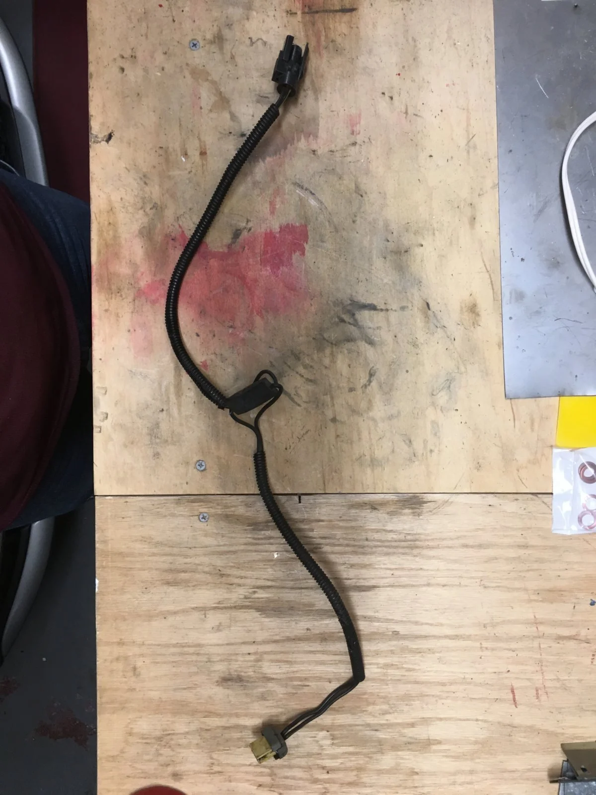

So I did a wire tuck when I restored the car and lost the ac harness to the compressor. Just purchased one from LMR and both the factory and the new connector are male connections. Am I missing a female female to go in between? Is the connector. Took a picture of not for the AC?

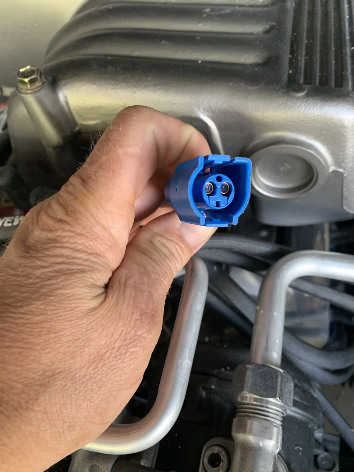

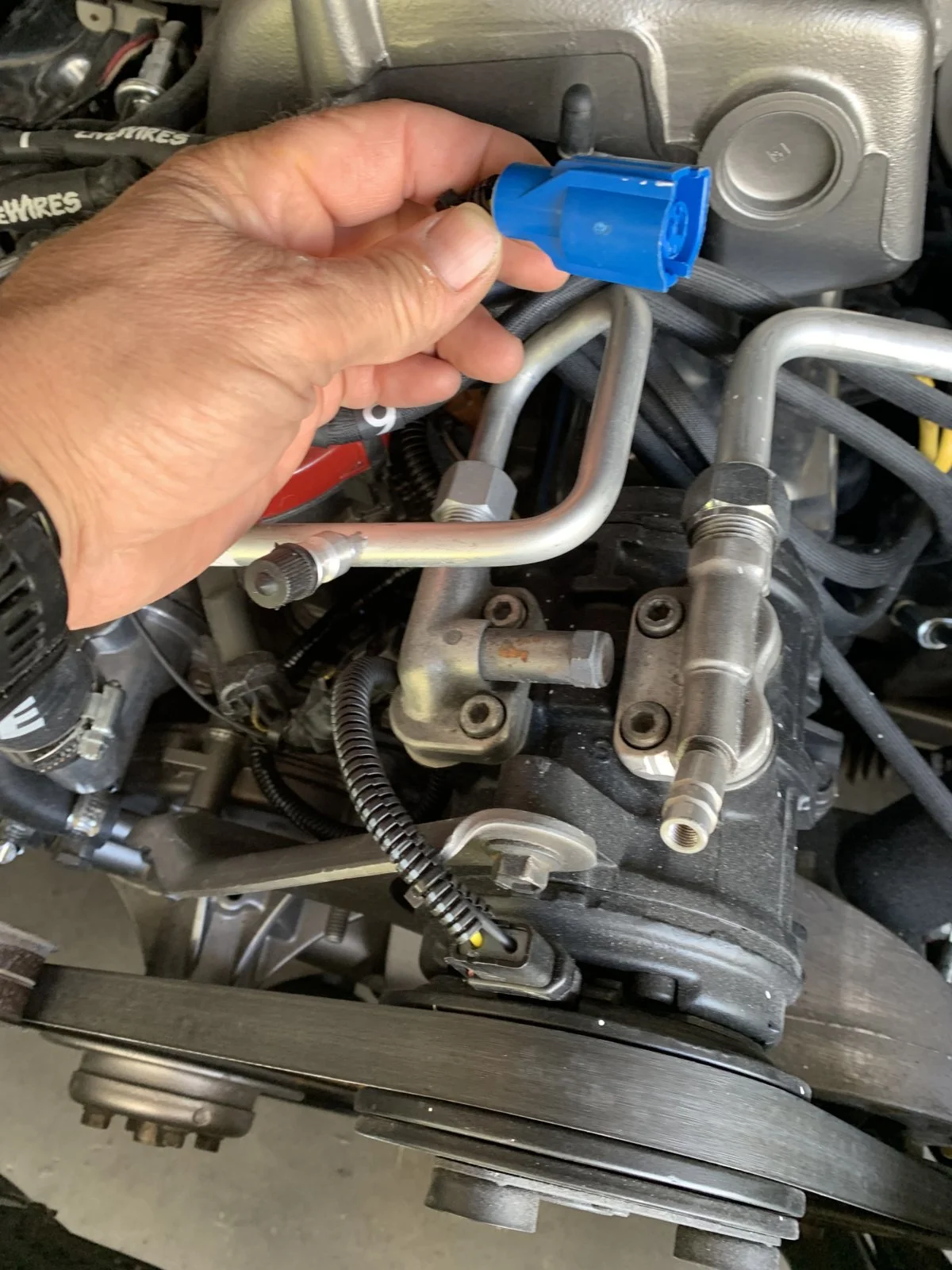

When I took mine apart to remove AC system it was one wire. No in-between plug. I don’t remember whether ends were male or female. I can get a pic when I get home from work tonight. (Mines an 86, but I think it should be the same)

That would be great. I’d love to know what color the engine harness wires are. I’m praying I didn’t tuck the wrong wires in the fenders.

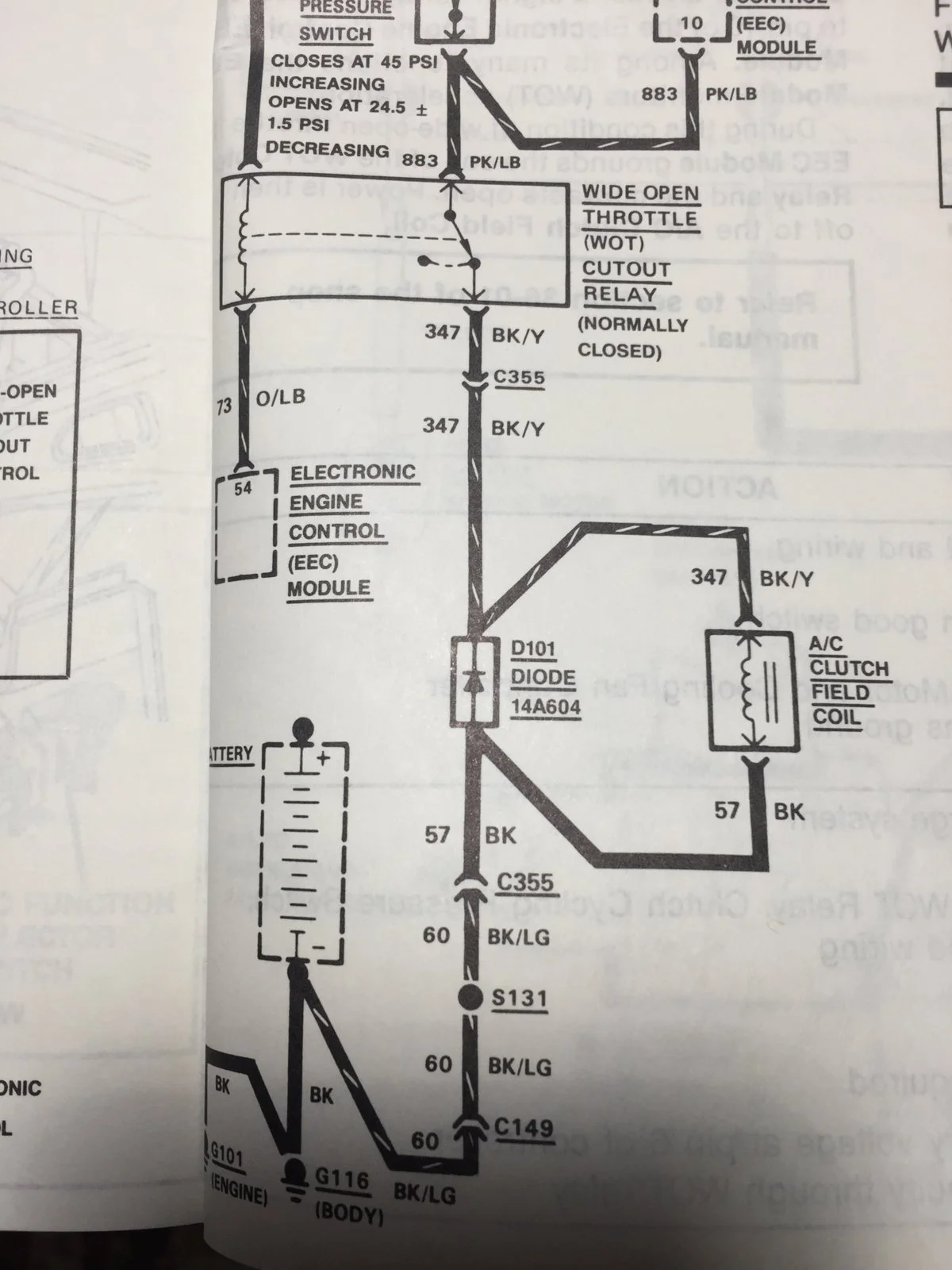

Thanks mustang5l5! Reading about that, now I may know why the engine is running rough. I’ll pick one up locally tonight or tomorrow. Now to find the right wires. What color are the wires on the correct connector?

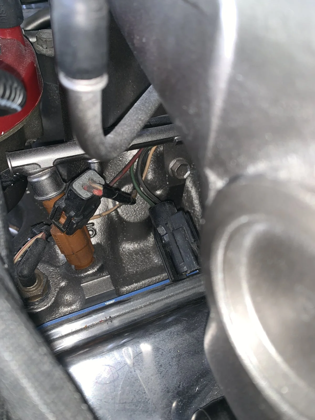

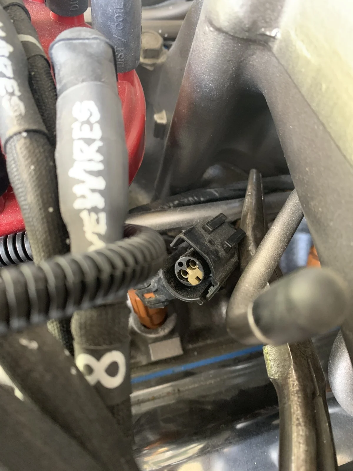

You should find the other end of the D shaped plug in the bundle of wires that resided under the starter solenoid down by the frame rail, you did the wire tuck thing so you will have to look for that bunch of wires wherever you 'tucked' it.

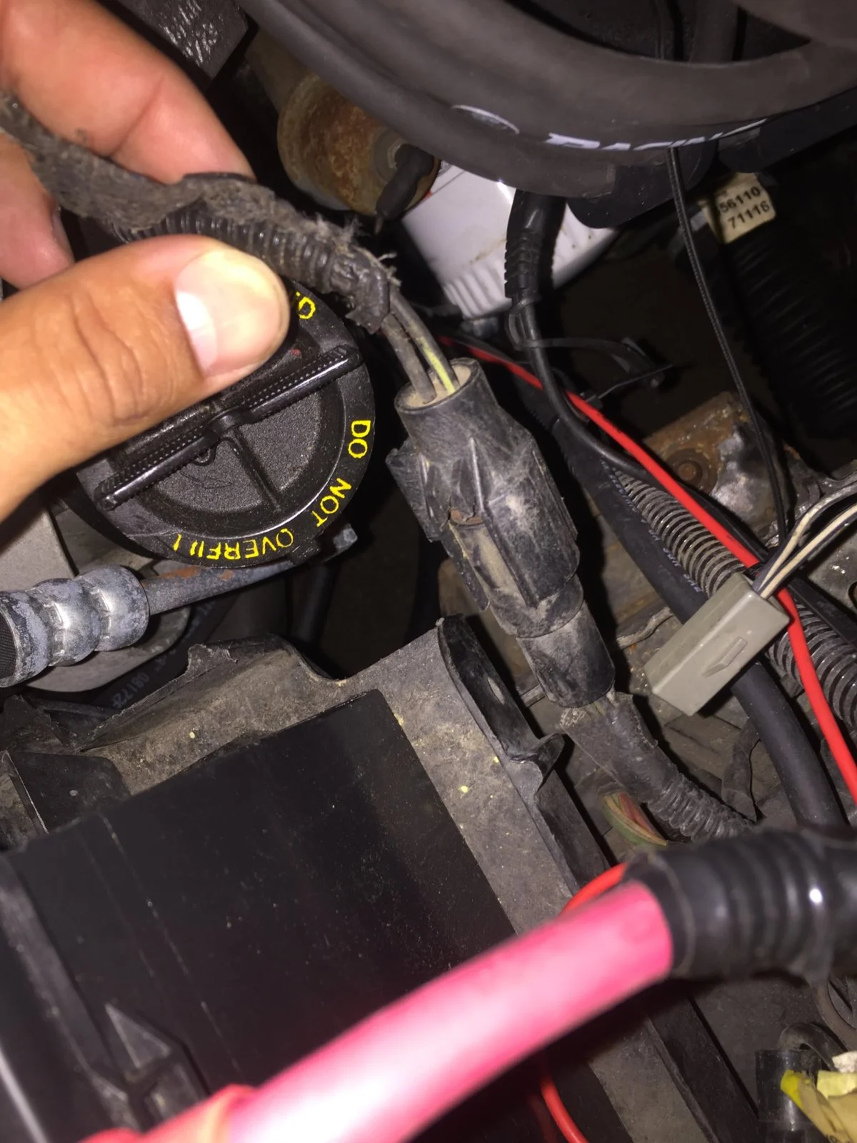

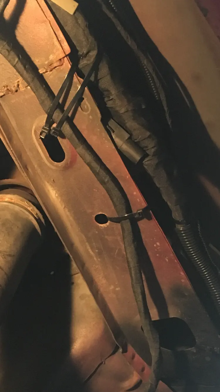

I dug through my wire tuck photos. Here’s where mine ended up. I left that plug accessible just in case I ever decide to put AC back in. But now you can see why you would need to extend the harness (if yours ended up in a similar spot).
I found it and extended the wires. Thanks again y’all.
