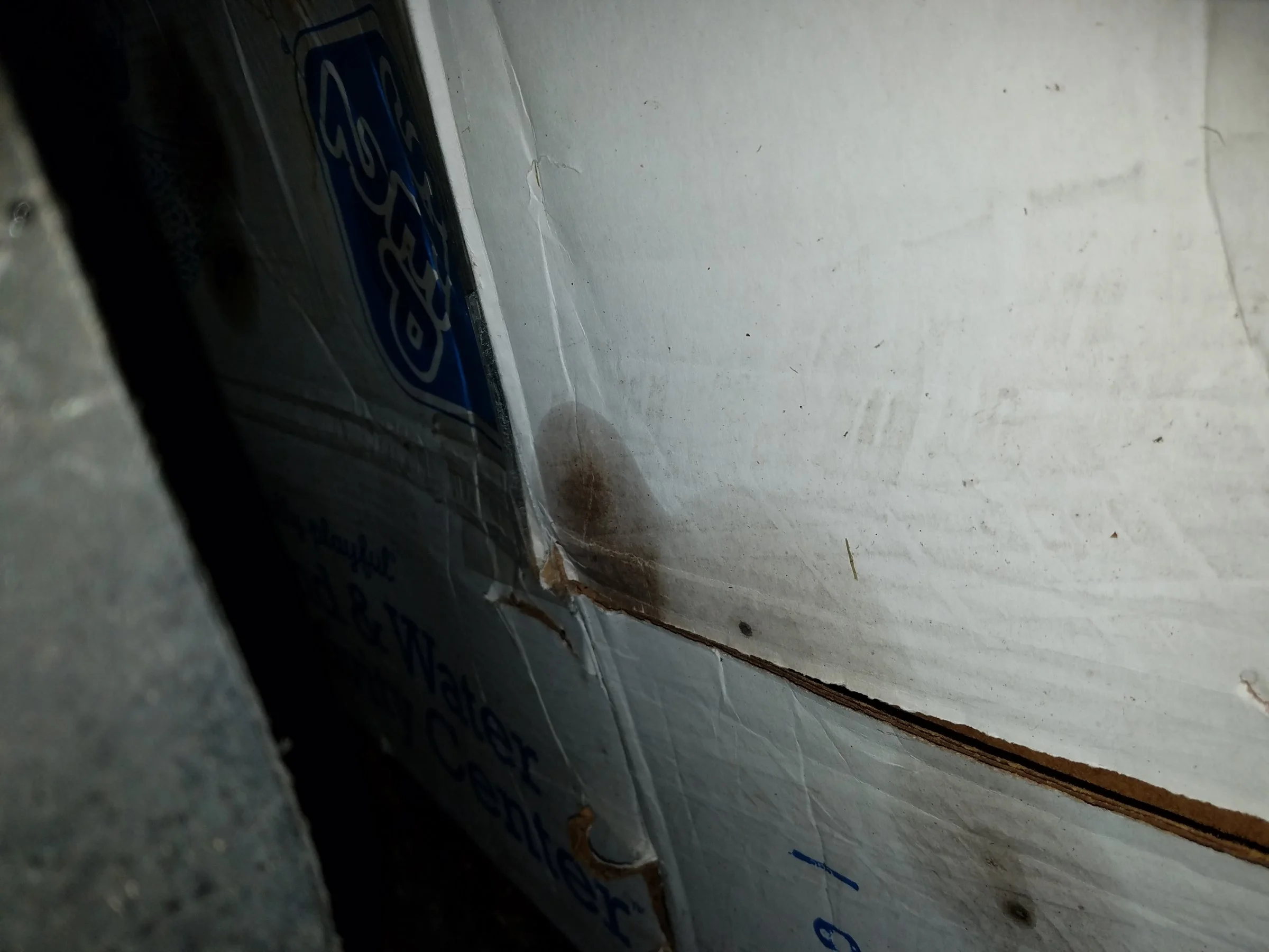

Hello,
I am getting some type to fluid leak which appears to be oil. It only seems to leak when the car has sat for a bit. I have piece of cardboard down on the floor and the leak looks like it is coming from the charcoal canister. I took a look at it and it looks all gunked up on the bottom. Is it possible for this to happen or could I have a leak from something else. The leak is on the passenger side of the car near the canister.
Thanks
Scott

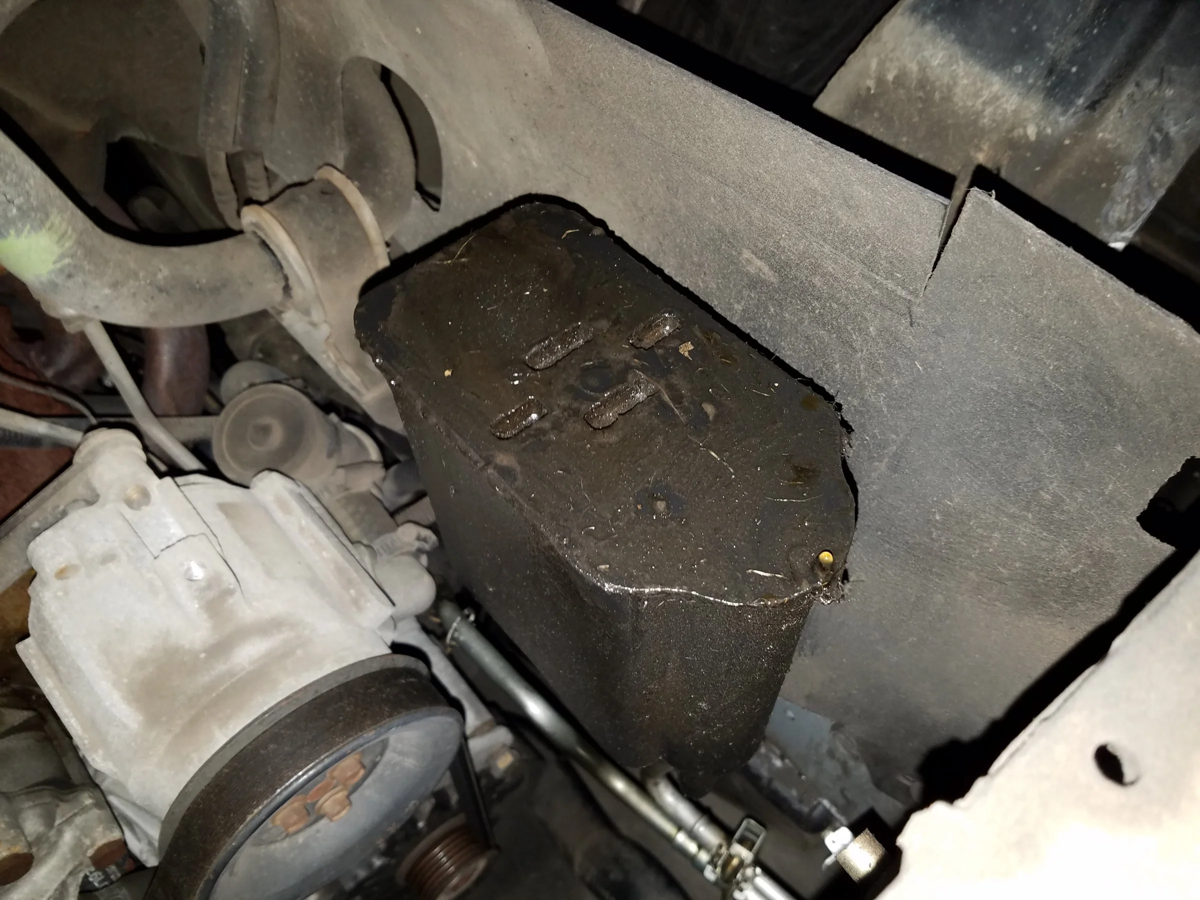

Salted roads are in full effect in NY so she's won't be going for a drive anytime soon but here are some pics!
How are the A/C lines directly above the canister? Are they leaking at all? Does your A/C work? It's possible oil from the system is leaking directly above the canister.
If it's not that, then yes, it does look like something is going on. Disconnect, the two vac lines and see if either is wet. I'd take the canister off and clean it and see if there is oil inside? Follow the vac line up to the intake manifold. Where does it connect?

Right above the charcoal canister is two ac line connections, that is the only source of oil in that area, that is why I think its refrigerant oil that has dripped onto the canister, the area around there is still clean from the pics. You likely need to change out the canister if the oil has seeped into it.
The ac lines run back to the firewall connecting to the evaporator and a dryer mounted to the firewall, you may be able to just replace the O rings at those 4 connections

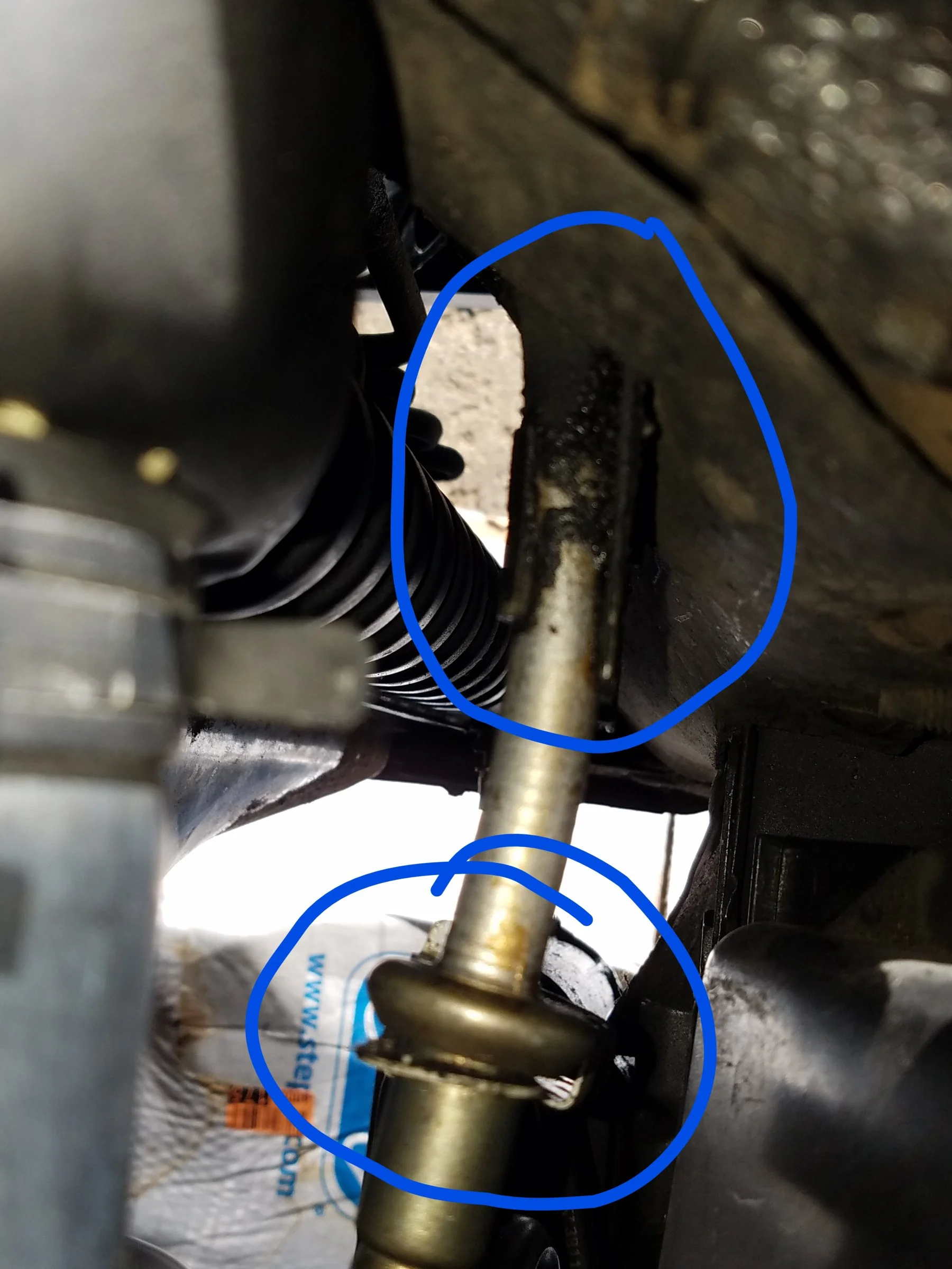

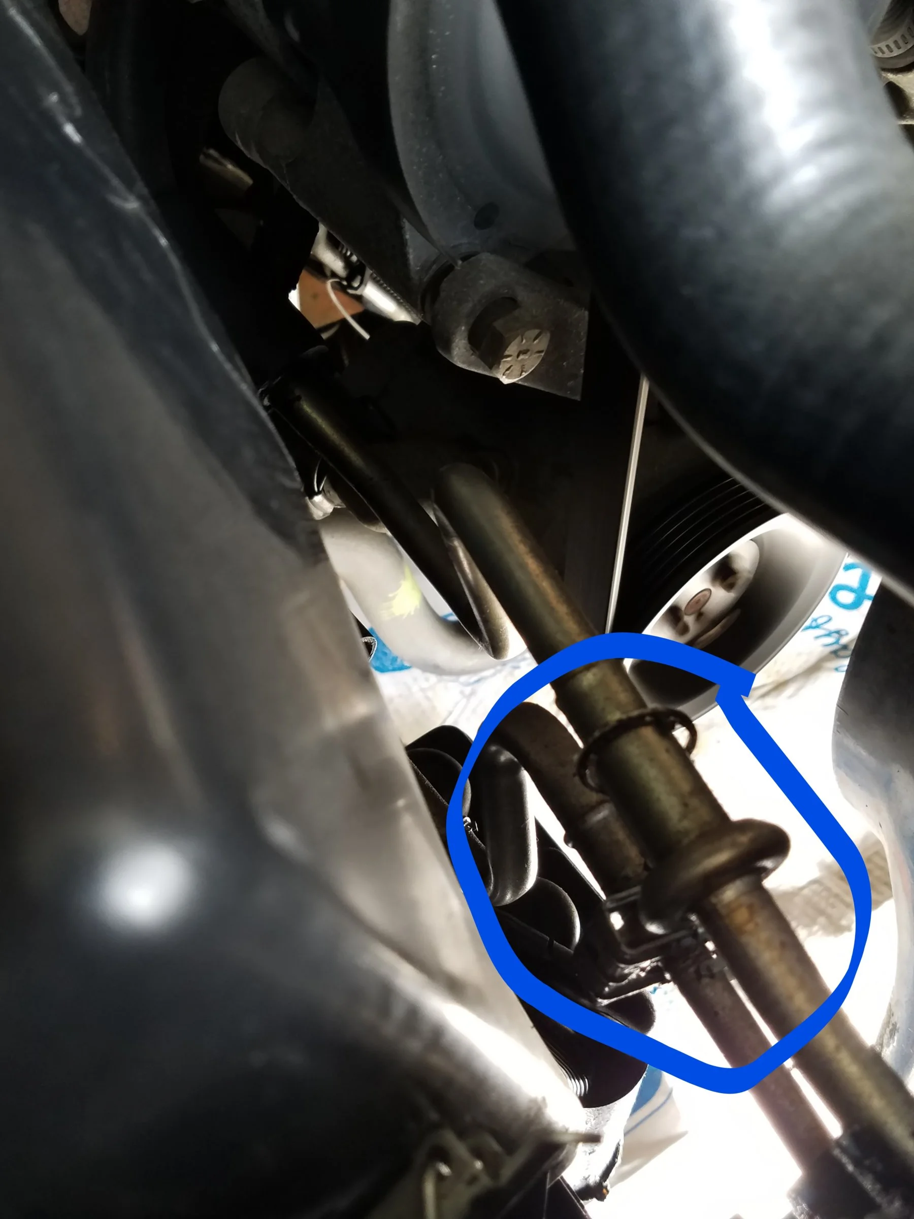

I let it run for about 5 minutes and turned the A/C on. No noticeable leaks. I had some condensation on the dryer (proper name?). There was some sludge on the A/C lines above the canister, but it was much closer to the radiator. I did notice 2 retaining clips that were not connected for the A/C lines. I'm not sure that it is an issue. And found a sticker that the A/C was converted over to R134a.

That's old paint. Those lines are painted black.
Get in there with simple green and warm water and rag and clean and degrease. Have you pulled the lines off the canister to see if they are dry?
