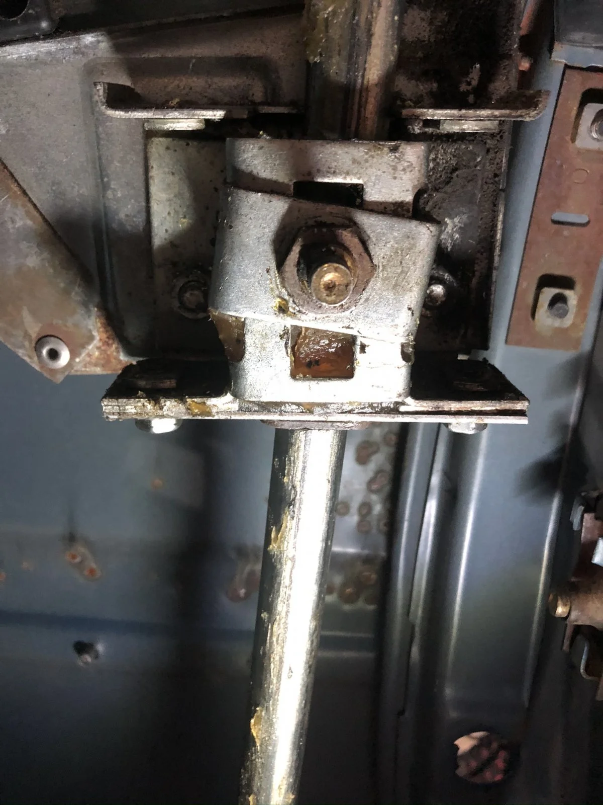

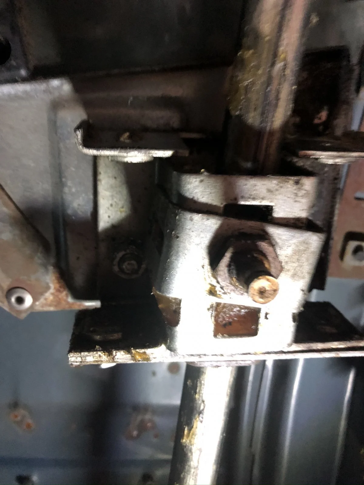

So my left quarter window stopped going up or down yet the motor functions. I decidid to take it apart and see. I bought LMRs quarter window kit with new motors, guide rod bushings and guide. It doesn’t appear broken though, but there’s a lot of play and it still won’t go up or down. Since I have it apart, I’m trying to do the LMR upgrade anyway and I know it’s a PITA.
But I cannot figure out how to get the window guide off the guide rod as they show in the LMR video. It appears there’s a part change from 89 to the 91 or whatever they’re working on in the video. But also something not right? I cannot get a wrench or socket on the bolts on the guideplate and it looks like something is not right with the part that allows some pivot to the window carrier.
Anything else I’m missing as to why the motor works but the window won’t move at all?

The LMR video is pretty good as an overview/how-to, but the car in their video is a 1990 or later when they changed the seatbelt mounts. My car is an 89 and it didn't have some of the pieces from the LMR video or they were different.
Some things I noticed/had issues with:
-The picture I've posted is of the pivot point for the regulator. It hooks on to the pictured brass pin with a c-clip. Have extra, small c-clips laying around when you do it. They will drop into the bottom of the car!
- Also in this picture, the part that is skewed is blocking the nuts to remove the window carrier from the guiderod assembly. I could not get a wrench or anything on those bolts to remove the whole carrier, so I had to unhook it from the bottom plate and replace the bushings that way. Did I mention this in an extremely tight and awkward space to work in? The problem is that those are the adjusting nuts, so it took a lot of messing around to get the window to move properly and it's still not right. But it's close, it goes up, which it didn't do previously.
