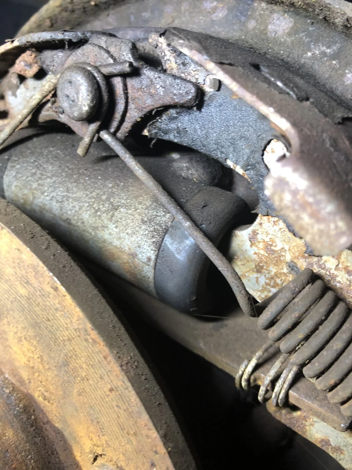

Stock drum brakes? Pull the drums off and verify no leak from the wheel cylinder inside.
If you are absolutely sure no leaks, id change the master cylinder.

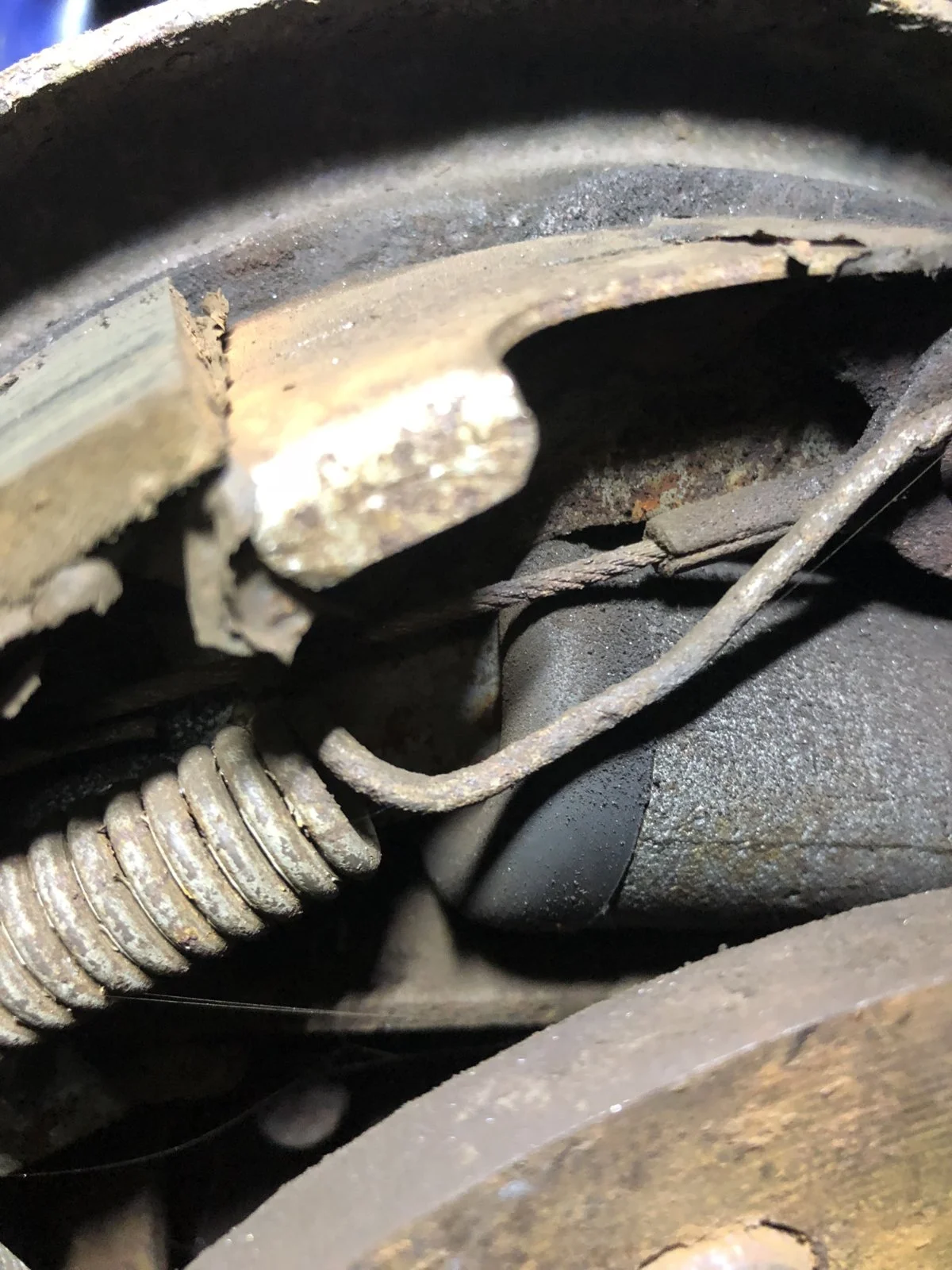

I checked passenger rear drum, looked clean.

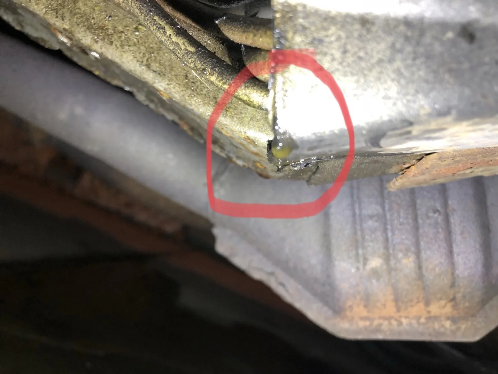

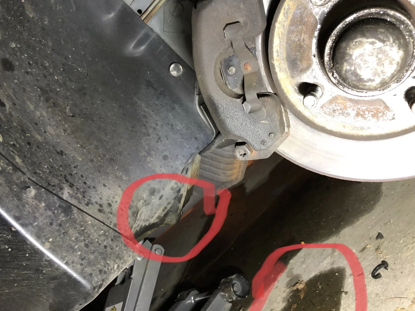

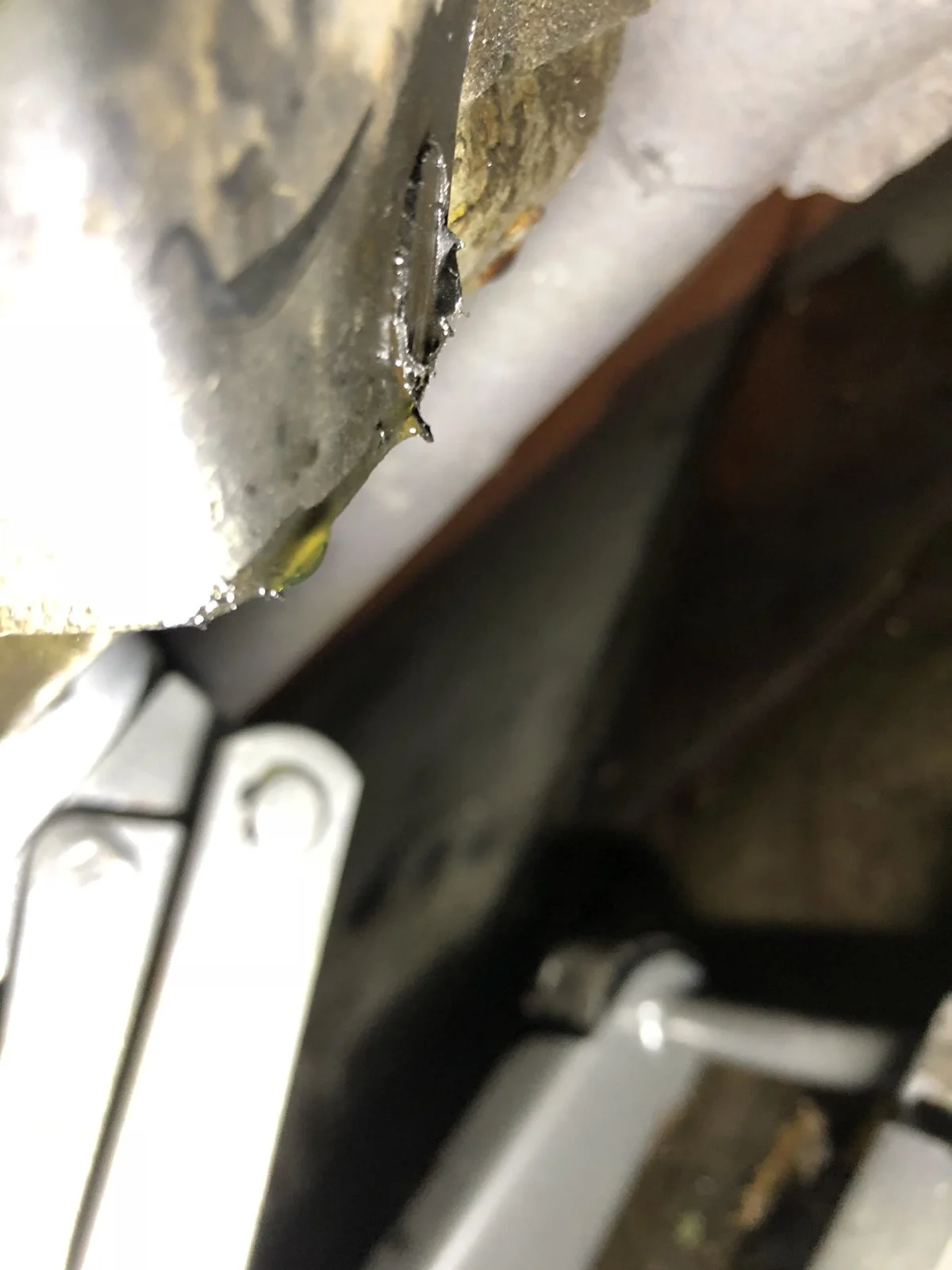

Followed brake lines up to passenger front. A little towards the front from where the fuel and brake lines come together I noticed a small stain on the floor. And some splashing behind the passenger front wheel well that wasn’t uniform with the drivers side. Where the subframe meets the plastic of the inner wheel well there is a drip of yellow fluid. There is quite a bit of yellowish fluid on the subframe as well.
I’m guessing there is a leak, somewhere behind the wheel well plastic. Ran out of time tonight, but I will follow up when I can get back in there and see what’s going on.

That would be where the single brake line to the rear brakes comes down from the firewall area.
I'd say you found your leak
