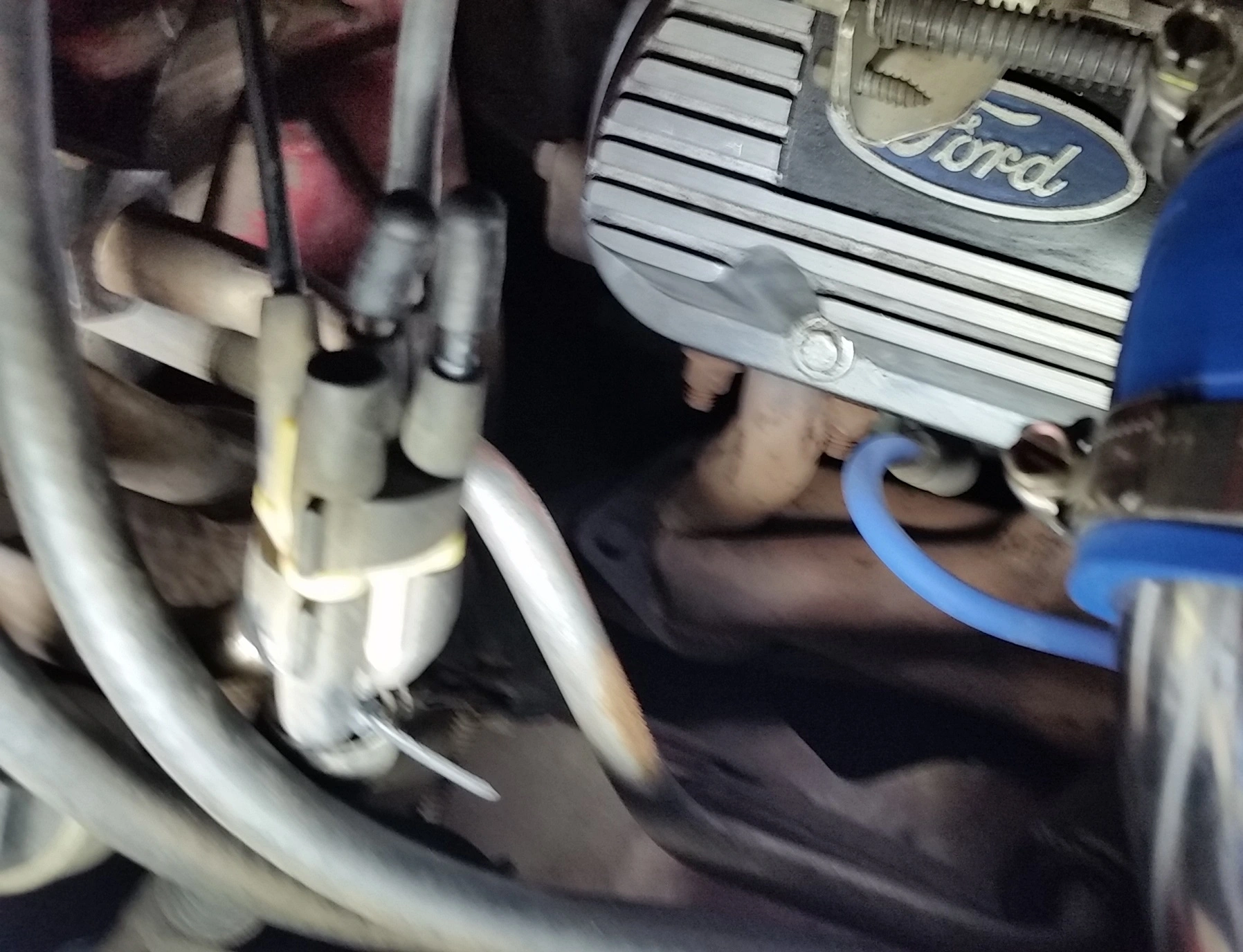

The passenger side vacuum harness or whatever it's called. 1 line goes to the intake the other to the vac tree on the driver side. Anyone know what the 2 capped ones might be? They feel to have little or no vacuum. The tree has great vacuum tho there is less than ideal in the system. About 15 lbs. So wondering if these 2 capped lines are a part of the problem. Looking at diagrams its hard for me to identify them. Thanks

That's great but someone must know what those 2 ports might be. I found a lot of that in my own searches. If I had a couple suggestions I can run them down. I'm not gonna become a certified auto tech just so I can get 3-4 units of vacuum.

Is your smog system present? Air pump and related plumbing? What about the EGR?
Not the best picture to try to iD the lines from, but that particular "tree" feeds various things like the HVAC vac source, the TAB/TAD solenoids and the EGR regulator.
Too blurry/close up to identify what goes where. There's a check valve and vac canister associated with that plumbing, as you prob wouldn't have a lot of vac at idle. I doubt it's a contributor to your vacuum level though
I deleted the smog pump when I did the heads, cam and intake. EGR is there. I figured that tree would be the same for all so thought I just needed to establish with a pic what I was talking about. We've all seen them but without a pic you get all kinds of crazy answers.
The 2 capped lines appear to go into the fender. They have always been capped so I didn't think they were likely a part of the problem. Just asking so if I could identify them I could eliminate them. My car is near mint and always garaged and never driven in winter, myself and previous owner. Underside is totally clean. So it wouldn't be a rotting vac can or some such. I have recently become familiar with HVAC vac source, the TAB/TAD solenoids so will check those. Thanks!

Let me take a peek at my car. All that is intact. Give me an hour
Edit: ok I lied, I changed it up slightly when some lines broke, sonits not configured the stock way now
