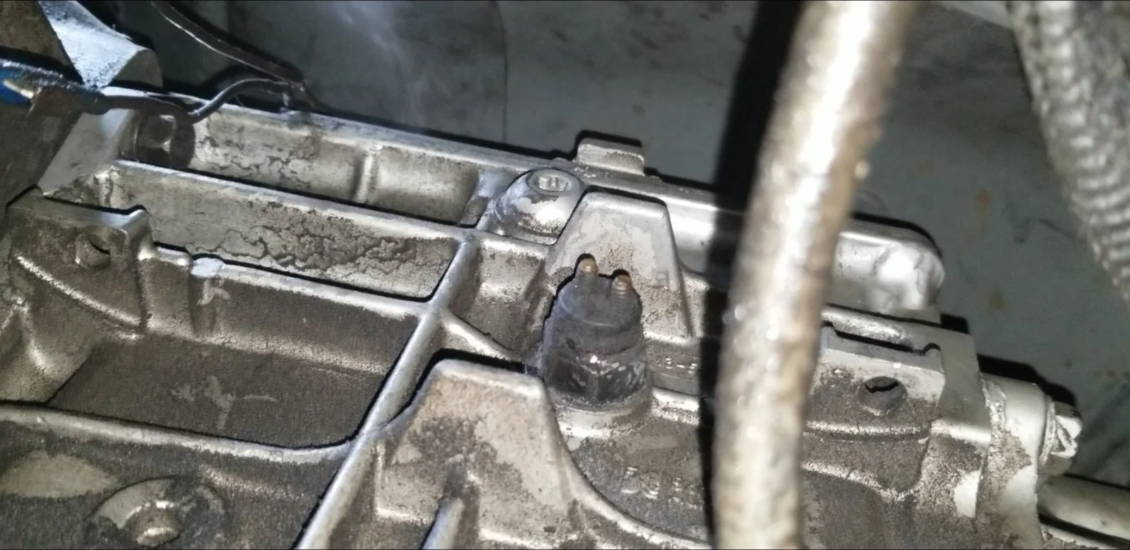

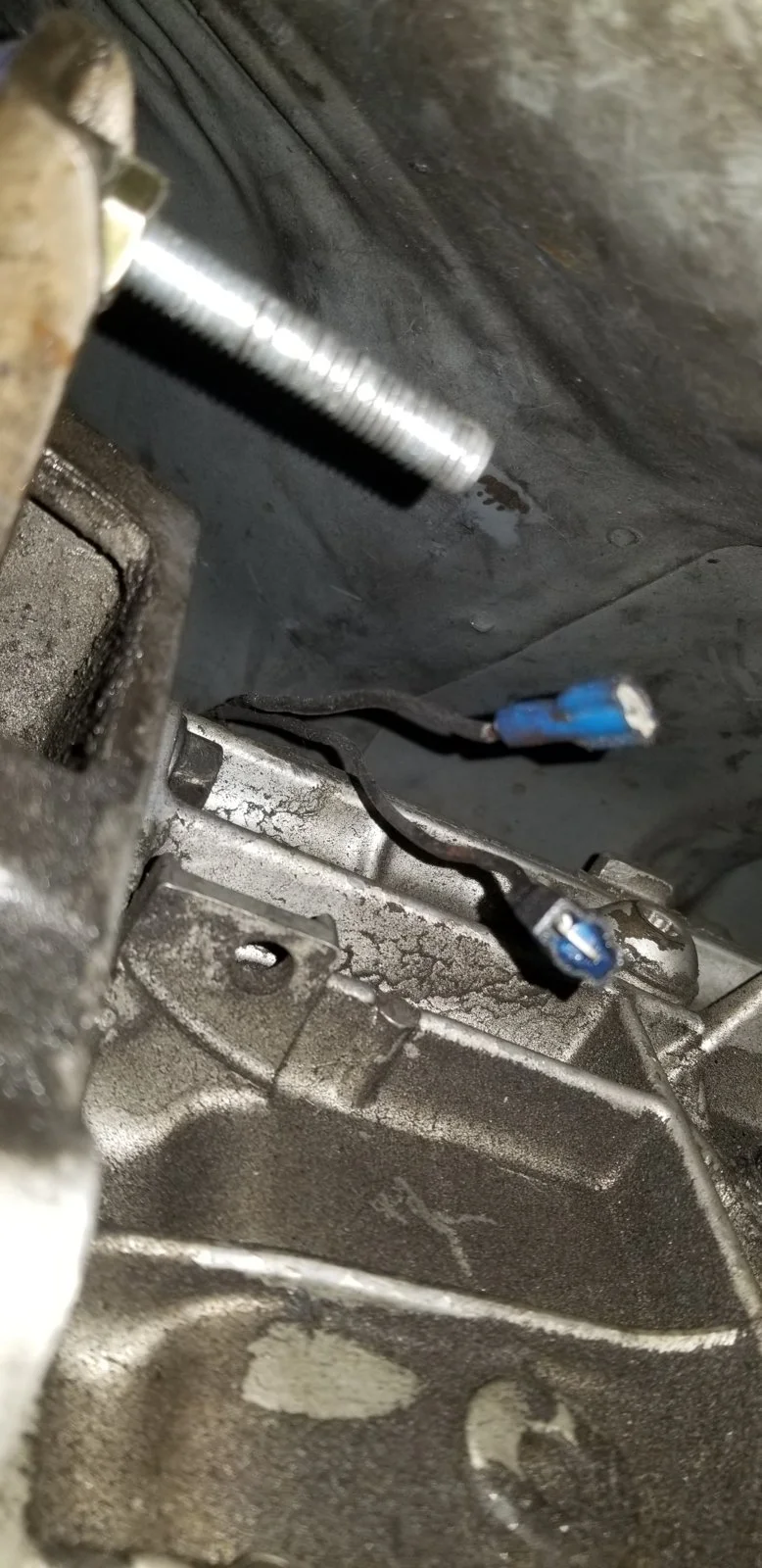

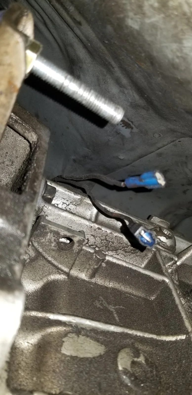

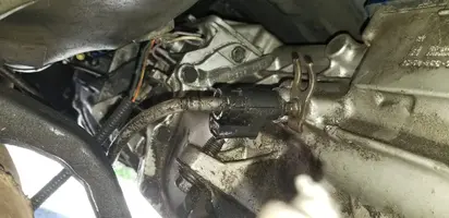

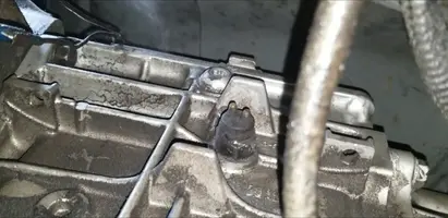

Question my car does not have speed sensor electrical hooked up right now wires are cut.also wires from I think neutral safety are hanging down not hooked up.my question my car seems to run fine without being hooked up should I hook them up or is it ok to leave it.also o2 sensors in rear are not hooked up and dont see any where for it to plug up. I do have some wires coming from inside care down through floor right by speed sensor but wired are cut.i got a new sensore and new electrical plug

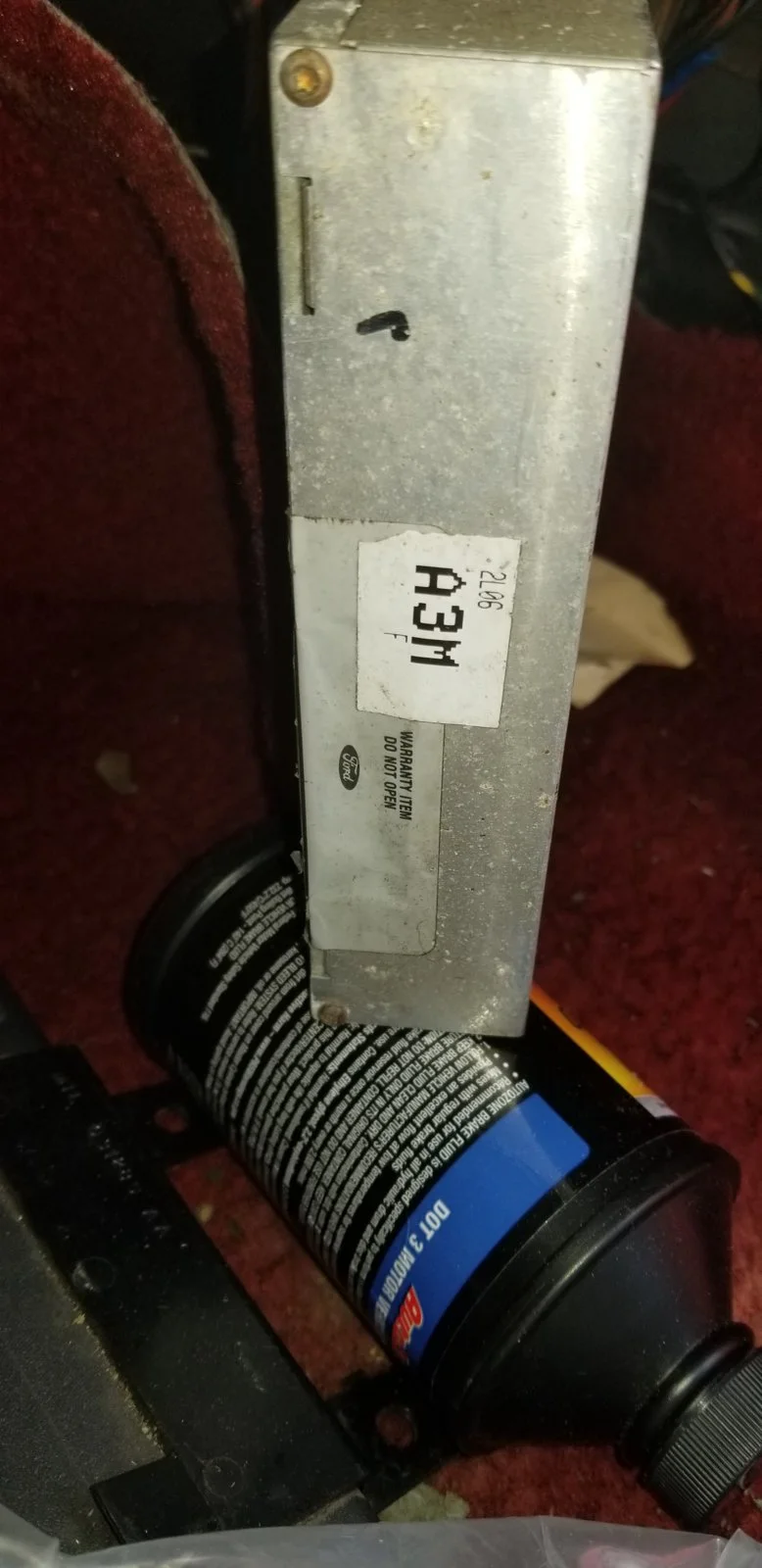

That looks like the car was AOD and swapped to T5. Might want to check what computer is in it before you hook up the wires or o2 sensors. The computer is behind the passenger kick panel. Take a pic of the label on it and we can let you know what you have.

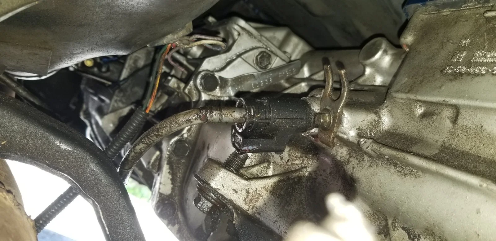

The sensor/electrical connector in pic 2 is for the cruise control. Looks like the hold down bracket for the speedo cable is not sitting right as well.
That's a 92 to 93 5 speed computer. It'll work. The o2 sensor harness should run down from the passenger side down by the fuel lines, across above rack and pinion. There should be a connector by the sway bar mount on the passenger side....two more connectors towards back of k member ( 1 each side ).
That connector is for cruise control at the transmission. I don't think the computer uses it to see speed. ( can't remember ).
That two pronged sensor is the reverse switch. Without that the reverse lights won't work. Those two black wire might be tapped into the reverse light circuit.
That " U " shaped bracket is supposed to be on that black piece at the end of the cable. The wires for the speed sensor and the reverse switch come through a grommet in the trans tunnel. Exactly where those wires are cut.

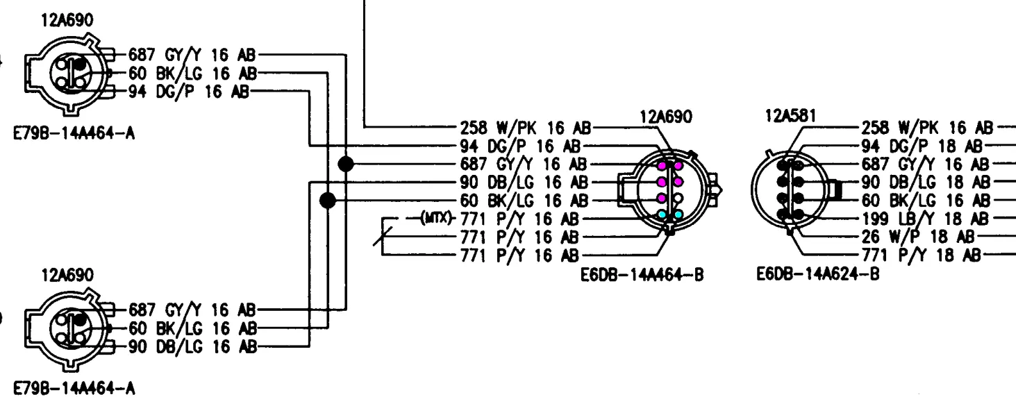

- IF PIN 46 HAS VOLTAGE: Find the O2 harness connection into the main harness. The stock location for this is passenger side frame rail, under the mass air meter. If you're completely lost, trace from the O2 sensors or the low oil sensor on the driver side of the oil pan. At this connection, you'll see a pigtail - it's an 8 pin connector, 7 are used (two for each O2 Sensor, 2 are 'looped', 1 for the low oil and 1 empty/unused). The answer for you is in the 1 unused and two looped pins - See the attached picture for how the 'loop' should be pinned FOR A T5 1989 MODEL YEAR W/ A MANUAL ECM (The two TEAL pins should be looped, Purple are untouched, the single white/empty pin is the unused one)

4. A 4 pin connector with [Red/Light Blue], [Purple/Orange] and [Black/Pink] wire - this is the reverse plug. There's actually a pigtail you'll need between the T5 harness and the connector on the side of the trans (your 5th picture shows the reverse sensor in the trans). On T5 models, the [Red/Light Blue] wire is looped, and the other two wires are for the taillights.
