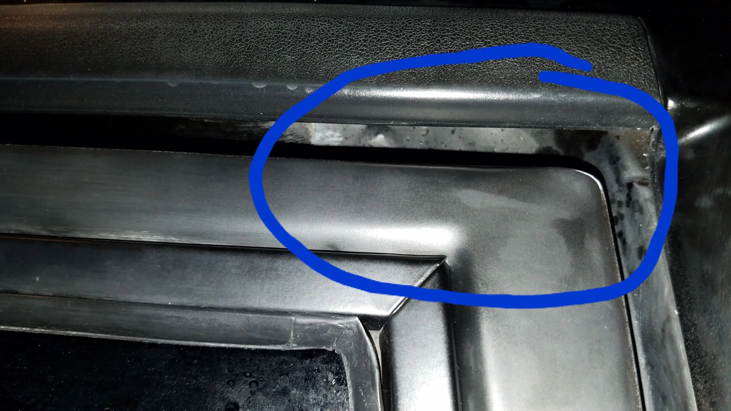

Hello,
I've had my car for a year now and always had a slight leak from the drivers door when getting my car washed. I assumed it was just the weatherstripping needed to be replaced.
Upon further inspection, there is a gap on my driver door between the top of the door to the A pillar. When the door is closed, the top of the door only covers about half of the weatherstripping which is preventing the door from getting a full seal. The door molding lines up with the fender molding. No accidents reported by previous owner.
I did the sag test and everything appears tight and solid. I don't seem to get any play as the door moves with the entire car if I lift it up and down. The passenger side doesn't have this issue. What options do I have to fix this?
If I adjust the hinges, it will throw off the molding alignment. I will post pictures shortly.
Thanks
Scott

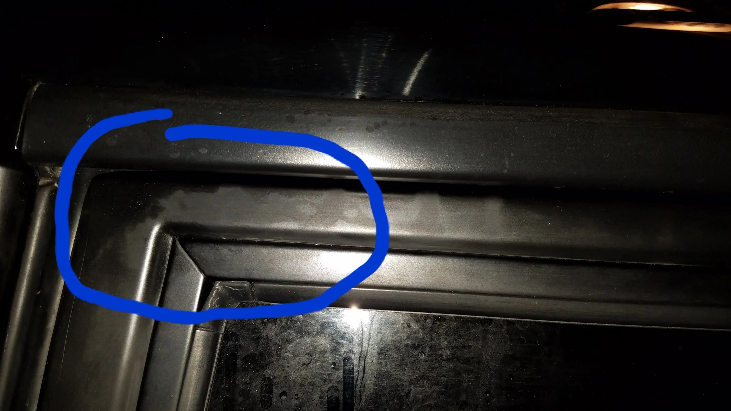

I'm confused on how adjusting the window will fix the gap. Pics attached are of the driver and passenger door gaps

Your talking door gap, sorry. I have two t-tops. My doors don't have window frames.
That is a small adjustment to be made. Would you mind showing a picture of the whole door please?
Well I adjusted the door striker and moved it up. Door to quarter panel lines match up better and closed the gap to the top of the pillar. Now hopefully it will fix the leak! Thanks everyone
