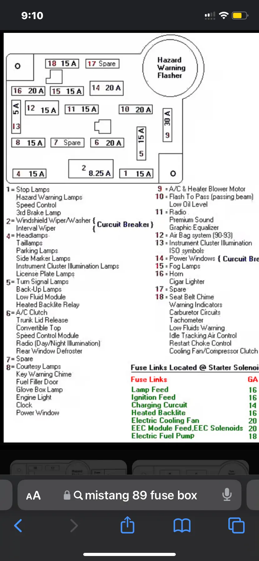

Just wondering what could be blowing out this fuse? It shows stopping lamps,hazard lights,3rd brake lamp & speed control? What is the speed control guys?

Ahhhh but dam i haven’t messed with that.Think the Speedo sensor have anything to do with that? Can a bad hazard light switch itself cause this?I can use turn signal but they won’t work if I have hazard switch on and that’s with a blown #1 fuse .If I turn the switch off then the turn signals work. Also I did recently remove steering wheel i have a momo I dont have the horn hooked up think it could be the wires in there touching metal can cause this?
I would immediately check the horn wire that you did not hook up.
When the hazards are on I don’t believe the turn signals will work so regardless of the fuse being blown that seems normal.
