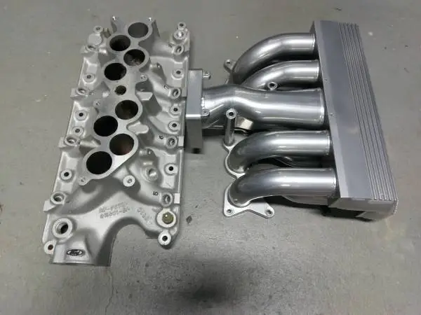

Cam, heads, GT40 tubular intake manifold, throttle body

Explorer intake with ported lower
