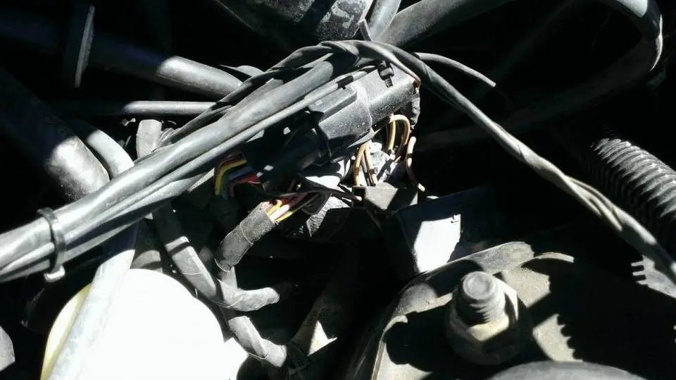

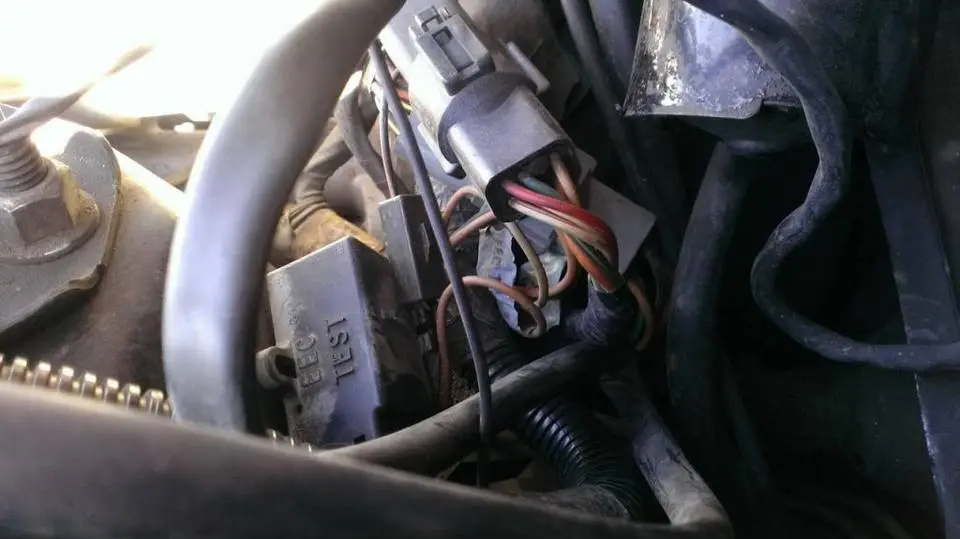

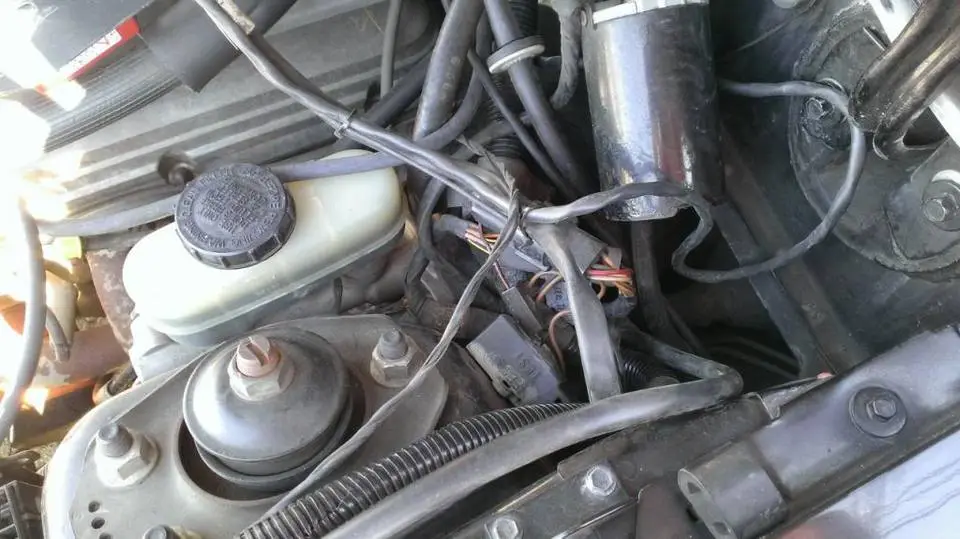

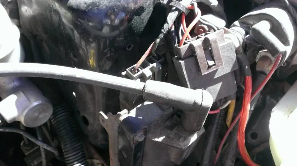

Electrical 89gt - Can't Find Diagnostic Test Connection
Yep, thanks! I didn't realize that was a cover for the test terminals. They were perfectly seated and looks as though they have never been touched.
I have lots of codes to go over...
