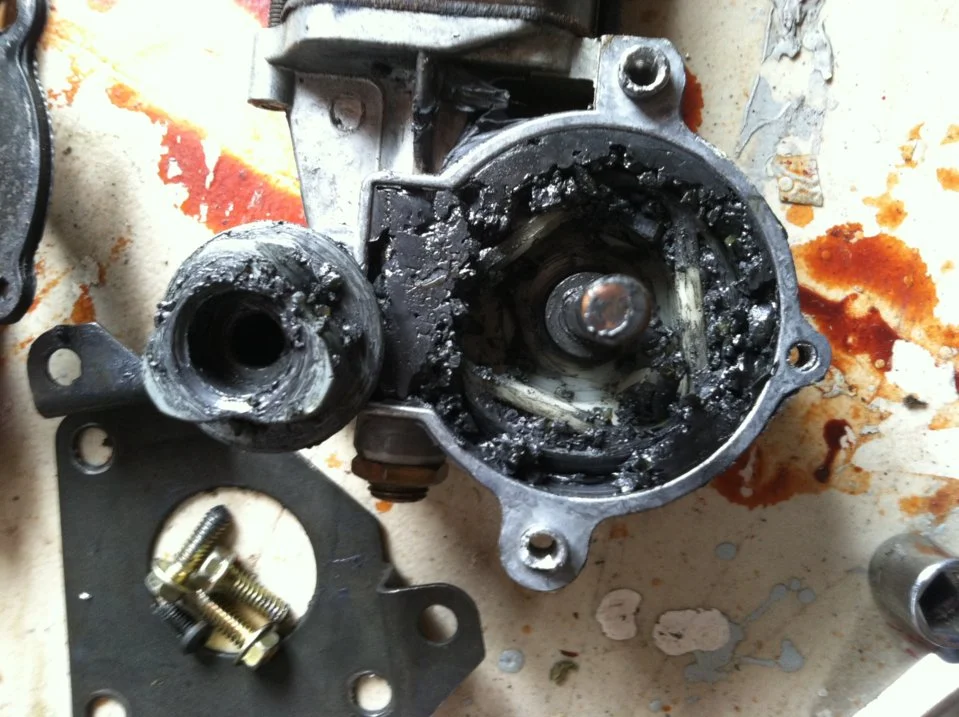

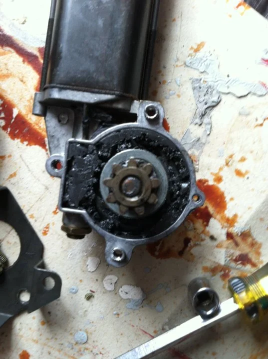

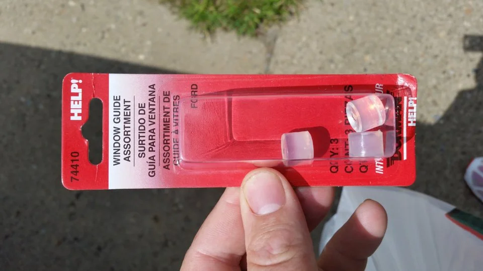

I just had a similar problem, 89 Vert LX 5.0 & my drivers side rear 1/4 window wouldn't go up or down, & I knew that the motor was working. I read on a Mustang forum that indicated that the problem cud be an easy fix, & a common problem. Sure enough the plastic bushings were in pieces. I went to Auto Zone & didn't ask for help, & I found the part: Window Guide Assortment. Let me know if you have any questions.

3 small bushings, they disintegrate over time, they're one dollar help parts at the parts store. they fit in the corners of the white triangle
or what Mike said too
Thanks guys. It's actually not the motor that's busted, it's the regulator assembly that gets stuck. When I take the motor off the plate, it spins perfectly fine. When I connect it to the regulator, it no longer turns, even without being connected to the actual window. This is the problem I'm having.
I guess the motor could be jamming under load. I'm not sure if the motor is the fault or the actual assembly that pushes the window up and down is too jammed to operate smoothly. Maybe I'll replace those bushings and be 100% sure it's not the motor and see if that fixes it. Thanks
