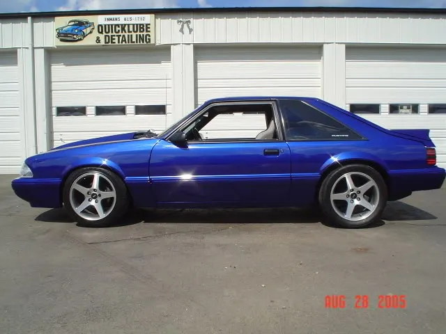

i've got 17X9 03 cobra's on the front of mine w/a 245/45 tire. only rubs at full lock and my car is lowered pretty good in the front too:
