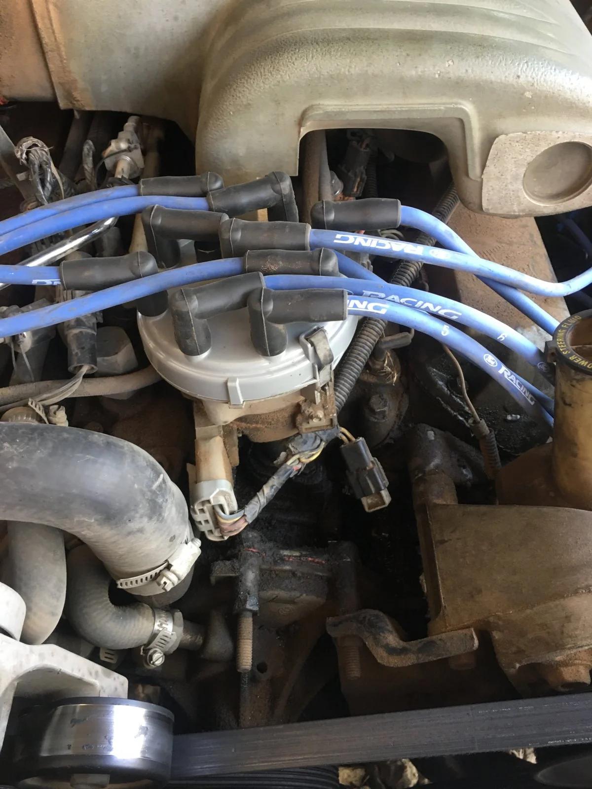

I just bought a 1990 lx 5.0 and noticed that the Distributer looked as if it had to much timing. I pulled out the timing light and it was set at 12 BtC and the car ran fine.
What could be causing this? The plug wires were stretched and the TFI module is almost touching the radiator hose

Yeah that looks off, strange.
It just means someone stabbed the distributor in on the wrong spot.
In theory, of the intake wasn't in the way, you could just stab the distributor wherever you want and rotate the housing 360 degrees to wherever you can time it.
If you are at 12 degrees, you are 12 degrees. If it bugs you, Mark where the rotor points, lift the dist up and move it counterclockwise one tooth and then realign the housing. Then check timing again.
Makes perfect sense. I’ll reinstall distributer
