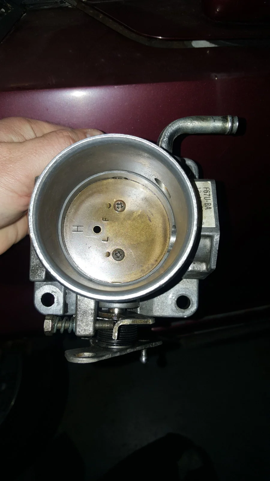

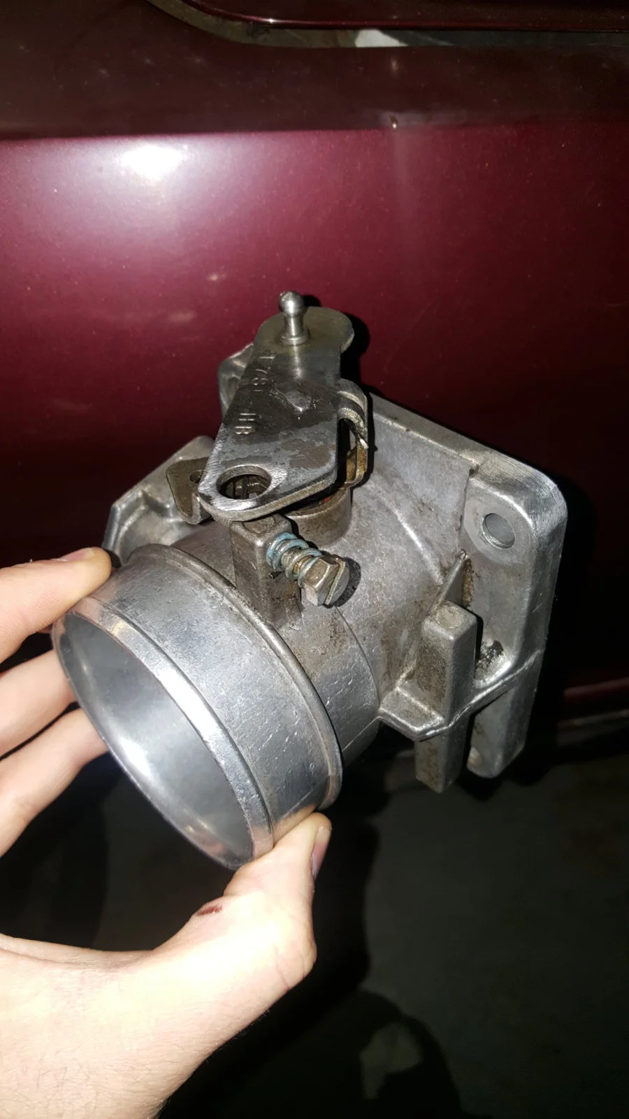

I am planning on doing the explorer TB swap (already have the TB and explorer intake, and eventually gt40 heads. Already did the sn95 maf swap.) but It struck me while thinking sitting on the toilet (where my best ideas come from) is there enough materal in the neck of the stock TB spacer to have my buddy with the metal lathe waller out the opening to 70mm (measuring 68.6 actually)? I love to reuse parts, hot rod style, but figured someone tried this at some point before CNC billet ebay spacers. Is there any real (not like sticker power) performance differences in the coolant vs solid TB spacers anyway?

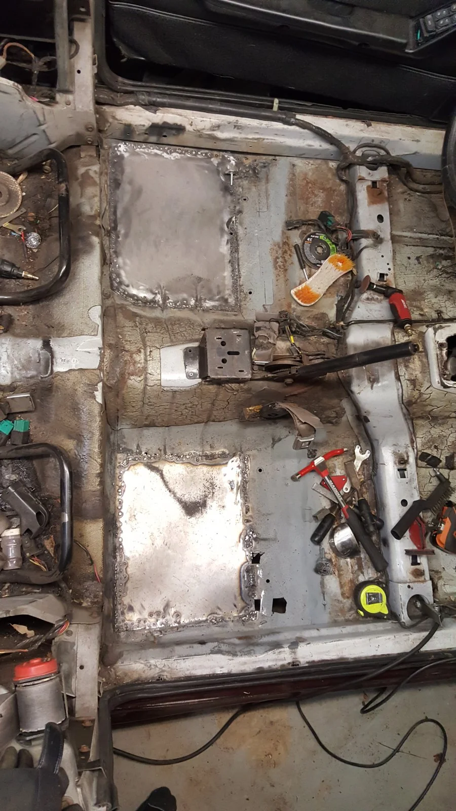

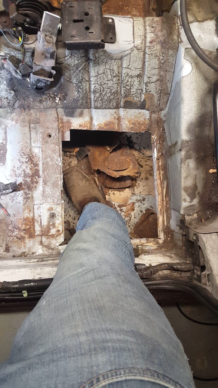

FYI I pick up my sheet metal for the floor pans today and will be beating them into shape this weekend. Excited to use my new hammer and dolly set.
Not too bad for a weekend of work, still need to grind down some welds, and put on some seam sealer. Going to patch that seat mount hole on the passenger side with some heavier gauge material. They held my fat butt up so I feel good about the strength. I found that the cheap flux core from HF actually worked better for the thin sheet than the nicer Lincoln wire. Probably just a little colder, which in this situation, was good.​

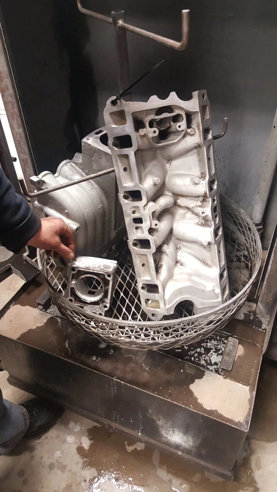

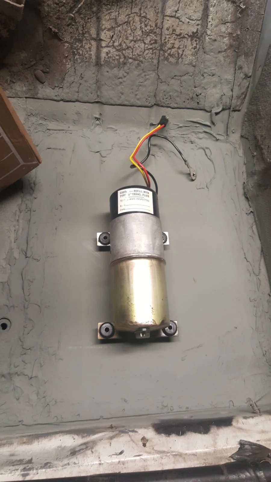

Welp, had a super productive weekend on the car. With help got the electric motor for my top rebuild and tested, hope to install this week. Got my explore intake disassembled and in the parts washer, got my factory fox throttle body spacer bored and honed to accept my explorer throttle body swap that I performed on Friday.

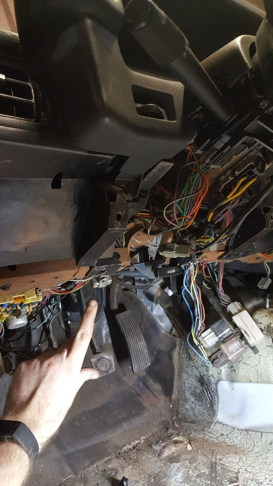

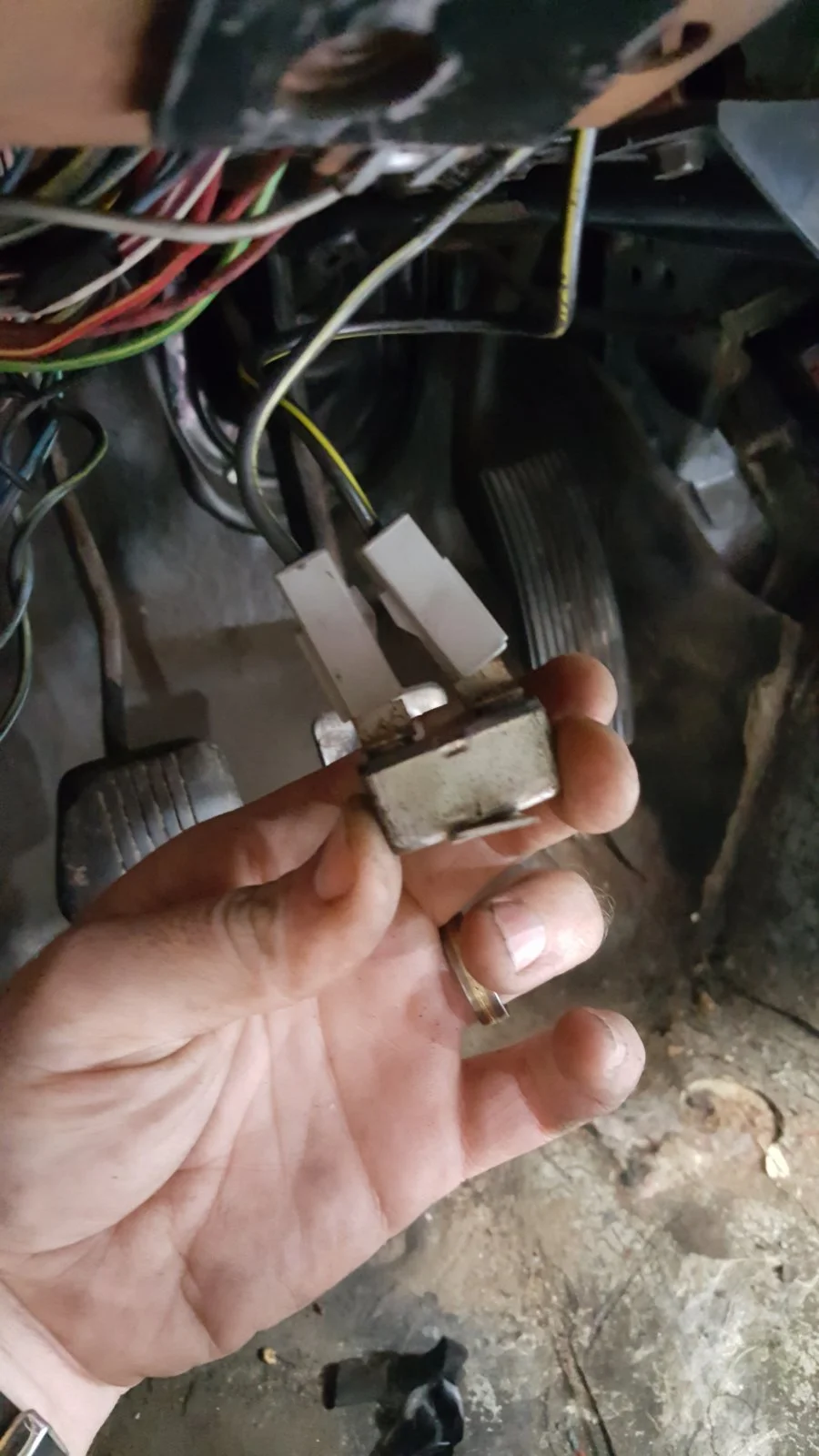

The guy who does not know chit is actually going to contribute to the community! In troubleshooting my freshly rebuilt top motor I was running into an issue that the internet has not yet successfully documented in pictures. At least I could not find it.
My new top motor relays were clicking but not spinning the motor. Relays were good but I tracked down that there was a circuit breaker I needed to find under the dash somewhere. For reasons, the guy that previously molested my car had unplugged the breaker. Anyway here are pictures of the breaker location and the black and yellow wires. My top now movin' under power!
